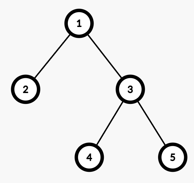

输入: edges = [[1,2],[1,3],[3,4],[3,5]], queries = [[1,4],[3,4],[2,5]]。
输出: [2,1,4]。
解释:
查询 [1,4]:路径为两条边(1 → 3 和 3 → 4),(1,2) 或 (2,1) 的组合会使代价为奇数,共 2 种。
查询 [3,4]:路径为一条边(3 → 4),仅权重为 1 时代价为奇数,共 1 种。
查询 [2,5]:路径为三条边(2 → 1 → 3 → 5),组合 (1,2,2)、(2,1,2)、(2,2,1)、(1,1,1) 均为奇数代价,共 4 种。

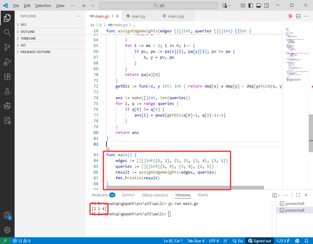

Go完整代码如下:
package main
import (
	"fmt"
	"math/bits"
const mod = 1_000_000_007
var pow2 = [1e5]int{1}
func init() {
	// 预处理 2 的幂
	for i := 1; i < len(pow2); i++ {
		pow2[i] = pow2[i-1] * 2 % mod
func assignEdgeWeights(edges [][]int, queries [][]int) []int {
	n := len(edges) + 1
	g := make([][]int, n)
	for _, e := range edges {
		x, y := e[0]-1, e[1]-1
		g[x] = append(g[x], y)
		g[y] = append(g[y], x)
	const mx = 17
	pa := make([][mx]int, n)
	dep := make([]int, n)
	var dfs func(int, int)
	dfs = func(x, p int) {
		pa[x][0] = p
		for _, y := range g[x] {
			if y != p {
				dep[y] = dep[x] + 1
				dfs(y, x)
	dfs(0, -1)
	for i := range mx - 1 {
		for x := range pa {
			if p := pa[x][i]; p != -1 {
				pa[x][i+1] = pa[p][i]
			} else {
				pa[x][i+1] = -1
	uptoDep := func(x, d int) int {
		for k := uint(dep[x] - d); k > 0; k &= k - 1 {
			x = pa[x][bits.TrailingZeros(k)]
		return x
	getLCA := func(x, y int) int {
		if dep[x] > dep[y] {
			x, y = y, x
		y = uptoDep(y, dep[x])
		if y == x {
			return x
		for i := mx - 1; i >= 0; i-- {
			if pv, pw := pa[x][i], pa[y][i]; pv != pw {
				x, y = pv, pw
		return pa[x][0]
	getDis := func(x, y int) int { return dep[x] + dep[y] - dep[getLCA(x, y)]*2 }
	ans := make([]int, len(queries))
	for i, q := range queries {
		if q[0] != q[1] {
			ans[i] = pow2[getDis(q[0]-1, q[1]-1)-1]
	return ans
func main() {
	edges := [][]int{{1, 2}, {1, 3}, {3, 4}, {3, 5}}
	queries := [][]int{{1, 4}, {3, 4}, {2, 5}}
	result := assignEdgeWeights(edges, queries)
	fmt.Println(result)

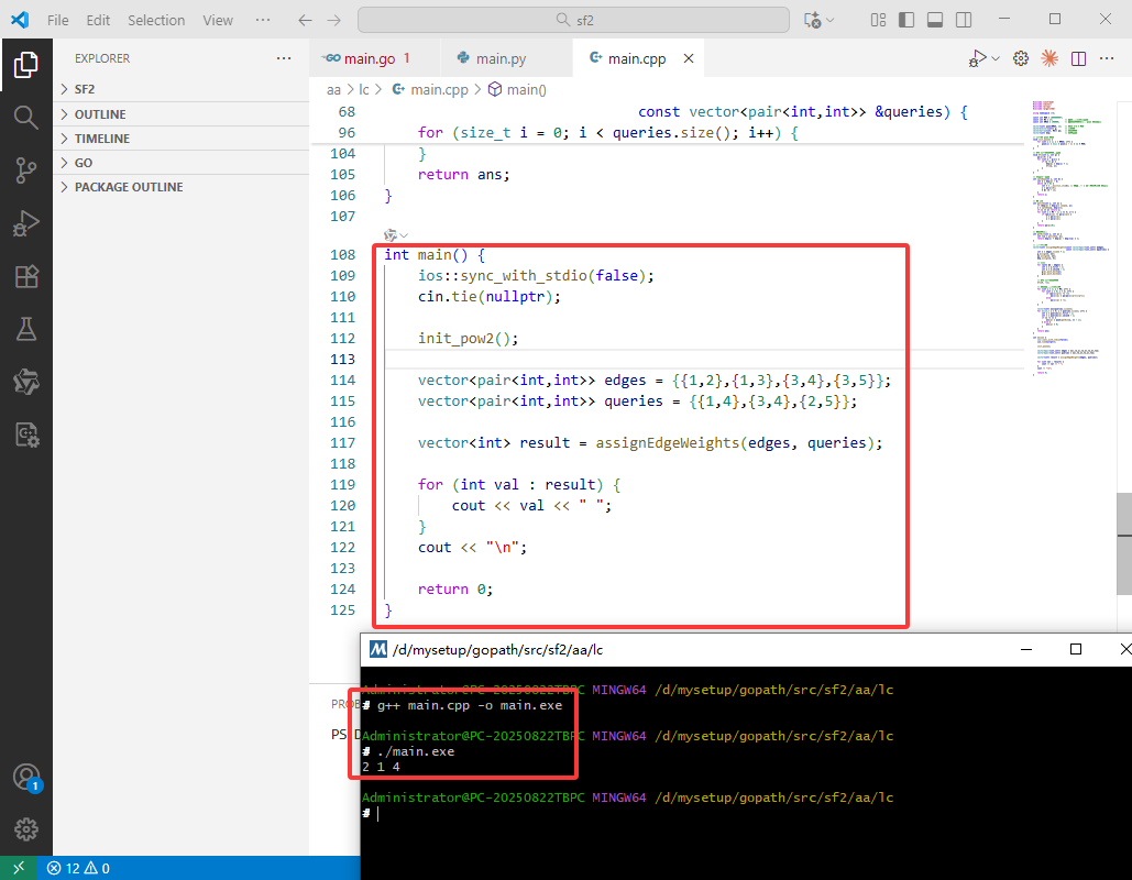

C++完整代码如下:
#include <iostream>
#include <vector>
#include <array>
#include <algorithm>
using namespace std;
const int MOD = 1000000007;
const int MX = 17;           // 最大二进制跳跃深度
const int NMAX = 100000;     // 最大节点数(用于 pow2 预处理)
vector<int> pow2(NMAX, 1);   // 存储 2^k % MOD
vector<vector<int>> g;       // 邻接表
vector<array<int, MX>> pa;   // 父节点表
vector<int> dep;             // 节点深度
// 初始化 pow2 数组
void init_pow2() {
    for (int i = 1; i < NMAX; i++) {
        pow2[i] = (1LL * pow2[i - 1] * 2) % MOD;
// DFS 建立父节点表和深度
void dfs(int x, int p) {
    pa[x][0] = p;
    for (int y : g[x]) {
        if (y != p) {
            dep[y] = dep[x] + 1;
            dfs(y, x);
// 跳到目标深度
int uptoDep(int x, int d) {
    int k = dep[x] - d;
    while (k > 0) {
        int t = __builtin_ctz(k); // 求最低位 1 的位置(MinGW 支持)
        x = pa[x][t];
        k &= (k - 1);
    return x;
// 求 LCA
int getLCA(int x, int y) {
    if (dep[x] > dep[y]) swap(x, y);
    y = uptoDep(y, dep[x]);
    if (x == y) return x;
    for (int i = MX - 1; i >= 0; i--) {
        if (pa[x][i] != pa[y][i]) {
            x = pa[x][i];
            y = pa[y][i];
    return pa[x][0];
// 求两点距离
int getDis(int x, int y) {
    int lca = getLCA(x, y);
    return dep[x] + dep[y] - dep[lca] * 2;
// 主计算函数
vector<int> assignEdgeWeights(const vector<pair<int,int>> &edges,
                              const vector<pair<int,int>> &queries) {
    int n = edges.size() + 1;
    g.assign(n, {});
    pa.assign(n, {});
    dep.assign(n, 0);
    // 建树
    for (auto &e : edges) {
        int x = e.first - 1;
        int y = e.second - 1;
        g[x].push_back(y);
        g[y].push_back(x);
    // DFS 建立父节点表
    dfs(0, -1);
    // 预处理二进制跳跃表
    for (int j = 1; j < MX; j++) {
        for (int i = 0; i < n; i++) {
            if (pa[i][j-1] != -1)
                pa[i][j] = pa[pa[i][j-1]][j-1];
            else
                pa[i][j] = -1;
    vector<int> ans(queries.size());
    for (size_t i = 0; i < queries.size(); i++) {
        int u = queries[i].first - 1;
        int v = queries[i].second - 1;
        if (u != v) {
            ans[i] = pow2[getDis(u, v) - 1];
        } else {
            ans[i] = 0;
    return ans;
int main() {
    ios::sync_with_stdio(false);
    cin.tie(nullptr);
    init_pow2();
    vector<pair<int,int>> edges = {{1,2},{1,3},{3,4},{3,5}};
    vector<pair<int,int>> queries = {{1,4},{3,4},{2,5}};
    vector<int> result = assignEdgeWeights(edges, queries);
    for (int val : result) {
        cout << val << " ";
    cout << "\n";
    return 0;
