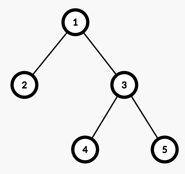

输入: edges = [[1,2],[1,3],[3,4],[3,5]]。
输出: 2。
解释:
最大深度为 2,节点 4 和节点 5 都在该深度,可以选择任意一个。
例如,从节点 1 到节点 4 的路径包括两条边(1 → 3 和 3 → 4)。
将两条边赋权为 (1,2) 或 (2,1) 会使代价为奇数,因此合法赋值方式有 2 种。
题目来自力扣3558。

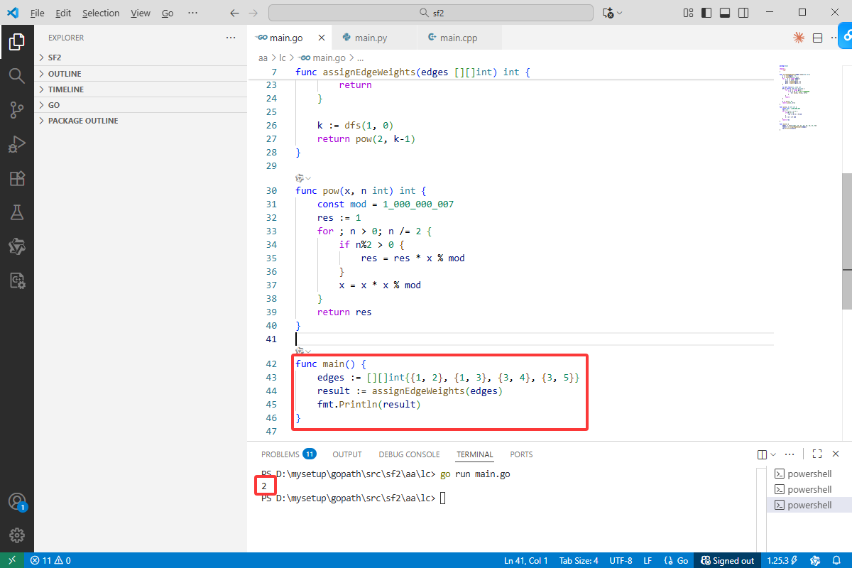

Go完整代码如下:
package main
import (
	"fmt"
func assignEdgeWeights(edges [][]int) int {
	n := len(edges) + 1
	g := make([][]int, n+1)
	for _, e := range edges {
		x, y := e[0], e[1]
		g[x] = append(g[x], y)
		g[y] = append(g[y], x)
	var dfs func(int, int) int
	dfs = func(x, fa int) (d int) {
		for _, y := range g[x] {
			if y != fa { // 不递归到父节点
				d = max(d, dfs(y, x)+1)
		return
	k := dfs(1, 0)
	return pow(2, k-1)
func pow(x, n int) int {
	const mod = 1_000_000_007
	res := 1
	for ; n > 0; n /= 2 {
		if n%2 > 0 {
			res = res * x % mod
		x = x * x % mod
	return res
func main() {
	edges := [][]int{{1, 2}, {1, 3}, {3, 4}, {3, 5}}
	result := assignEdgeWeights(edges)
	fmt.Println(result)

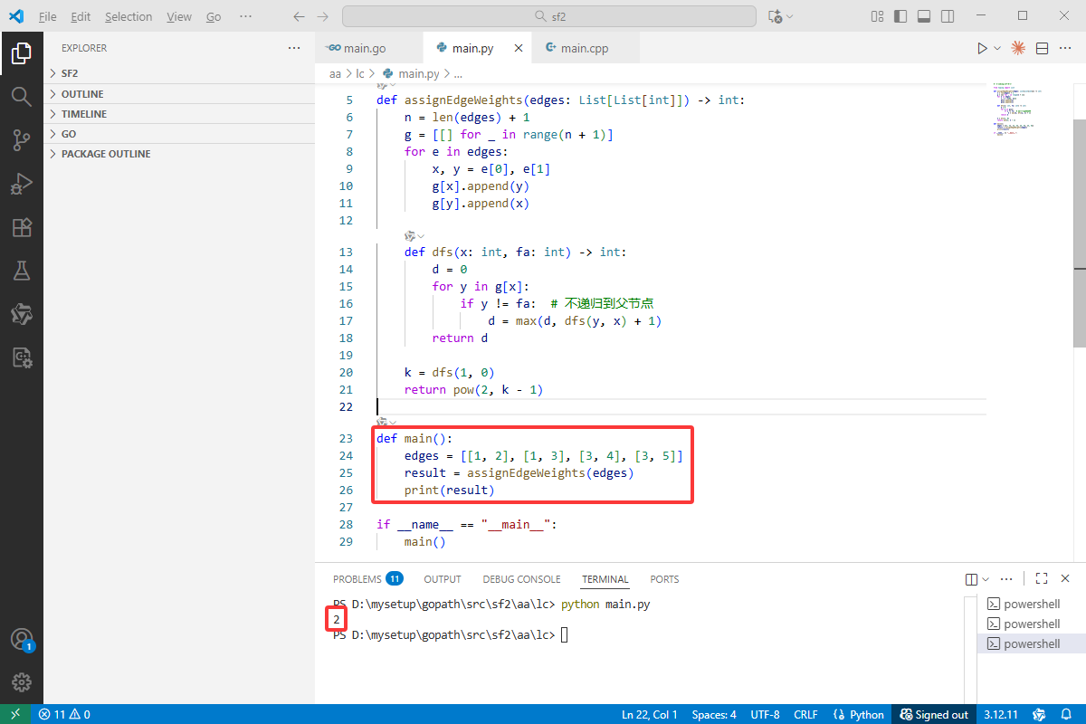

Python完整代码如下:
# -*-coding:utf-8-*-
from typing import List
def assignEdgeWeights(edges: List[List[int]]) -> int:
    n = len(edges) + 1
    g = [[] for _ in range(n + 1)]
    for e in edges:
        x, y = e[0], e[1]
        g[x].append(y)
        g[y].append(x)
    def dfs(x: int, fa: int) -> int:
        d = 0
        for y in g[x]:
            if y != fa:  # 不递归到父节点
                d = max(d, dfs(y, x) + 1)
        return d
    k = dfs(1, 0)
    return pow(2, k - 1)
def main():
    edges = [[1, 2], [1, 3], [3, 4], [3, 5]]
    result = assignEdgeWeights(edges)
    print(result)
if __name__ == "__main__":
    main()

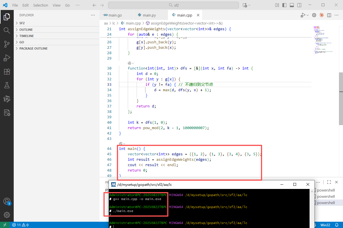

C++完整代码如下:
#include <iostream>
#include <vector>
#include <algorithm>
#include <functional>
using namespace std;
int pow_mod(int x, int n, int mod) {
    long long res = 1;
    long long base = x;
    while (n > 0) {
        if (n % 2 == 1) {
            res = (res * base) % mod;
        base = (base * base) % mod;
        n /= 2;
    return res;
int assignEdgeWeights(vector<vector<int>>& edges) {
    int n = edges.size() + 1;
    vector<vector<int>> g(n + 1);
    for (auto& e : edges) {
        int x = e[0], y = e[1];
        g[x].push_back(y);
        g[y].push_back(x);
    function<int(int, int)> dfs = [&](int x, int fa) -> int {
        int d = 0;
        for (int y : g[x]) {
            if (y != fa) { // 不递归到父节点
                d = max(d, dfs(y, x) + 1);
        return d;
    int k = dfs(1, 0);
    return pow_mod(2, k - 1, 1000000007);
int main() {
    vector<vector<int>> edges = {{1, 2}, {1, 3}, {3, 4}, {3, 5}};
    int result = assignEdgeWeights(edges);
    cout << result << endl;
    return 0;
