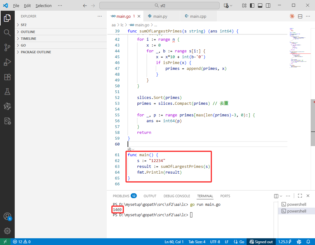

Go完整代码如下:
package main
import (
	"fmt"
	"slices"
const mx = 100_000
var np = [mx + 1]bool{true, true}
var primeNumbers []int
func init() {
	for i := 2; i <= mx; i++ {
		if !np[i] {
			primeNumbers = append(primeNumbers, i)
			for j := i * i; j <= mx; j += i {
				np[j] = true
func isPrime(n int) bool {
	if n <= mx {
		return !np[n]
	for _, p := range primeNumbers {
		if p*p > n {
			break
		if n%p == 0 {
			return false
	return true
func sumOfLargestPrimes(s string) (ans int64) {
	primes := []int{}
	n := len(s)
	for i := range n {
		x := 0
		for _, b := range s[i:] {
			x = x*10 + int(b-'0')
			if isPrime(x) {
				primes = append(primes, x)
	slices.Sort(primes)
	primes = slices.Compact(primes) // 去重
	for _, p := range primes[max(len(primes)-3, 0):] {
		ans += int64(p)
	return
func main() {
	s := "12234"
	result := sumOfLargestPrimes(s)
	fmt.Println(result)

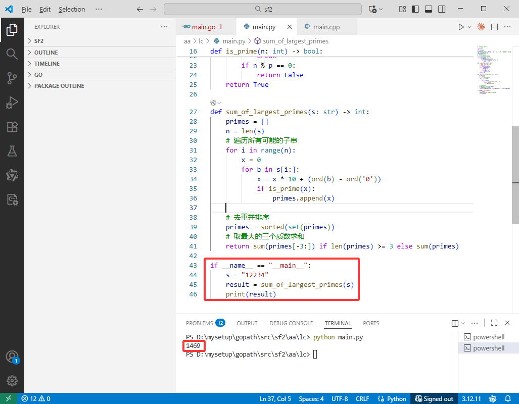

Python完整代码如下:
# -*-coding:utf-8-*-
import math
mx = 100_000
np = [True, True] + [False] * (mx - 1)  # 和 Go 中的默认值一致,np[i] = True 表示非质数
primeNumbers = []
# 初始化质数表(埃氏筛)
for i in range(2, mx + 1):
    if not np[i]:
        primeNumbers.append(i)
        for j in range(i * i, mx + 1, i):
            np[j] = True
def is_prime(n: int) -> bool:
    """判断一个数是否是质数"""
    if n <= mx:
        return not np[n]
    for p in primeNumbers:
        if p * p > n:
            break
        if n % p == 0:
            return False
    return True
def sum_of_largest_primes(s: str) -> int:
    primes = []
    n = len(s)
    # 遍历所有可能的子串
    for i in range(n):
        x = 0
        for b in s[i:]:
            x = x * 10 + (ord(b) - ord('0'))
            if is_prime(x):
                primes.append(x)
    # 去重并排序
    primes = sorted(set(primes))
    # 取最大的三个质数求和
    return sum(primes[-3:]) if len(primes) >= 3 else sum(primes)
if __name__ == "__main__":
    s = "12234"
    result = sum_of_largest_primes(s)
    print(result)

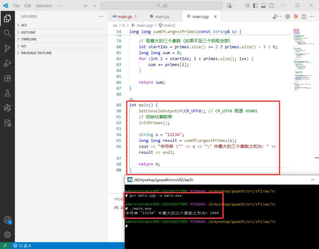

C++完整代码如下:
#include <iostream>
#include <vector>
#include <algorithm>
#include <cmath>
#include <string>
#include <unordered_set>
#include <windows.h>
using namespace std;
const int MX = 100000;
// 全局变量:素数标记数组和素数列表
vector<bool> np(MX + 1, false);
vector<int> primeNumbers;
// 初始化函数:使用埃拉托斯特尼筛法预计算素数
void initPrimes() {
    // 初始化:0和1不是素数
    np[0] = np[1] = true;
    for (int i = 2; i <= MX; i++) {
        if (!np[i]) {
            primeNumbers.push_back(i);
            // 标记i的所有倍数为非素数
            for (long long j = (long long)i * i; j <= MX; j += i) {
                np[j] = true;
// 判断一个数是否为素数
bool isPrime(int n) {
    if (n <= 1) return false;
    // 如果在预计算范围内,直接返回结果
    if (n <= MX) {
        return !np[n];
    // 对于大数,使用试除法(用已知的小素数进行测试)
    for (int p : primeNumbers) {
        if ((long long)p * p > n) {
            break;
        if (n % p == 0) {
            return false;
    return true;
// 从字符串中提取素数并返回最大的三个素数之和
long long sumOfLargestPrimes(const string& s) {
    unordered_set<int> primesSet;  // 使用集合来自动去重
    int n = s.length();
    // 生成所有可能的数字子串
    for (int i = 0; i < n; i++) {
        int x = 0;
        // 从位置i开始生成所有可能的数字
        for (int j = i; j < n; j++) {
            x = x * 10 + (s[j] - '0');
            if (isPrime(x)) {
                primesSet.insert(x);
    // 如果没有找到素数,返回0
    if (primesSet.empty()) {
        return 0;
    // 将集合转换为向量并排序
    vector<int> primes(primesSet.begin(), primesSet.end());
    sort(primes.begin(), primes.end());
    // 取最大的三个素数(如果不足三个则取全部)
    int startIdx = primes.size() >= 3 ? primes.size() - 3 : 0;
    long long sum = 0;
    for (int i = startIdx; i < primes.size(); i++) {
        sum += primes[i];
    return sum;
int main() {
    SetConsoleOutputCP(CP_UTF8); // CP_UTF8 就是 65001
    // 初始化素数表
    initPrimes();
    string s = "12234";
    long long result = sumOfLargestPrimes(s);
    cout << "字符串 \"" << s << "\" 中最大的三个素数之和为: " << result << endl;
    return 0;
