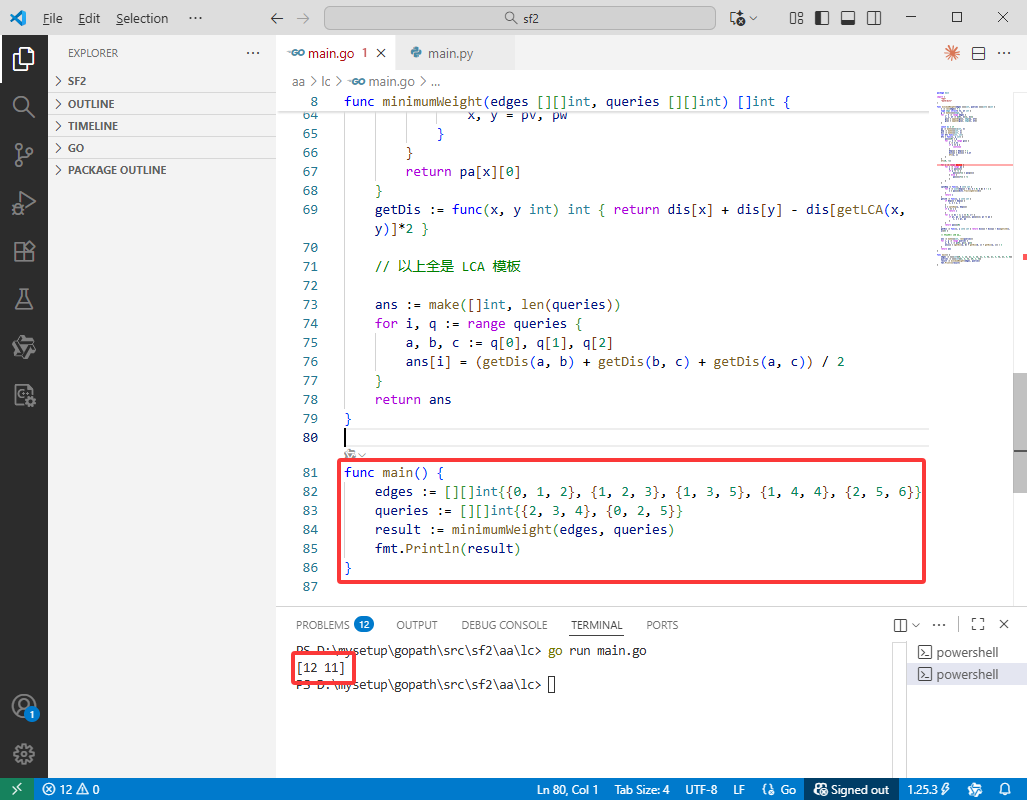

Go完整代码如下:
package main
import (
	"fmt"
	"math/bits"
func minimumWeight(edges [][]int, queries [][]int) []int {
	n := len(edges) + 1
	type edge struct{ to, wt int }
	g := make([][]edge, n)
	for _, e := range edges {
		x, y, wt := e[0], e[1], e[2]
		g[x] = append(g[x], edge{y, wt})
		g[y] = append(g[y], edge{x, wt})
	const mx = 17
	pa := make([][mx]int, n)
	dep := make([]int, n)
	dis := make([]int, n)
	var dfs func(int, int)
	dfs = func(x, p int) {
		pa[x][0] = p
		for _, e := range g[x] {
			y := e.to
			if y == p {
				continue
			dep[y] = dep[x] + 1
			dis[y] = dis[x] + e.wt
			dfs(y, x)
	dfs(0, -1)
	for i := range mx - 1 {
		for x := range pa {
			p := pa[x][i]
			if p != -1 {
				pa[x][i+1] = pa[p][i]
			} else {
				pa[x][i+1] = -1
	uptoDep := func(x, d int) int {
		for k := uint(dep[x] - d); k > 0; k &= k - 1 {
			x = pa[x][bits.TrailingZeros(k)]
		return x
	getLCA := func(x, y int) int {
		if dep[x] > dep[y] {
			x, y = y, x
		y = uptoDep(y, dep[x])
		if y == x {
			return x
		for i := mx - 1; i >= 0; i-- {
			if pv, pw := pa[x][i], pa[y][i]; pv != pw {
				x, y = pv, pw
		return pa[x][0]
	getDis := func(x, y int) int { return dis[x] + dis[y] - dis[getLCA(x, y)]*2 }
	// 以上全是 LCA 模板
	ans := make([]int, len(queries))
	for i, q := range queries {
		a, b, c := q[0], q[1], q[2]
		ans[i] = (getDis(a, b) + getDis(b, c) + getDis(a, c)) / 2
	return ans
func main() {
	edges := [][]int{{0, 1, 2}, {1, 2, 3}, {1, 3, 5}, {1, 4, 4}, {2, 5, 6}}
	queries := [][]int{{2, 3, 4}, {0, 2, 5}}
	result := minimumWeight(edges, queries)
	fmt.Println(result)

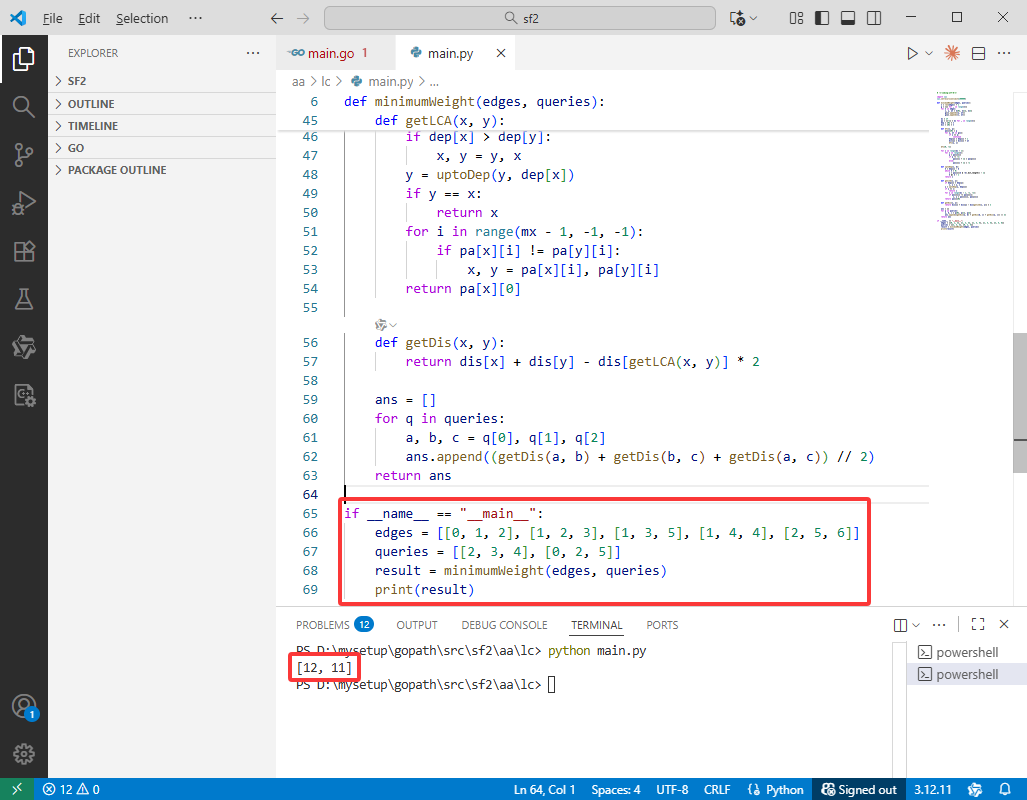

Python完整代码如下:
# -*-coding:utf-8-*-
import sys
sys.setrecursionlimit(100000)
def minimumWeight(edges, queries):
    n = len(edges) + 1
    g = [[] for _ in range(n)]
    for e in edges:
        x, y, wt = e[0], e[1], e[2]
        g[x].append((y, wt))
        g[y].append((x, wt))
    mx = 17
    pa = [[-1] * mx for _ in range(n)]
    dep = [0] * n
    dis = [0] * n
    def dfs(x, p):
        pa[x][0] = p
        for y, wt in g[x]:
            if y == p:
                continue
            dep[y] = dep[x] + 1
            dis[y] = dis[x] + wt
            dfs(y, x)
    dfs(0, -1)
    for i in range(mx - 1):
        for x in range(n):
            p = pa[x][i]
            if p != -1:
                pa[x][i + 1] = pa[p][i]
            else:
                pa[x][i + 1] = -1
    def uptoDep(x, d):
        k = dep[x] - d
        while k > 0:
            x = pa[x][(k & -k).bit_length() - 1]
            k &= k - 1
        return x
    def getLCA(x, y):
        if dep[x] > dep[y]:
            x, y = y, x
        if y == x:
            return x
        for i in range(mx - 1, -1, -1):
            if pa[x][i] != pa[y][i]:
                x, y = pa[x][i], pa[y][i]
        return pa[x][0]
    def getDis(x, y):
        return dis[x] + dis[y] - dis[getLCA(x, y)] * 2
    ans = []
    for q in queries:
        a, b, c = q[0], q[1], q[2]
        ans.append((getDis(a, b) + getDis(b, c) + getDis(a, c)) // 2)
    return ans
if __name__ == "__main__":
    edges = [[0, 1, 2], [1, 2, 3], [1, 3, 5], [1, 4, 4], [2, 5, 6]]
    queries = [[2, 3, 4], [0, 2, 5]]
    result = minimumWeight(edges, queries)
    print(result)

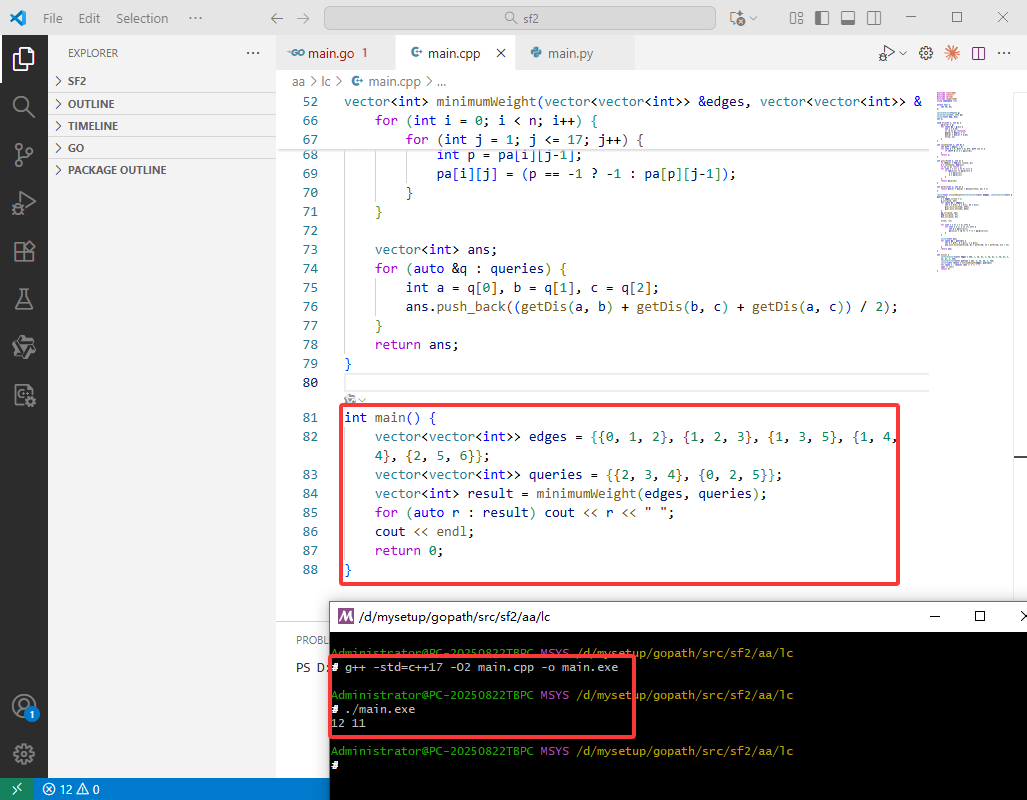

C++完整代码如下:
#include <iostream>
#include <vector>
#include <array>
#include <algorithm>
using namespace std;
struct Edge {
    int to, wt;
vector<vector<Edge>> g;
vector<array<int, 18>> pa;
vector<int> dep, dis;
int n;
void dfs(int x, int p) {
    pa[x][0] = p;
    for (auto &e : g[x]) {
        int y = e.to;
        if (y == p) continue;
        dep[y] = dep[x] + 1;
        dis[y] = dis[x] + e.wt;
        dfs(y, x);
int uptoDep(int x, int d) {
    int diff = dep[x] - d;
    for (int k = 0; diff > 0; k++, diff >>= 1) {
        if (diff & 1) x = pa[x][k];
    return x;
int getLCA(int x, int y) {
    if (dep[x] > dep[y]) swap(x, y);
    y = uptoDep(y, dep[x]);
    if (x == y) return x;
    for (int i = 17; i >= 0; i--) {
        if (pa[x][i] != pa[y][i]) {
            x = pa[x][i];
            y = pa[y][i];
    return pa[x][0];
int getDis(int x, int y) {
    return dis[x] + dis[y] - dis[getLCA(x, y)] * 2;
vector<int> minimumWeight(vector<vector<int>> &edges, vector<vector<int>> &queries) {
    n = edges.size() + 1;
    g.assign(n, {});
    for (auto &e : edges) {
        int x = e[0], y = e[1], wt = e[2];
        g[x].push_back({y, wt});
        g[y].push_back({x, wt});
    pa.assign(n, {});
    dep.assign(n, 0);
    dis.assign(n, 0);
    dfs(0, -1);
    for (int i = 0; i < n; i++) {
        for (int j = 1; j <= 17; j++) {
            int p = pa[i][j-1];
            pa[i][j] = (p == -1 ? -1 : pa[p][j-1]);
    vector<int> ans;
    for (auto &q : queries) {
        int a = q[0], b = q[1], c = q[2];
        ans.push_back((getDis(a, b) + getDis(b, c) + getDis(a, c)) / 2);
    return ans;
int main() {
    vector<vector<int>> edges = {{0, 1, 2}, {1, 2, 3}, {1, 3, 5}, {1, 4, 4}, {2, 5, 6}};
    vector<vector<int>> queries = {{2, 3, 4}, {0, 2, 5}};
    vector<int> result = minimumWeight(edges, queries);
    for (auto r : result) cout << r << " ";
    cout << endl;
    return 0;
