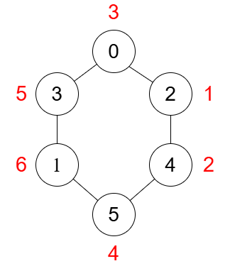

输入: n = 6, edges = [[0,3],[4,5],[2,0],[1,3],[2,4],[1,5]]。
输出: 82。
解释:
上图展示了一个最优的节点值分配方式。边值的总和为:(1 * 2) + (2 * 4) + (4 * 6) + (6 * 5) + (5 * 3) + (3 * 1) = 82。

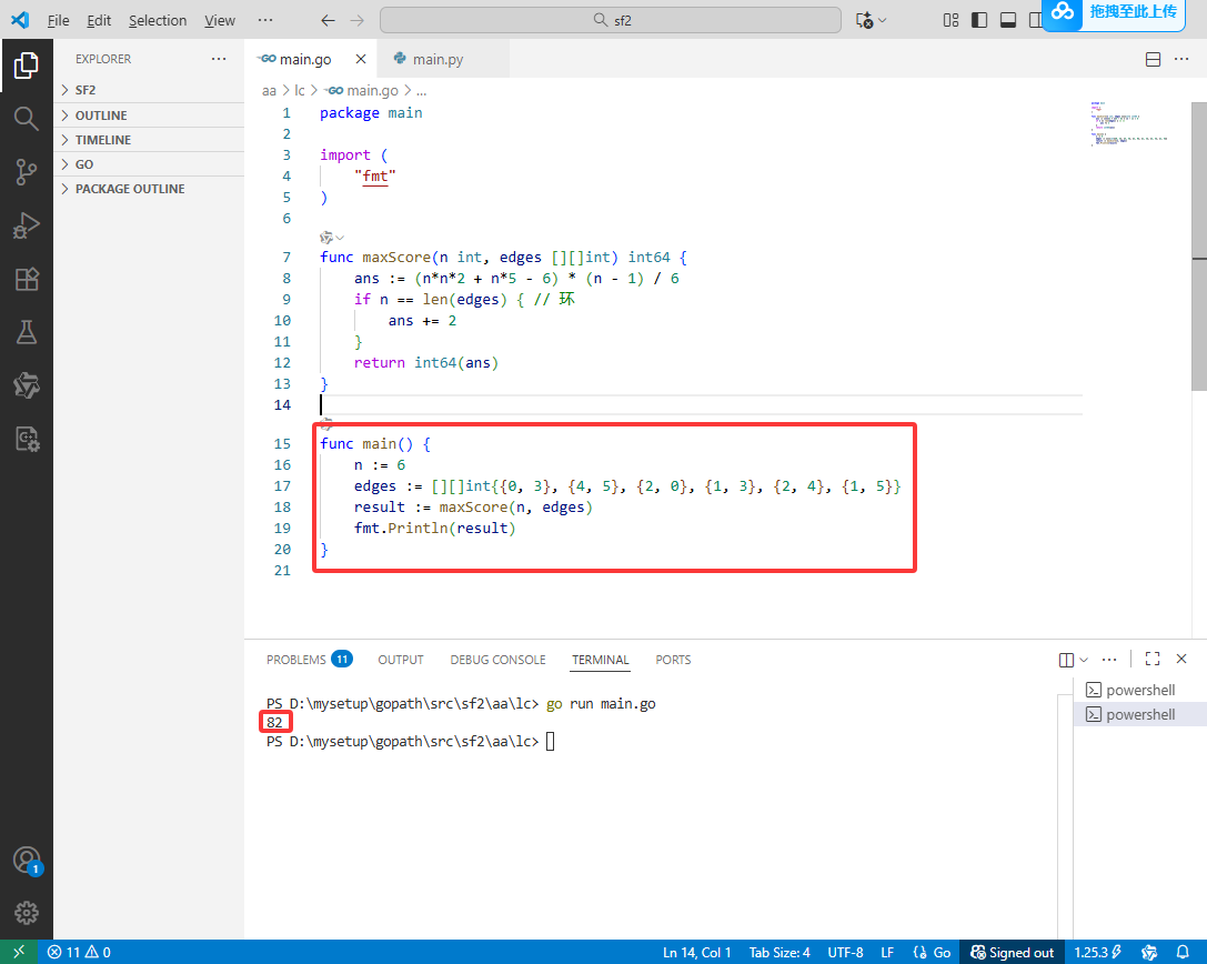

Go完整代码如下:
package main
import (
	"fmt"
func maxScore(n int, edges [][]int) int64 {
	ans := (n*n*2 + n*5 - 6) * (n - 1) / 6
	if n == len(edges) { // 环
		ans += 2
	return int64(ans)
func main() {
	n := 6
	edges := [][]int{{0, 3}, {4, 5}, {2, 0}, {1, 3}, {2, 4}, {1, 5}}
	result := maxScore(n, edges)
	fmt.Println(result)

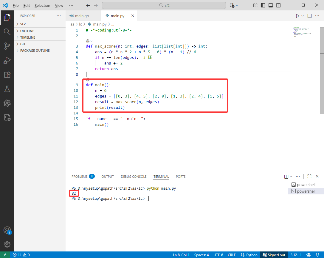

Python完整代码如下:
# -*-coding:utf-8-*-
def max_score(n: int, edges: list[list[int]]) -> int:
    ans = (n * n * 2 + n * 5 - 6) * (n - 1) // 6
    if n == len(edges):  # 环
        ans += 2
    return ans
def main():
    n = 6
    edges = [[0, 3], [4, 5], [2, 0], [1, 3], [2, 4], [1, 5]]
    result = max_score(n, edges)
    print(result)
if __name__ == "__main__":
    main()
