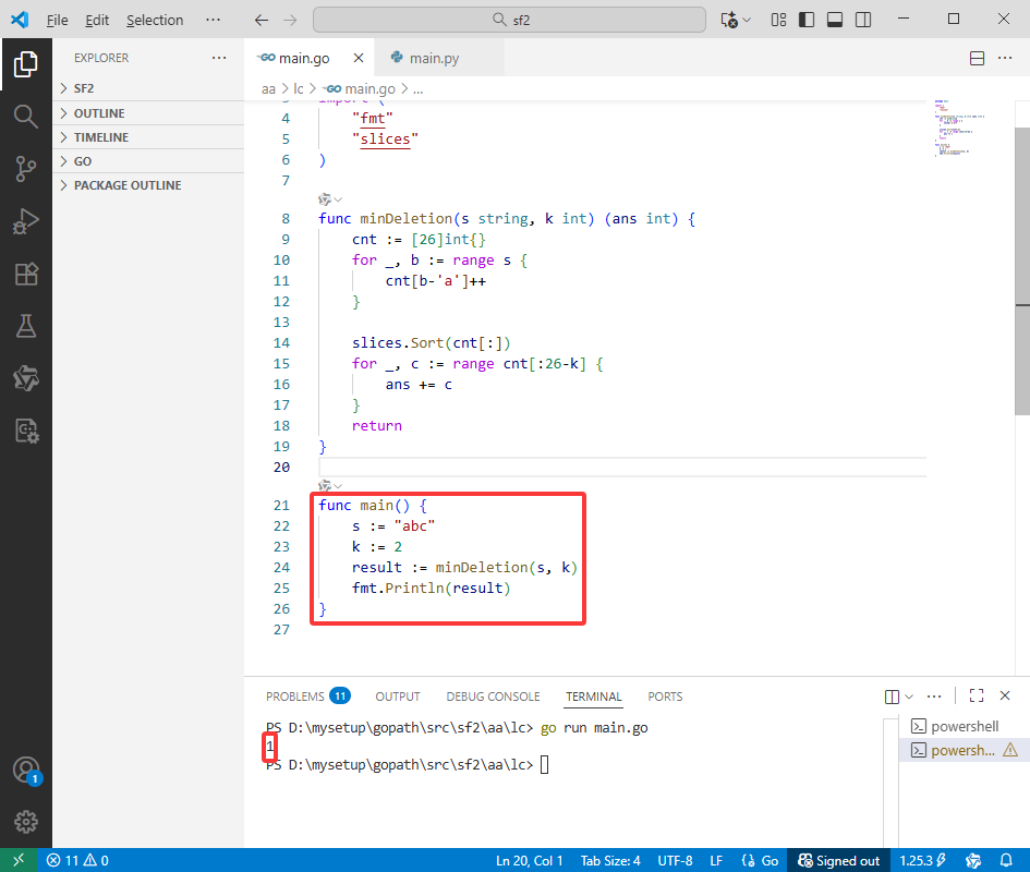

Go完整代码如下:
package main
import (
	"fmt"
	"slices"
func minDeletion(s string, k int) (ans int) {
	cnt := [26]int{}
	for _, b := range s {
		cnt[b-'a']++
	slices.Sort(cnt[:])
	for _, c := range cnt[:26-k] {
		ans += c
	return
func main() {
	s := "abc"
	k := 2
	result := minDeletion(s, k)
	fmt.Println(result)

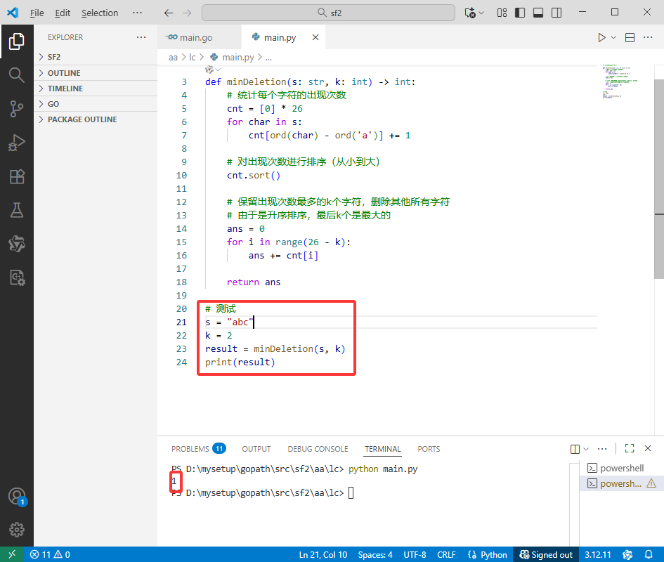

Python完整代码如下:
# -*-coding:utf-8-*-
def minDeletion(s: str, k: int) -> int:
    # 统计每个字符的出现次数
    cnt = [0] * 26
    for char in s:
        cnt[ord(char) - ord('a')] += 1
    # 对出现次数进行排序(从小到大)
    cnt.sort()
    # 保留出现次数最多的k个字符,删除其他所有字符
    # 由于是升序排序,最后k个是最大的
    ans = 0
    for i in range(26 - k):
        ans += cnt[i]
    return ans
# 测试
s = "abc"
k = 2
result = minDeletion(s, k)
print(result)
