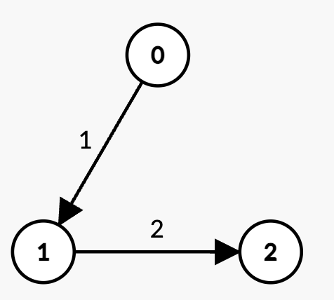

输入: n = 3, edges = [[0,1,1],[1,2,2]], k = 2, t = 4。
输出: 3。
解释:
唯一包含 k = 2 条边的路径是 0 -> 1 -> 2,其权重和为 1 + 2 = 3 < t。
因此,最大可能的边权和为 3。

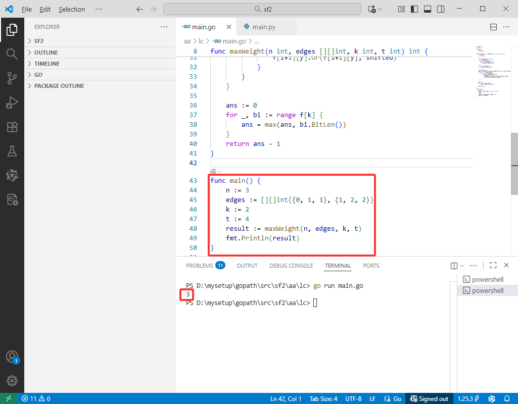

Go完整代码如下:
package main
import (
	"fmt"
	"math/big"
func maxWeight(n int, edges [][]int, k int, t int) int {
	if n <= k {
		return -1
	f := make([][]*big.Int, k+1)
	for i := range f {
		f[i] = make([]*big.Int, n)
		for j := range f[i] {
			f[i][j] = big.NewInt(0)
	for i := range f[0] {
		f[0][i] = big.NewInt(1)
	p := new(big.Int)
	mask := new(big.Int).Sub(p.Lsh(big.NewInt(1), uint(t)), big.NewInt(1))
	for i, fi := range f[:k] {
		for _, e := range edges {
			x, y, wt := e[0], e[1], e[2]
			if fi[x].Sign() != 0 {
				shifted := p.And(p.Lsh(fi[x], uint(wt)), mask)
				f[i+1][y].Or(f[i+1][y], shifted)
	ans := 0
	for _, bi := range f[k] {
		ans = max(ans, bi.BitLen())
	return ans - 1
func main() {
	n := 3
	edges := [][]int{{0, 1, 1}, {1, 2, 2}}
	k := 2
	t := 4
	result := maxWeight(n, edges, k, t)
	fmt.Println(result)

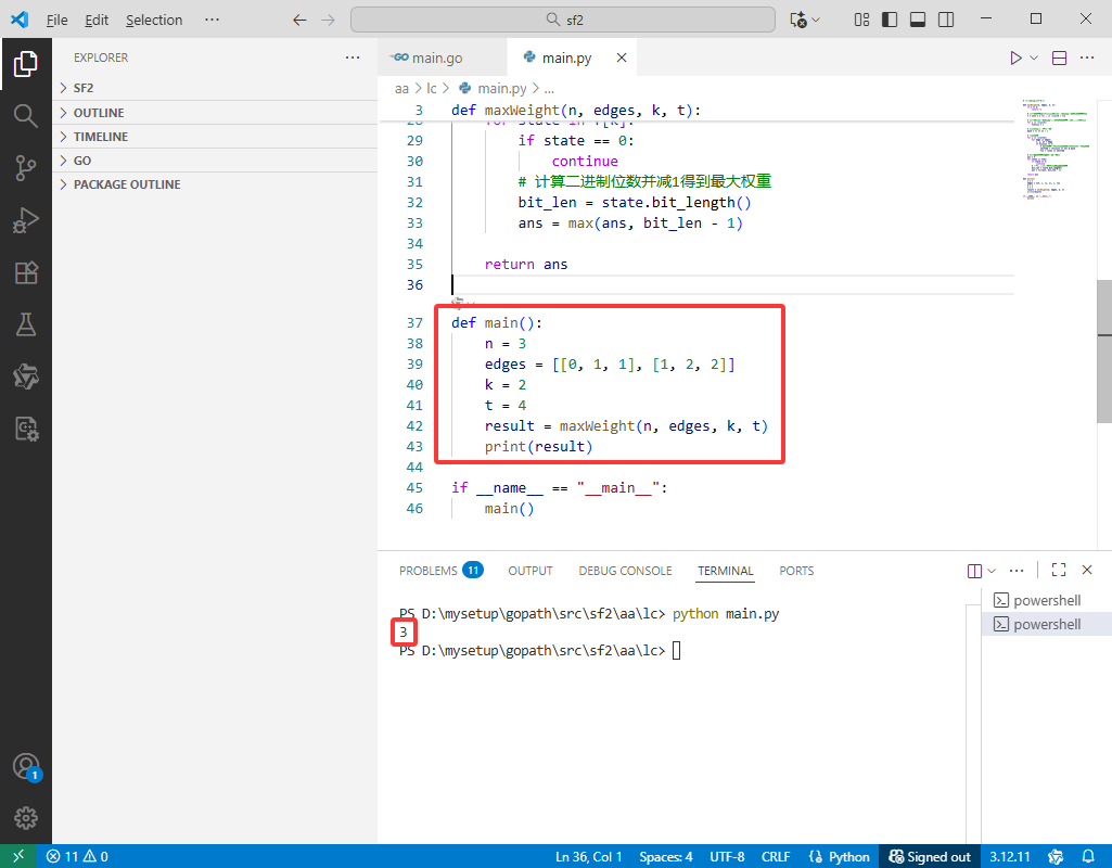

Python完整代码如下:
# -*-coding:utf-8-*-
def maxWeight(n, edges, k, t):
    if n <= k:
        return -1
    # 初始化DP数组,f[i][j]表示经过i条边到达节点j的权重状态
    f = [[0] * n for _ in range(k + 1)]
    # 初始化:经过0条边到达任何节点的权重为1(二进制表示)
    for i in range(n):
        f[0][i] = 1
    # 创建掩码用于限制位数
    mask = (1 << t) - 1
    # 动态规划
    for i in range(k):
        for edge in edges:
            x, y, wt = edge
            if f[i][x] != 0:
                # 左移权重位并与掩码取AND,然后与目标状态取OR
                shifted = (f[i][x] << wt) & mask
                f[i + 1][y] |= shifted
    # 寻找最大权重(最高位的位置)
    ans = 0
    for state in f[k]:
        if state == 0:
            continue
        # 计算二进制位数并减1得到最大权重
        bit_len = state.bit_length()
        ans = max(ans, bit_len - 1)
    return ans
def main():
    n = 3
    edges = [[0, 1, 1], [1, 2, 2]]
    k = 2
    t = 4
    result = maxWeight(n, edges, k, t)
    print(result)
if __name__ == "__main__":
    main()
