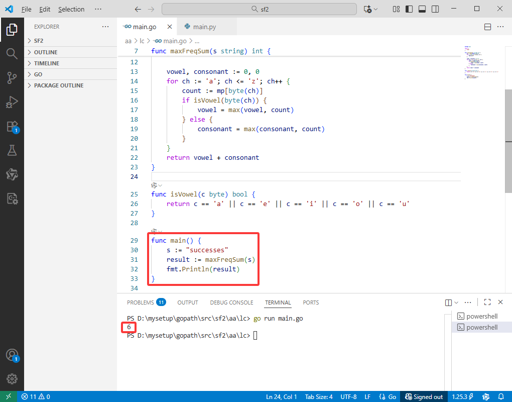

Go完整代码如下:
package main
import (
	"fmt"
func maxFreqSum(s string) int {
	mp := make(map[byte]int)
	for i := 0; i < len(s); i++ {
		mp[s[i]]++
	vowel, consonant := 0, 0
	for ch := 'a'; ch <= 'z'; ch++ {
		count := mp[byte(ch)]
		if isVowel(byte(ch)) {
			vowel = max(vowel, count)
		} else {
			consonant = max(consonant, count)
	return vowel + consonant
func isVowel(c byte) bool {
	return c == 'a' || c == 'e' || c == 'i' || c == 'o' || c == 'u'
func main() {
	s := "successes"
	result := maxFreqSum(s)
	fmt.Println(result)

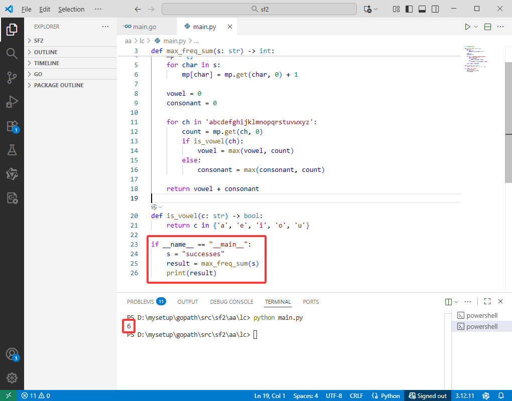

Python完整代码如下:
# -*-coding:utf-8-*-
def max_freq_sum(s: str) -> int:
    mp = {}
    for char in s:
        mp[char] = mp.get(char, 0) + 1
    vowel = 0
    consonant = 0
    for ch in 'abcdefghijklmnopqrstuvwxyz':
        count = mp.get(ch, 0)
        if is_vowel(ch):
        else:
def is_vowel(c: str) -> bool:
    return c in {'a', 'e', 'i', 'o', 'u'}
if __name__ == "__main__":
    s = "successes"
    result = max_freq_sum(s)
    print(result)
