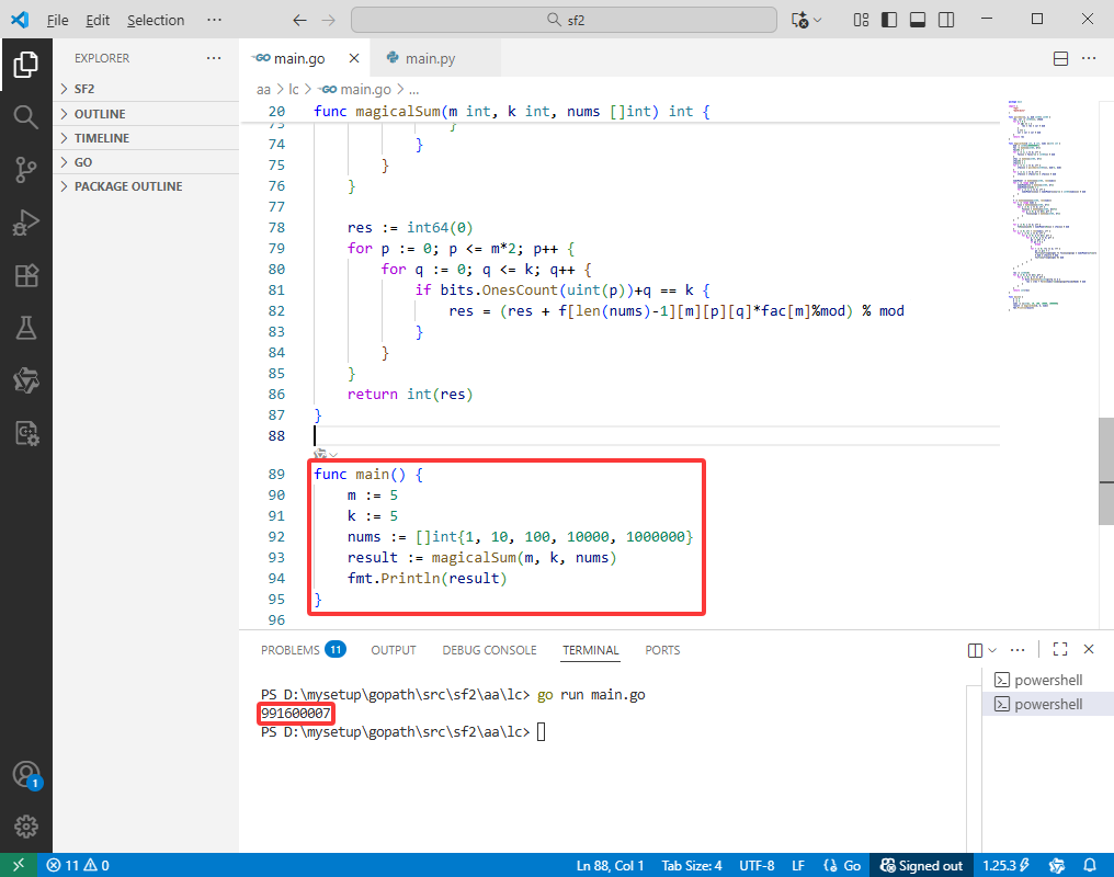

Go完整代码如下:
package main
import (
	"fmt"
	"math/bits"
func quickmul(x, y, mod int64) int64 {
	res, cur := int64(1), x%mod
	for y > 0 {
		if y&1 == 1 {
			res = res * cur % mod
		y >>= 1
		cur = cur * cur % mod
	return res
func magicalSum(m int, k int, nums []int) int {
	mod := int64(1000000007)
	fac := make([]int64, m+1)
	fac[0] = 1
	for i := 1; i <= m; i++ {
		fac[i] = fac[i-1] * int64(i) % mod
	ifac := make([]int64, m+1)
	ifac[0] = 1
	ifac[1] = 1
	for i := 2; i <= m; i++ {
		ifac[i] = quickmul(int64(i), mod-2, mod)
		ifac[i] = ifac[i-1] * ifac[i] % mod
	numsPower := make([][]int64, len(nums))
	for i := range nums {
		numsPower[i] = make([]int64, m+1)
		numsPower[i][0] = 1
		for j := 1; j <= m; j++ {
			numsPower[i][j] = numsPower[i][j-1] * int64(nums[i]) % mod
	f := make([][][][]int64, len(nums))
		f[i] = make([][][]int64, m+1)
		for j := 0; j <= m; j++ {
			f[i][j] = make([][]int64, m*2+1)
			for p := 0; p <= m*2; p++ {
				f[i][j][p] = make([]int64, k+1)
		f[0][j][j][0] = numsPower[0][j] * ifac[j] % mod
	for i := 0; i+1 < len(nums); i++ {
				for q := 0; q <= k; q++ {
					q2 := p%2 + q
					if q2 > k {
						break
					for r := 0; r+j <= m; r++ {
						p2 := p/2 + r
						f[i+1][j+r][p2][q2] += f[i][j][p][q] * numsPower[i+1][r] % mod * ifac[r] % mod
						f[i+1][j+r][p2][q2] %= mod
	res := int64(0)
			if bits.OnesCount(uint(p))+q == k {
				res = (res + f[len(nums)-1][m][p][q]*fac[m]%mod) % mod
	return int(res)
func main() {
	m := 5
	k := 5
	nums := []int{1, 10, 100, 10000, 1000000}
	result := magicalSum(m, k, nums)
	fmt.Println(result)

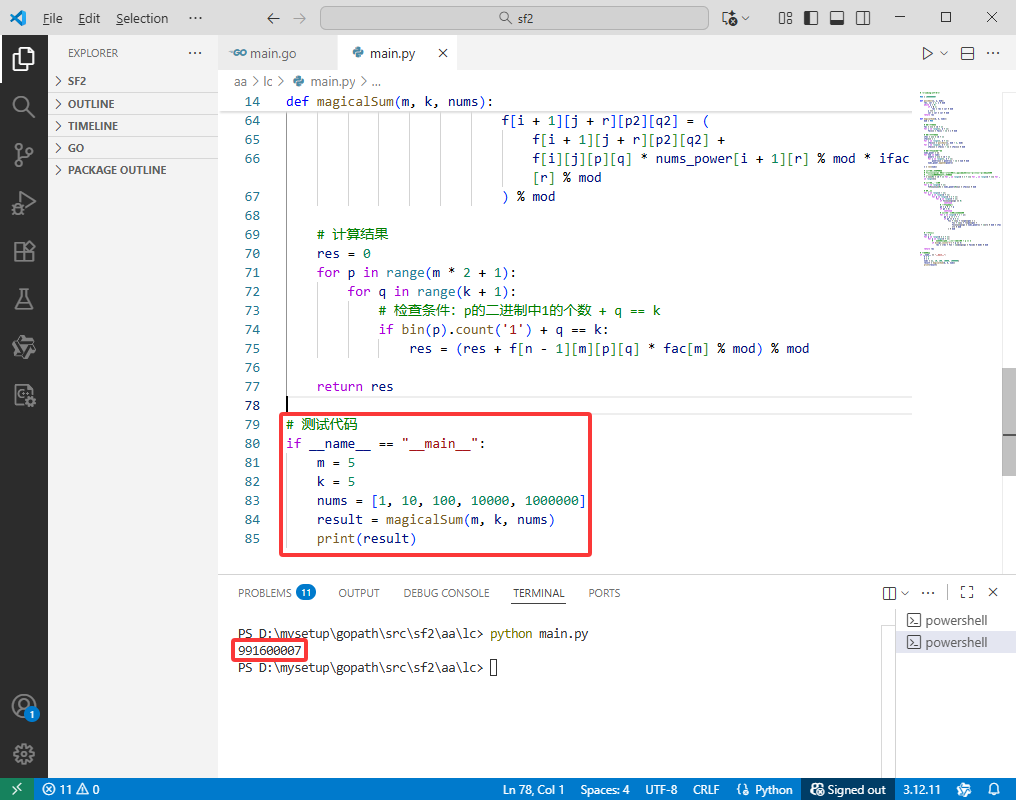

Python完整代码如下:
# -*-coding:utf-8-*-
MOD = 1000000007
def quickmul(x, y, mod):
    res, cur = 1, x % mod
    while y > 0:
        if y & 1:
        y >>= 1
    return res
def magicalSum(m, k, nums):
    mod = MOD
    # 预计算阶乘
    fac = [1] * (m + 1)
    for i in range(1, m + 1):
        fac[i] = fac[i - 1] * i % mod
    # 预计算逆阶乘
    ifac = [1] * (m + 1)
    ifac[1] = 1
    for i in range(2, m + 1):
        ifac[i] = quickmul(i, mod - 2, mod)
        ifac[i] = ifac[i - 1] * ifac[i] % mod
    # 预计算nums的幂次
    nums_power = []
    for num in nums:
        powers = [1] * (m + 1)
        for j in range(1, m + 1):
            powers[j] = powers[j - 1] * num % mod
        nums_power.append(powers)
    n = len(nums)
    # 初始化四维DP数组
    # f[i][j][p][q] 表示前i+1个数,总共选了j次,当前p值,当前q值的方案数
    # 使用嵌套列表来模拟四维数组
    f = [[[[0] * (k + 1) for _ in range(m * 2 + 1)] for _ in range(m + 1)] for _ in range(n)]
    # 初始化第一个数
    for j in range(m + 1):
        f[0][j][j][0] = nums_power[0][j] * ifac[j] % mod
    # DP转移
    for i in range(n - 1):
            for p in range(m * 2 + 1):
                for q in range(k + 1):
                    if f[i][j][p][q] == 0:
                        continue
                    # 计算新的q值
                    q2 = p % 2 + q
                    if q2 > k:
                        continue
                    # 枚举下一个数选择的次数
                    for r in range(m + 1 - j):
                        p2 = p // 2 + r
                        if p2 <= m * 2:
                            f[i + 1][j + r][p2][q2] = (
                                f[i + 1][j + r][p2][q2] +
                                f[i][j][p][q] * nums_power[i + 1][r] % mod * ifac[r] % mod
                            ) % mod
    # 计算结果
    res = 0
            # 检查条件:p的二进制中1的个数 + q == k
            if bin(p).count('1') + q == k:
                res = (res + f[n - 1][m][p][q] * fac[m] % mod) % mod
    return res
# 测试代码
if __name__ == "__main__":
    m = 5
    k = 5
    nums = [1, 10, 100, 10000, 1000000]
    result = magicalSum(m, k, nums)
    print(result)
