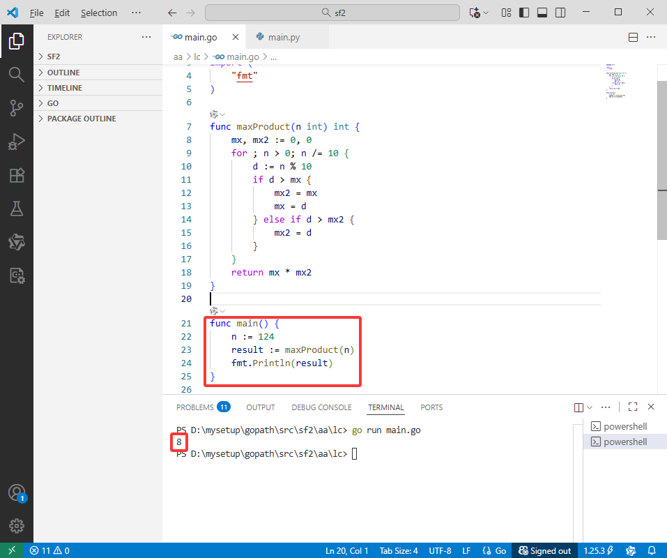

Go完整代码如下:
package main
import (
	"fmt"
func maxProduct(n int) int {
	mx, mx2 := 0, 0
	for ; n > 0; n /= 10 {
		d := n % 10
		if d > mx {
			mx2 = mx
			mx = d
		} else if d > mx2 {
			mx2 = d
	return mx * mx2
func main() {
	n := 124
	result := maxProduct(n)
	fmt.Println(result)

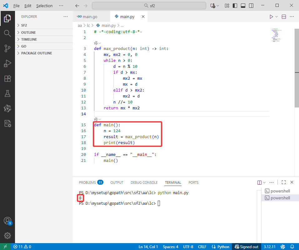

Python完整代码如下:
# -*-coding:utf-8-*-
def max_product(n: int) -> int:
    mx, mx2 = 0, 0
    while n > 0:
        d = n % 10
        if d > mx:
            mx2 = mx
            mx = d
        elif d > mx2:
            mx2 = d
        n //= 10
    return mx * mx2
def main():
    n = 124
    result = max_product(n)
    print(result)
if __name__ == "__main__":
    main()
