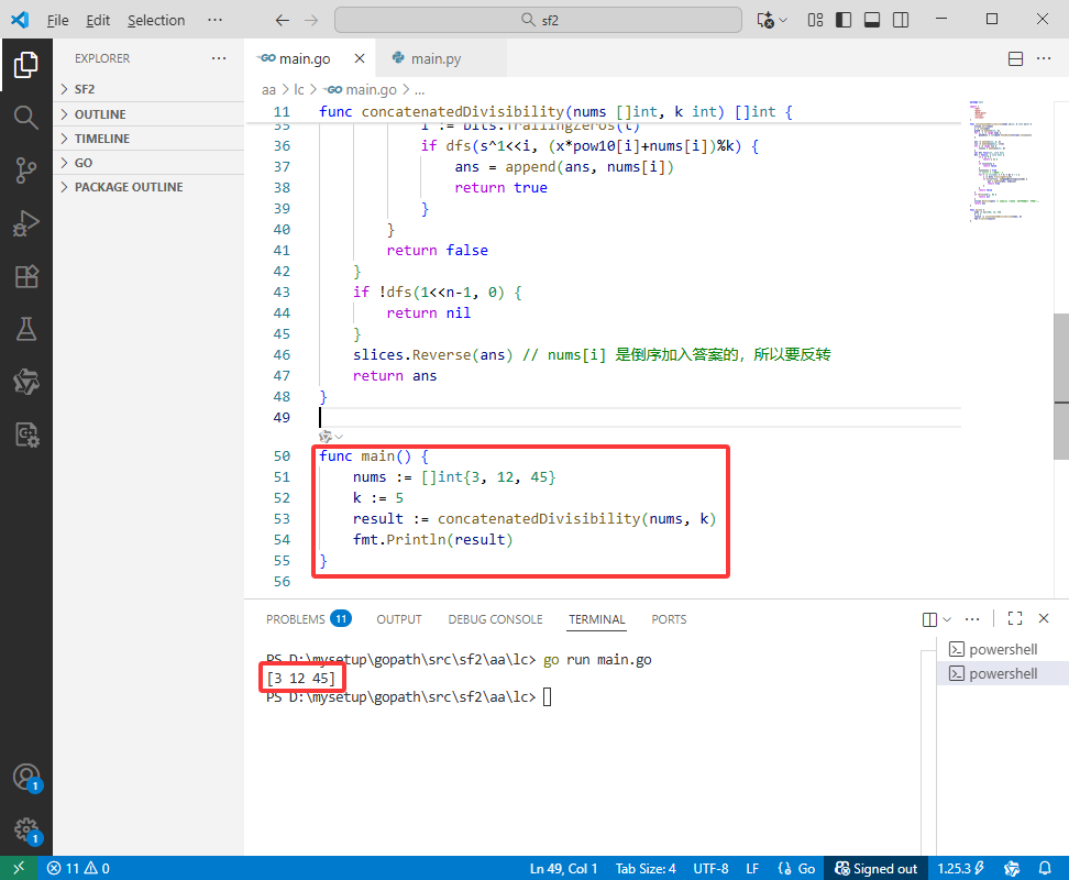

Go完整代码如下:
package main
import (
	"fmt"
	"math"
	"math/bits"
	"slices"
	"strconv"
func concatenatedDivisibility(nums []int, k int) []int {
	slices.Sort(nums)
	n := len(nums)
	pow10 := make([]int, n)
	for i, x := range nums {
		pow10[i] = int(math.Pow10(len(strconv.Itoa(x))))
	ans := make([]int, 0, n)
	vis := make([][]bool, 1<<n)
	for i := range vis {
		vis[i] = make([]bool, k)
	var dfs func(int, int) bool
	dfs = func(s, x int) bool {
		if s == 0 {
			return x == 0
		if vis[s][x] {
			return false
		vis[s][x] = true
		// 枚举在 s 中的下标 i
		for t := uint(s); t > 0; t &= t - 1 {
			i := bits.TrailingZeros(t)
			if dfs(s^1<<i, (x*pow10[i]+nums[i])%k) {
				ans = append(ans, nums[i])
				return true
		return false
	if !dfs(1<<n-1, 0) {
		return nil
	slices.Reverse(ans) // nums[i] 是倒序加入答案的,所以要反转
	return ans
func main() {
	nums := []int{3, 12, 45}
	k := 5
	result := concatenatedDivisibility(nums, k)
	fmt.Println(result)

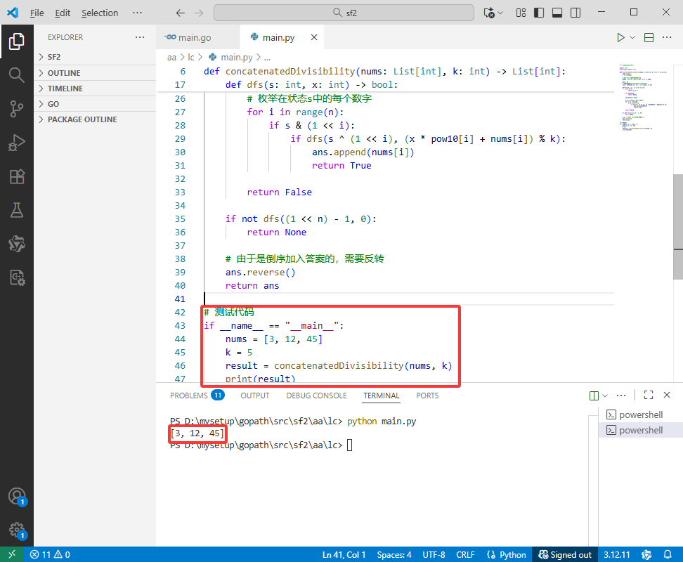

Python完整代码如下:
# -*-coding:utf-8-*-
import math
from typing import List
def concatenatedDivisibility(nums: List[int], k: int) -> List[int]:
    nums.sort()
    n = len(nums)
    # 预计算每个数字的10的幂次
    pow10 = [10 ** len(str(x)) for x in nums]
    ans = []
    # 记忆化数组:vis[state][remainder]
    vis = [[False] * k for _ in range(1 << n)]
    def dfs(s: int, x: int) -> bool:
        if s == 0:
            return x == 0
        if vis[s][x]:
            return False
        vis[s][x] = True
        # 枚举在状态s中的每个数字
        for i in range(n):
            if s & (1 << i):
                if dfs(s ^ (1 << i), (x * pow10[i] + nums[i]) % k):
                    ans.append(nums[i])
                    return True
        return False
    if not dfs((1 << n) - 1, 0):
        return None
    # 由于是倒序加入答案的,需要反转
    ans.reverse()
    return ans
# 测试代码
if __name__ == "__main__":
    nums = [3, 12, 45]
    k = 5
    result = concatenatedDivisibility(nums, k)
    print(result)
