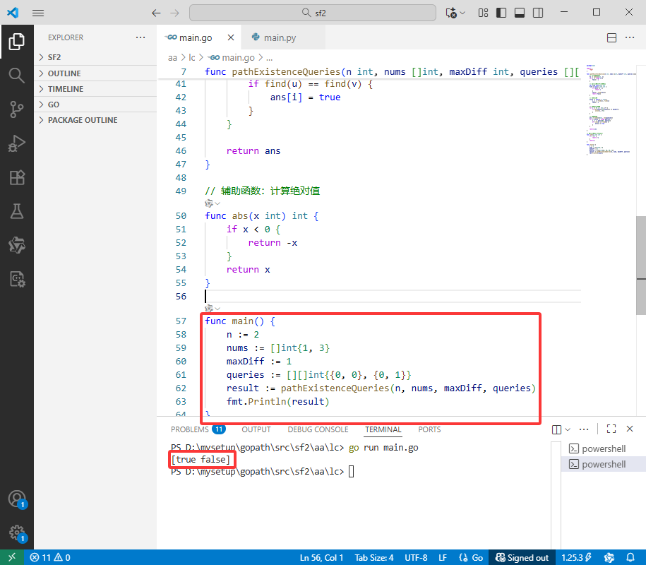

Go完整代码如下:
package main
import (
	"fmt"
func pathExistenceQueries(n int, nums []int, maxDiff int, queries [][]int) []bool {
	// 初始化并查集
	fa := make([]int, n)
	for i := range fa {
		fa[i] = i
	// 查找函数,带路径压缩
	var find func(int) int
	find = func(i int) int {
		if fa[i] == i {
			return i
		fa[i] = find(fa[i])
		return fa[i]
	// 合并函数
	union := func(i, j int) {
		x, y := find(i), find(j)
		fa[y] = x
	// 处理相邻节点
	for i := 0; i < n-1; i++ {
		if abs(nums[i+1]-nums[i]) <= maxDiff {
			union(i, i+1)
	// 处理查询
	ans := make([]bool, len(queries))
	for i, query := range queries {
		u, v := query[0], query[1]
		if find(u) == find(v) {
			ans[i] = true
	return ans
// 辅助函数:计算绝对值
func abs(x int) int {
	if x < 0 {
		return -x
	return x
func main() {
	n := 2
	nums := []int{1, 3}
	maxDiff := 1
	queries := [][]int{{0, 0}, {0, 1}}
	result := pathExistenceQueries(n, nums, maxDiff, queries)
	fmt.Println(result)

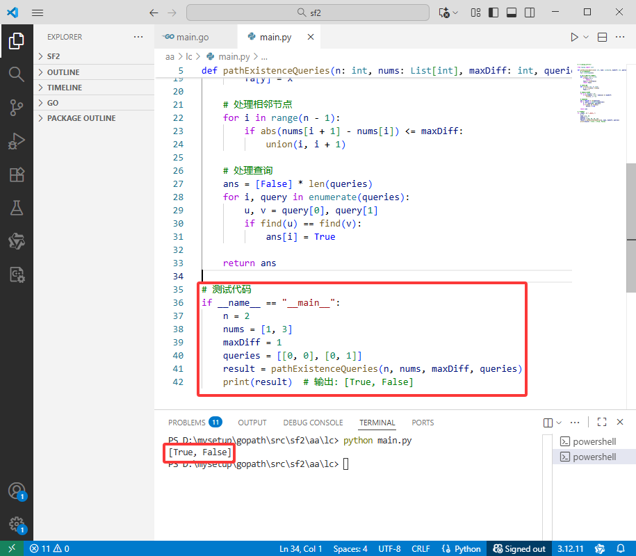

Python完整代码如下:
# -*-coding:utf-8-*-
from typing import List
def pathExistenceQueries(n: int, nums: List[int], maxDiff: int, queries: List[List[int]]) -> List[bool]:
    # 初始化并查集
    fa = list(range(n))
    # 查找函数,带路径压缩
    def find(i: int) -> int:
        if fa[i] == i:
            return i
        fa[i] = find(fa[i])
        return fa[i]
    # 合并函数
    def union(i: int, j: int):
        x, y = find(i), find(j)
        fa[y] = x
    # 处理相邻节点
    for i in range(n - 1):
        if abs(nums[i + 1] - nums[i]) <= maxDiff:
            union(i, i + 1)
    # 处理查询
    ans = [False] * len(queries)
    for i, query in enumerate(queries):
        u, v = query[0], query[1]
        if find(u) == find(v):
            ans[i] = True
    return ans
# 测试代码
if __name__ == "__main__":
    n = 2
    nums = [1, 3]
    maxDiff = 1
    queries = [[0, 0], [0, 1]]
    result = pathExistenceQueries(n, nums, maxDiff, queries)
    print(result)  # 输出: [True, False]
