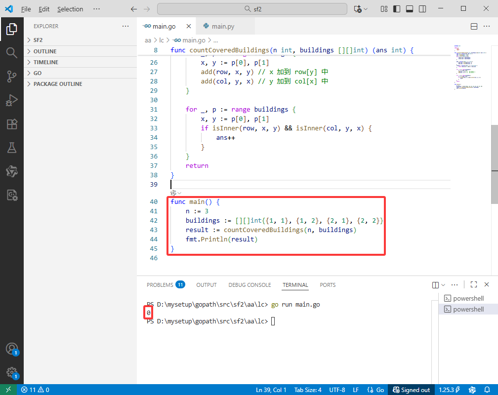

Go完整代码如下:
package main
import (
	"fmt"
	"math"
func countCoveredBuildings(n int, buildings [][]int) (ans int) {
	type pair struct{ min, max int }
	row := make([]pair, n+1)
	col := make([]pair, n+1)
	for i := 1; i <= n; i++ {
		row[i].min = math.MaxInt
		col[i].min = math.MaxInt
	add := func(m []pair, x, y int) {
		m[y].min = min(m[y].min, x)
		m[y].max = max(m[y].max, x)
	isInner := func(m []pair, x, y int) bool {
		return m[y].min < x && x < m[y].max
	for _, p := range buildings {
		x, y := p[0], p[1]
		add(row, x, y) // x 加到 row[y] 中
		add(col, y, x) // y 加到 col[x] 中
		x, y := p[0], p[1]
		if isInner(row, x, y) && isInner(col, y, x) {
			ans++
	return
func main() {
	n := 3
	buildings := [][]int{{1, 1}, {1, 2}, {2, 1}, {2, 2}}
	result := countCoveredBuildings(n, buildings)
	fmt.Println(result)

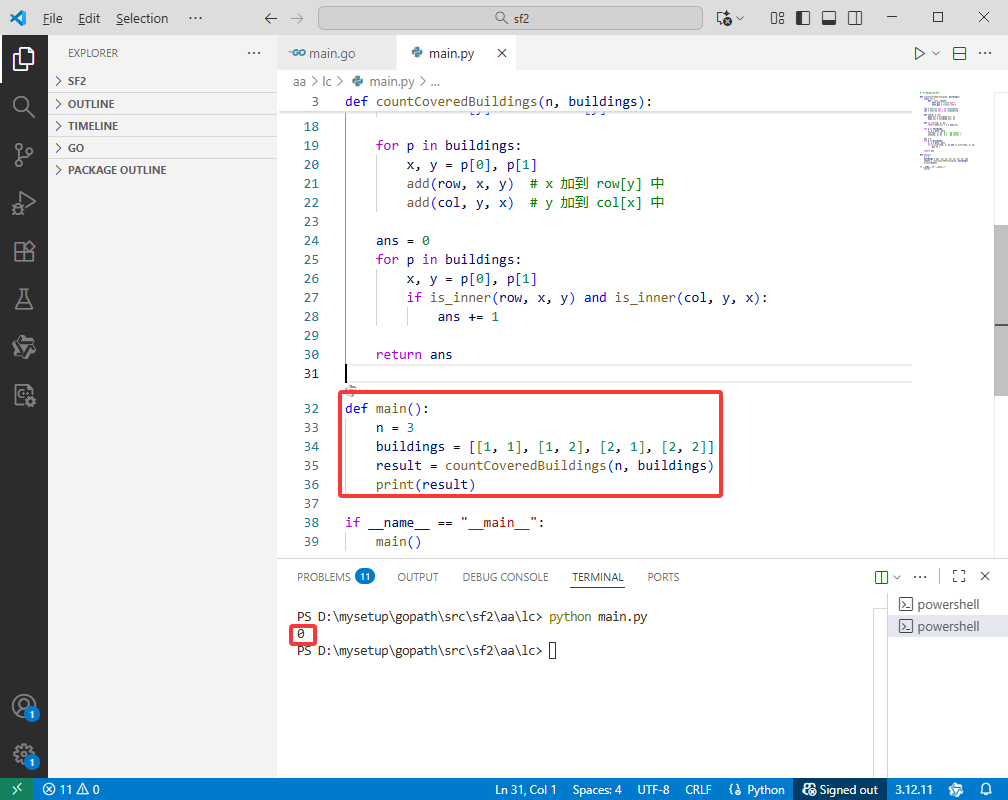

Python完整代码如下:
# -*-coding:utf-8-*-
def countCoveredBuildings(n, buildings):
    class Pair:
        def __init__(self):
            self.min = float('inf')
            self.max = float('-inf')
    row = [Pair() for _ in range(n+1)]
    col = [Pair() for _ in range(n+1)]
    def add(m, x, y):
    def is_inner(m, x, y):
        return m[y].min < x < m[y].max
    for p in buildings:
        x, y = p[0], p[1]
        add(row, x, y)  # x 加到 row[y] 中
        add(col, y, x)  # y 加到 col[x] 中
    ans = 0
    for p in buildings:
        x, y = p[0], p[1]
        if is_inner(row, x, y) and is_inner(col, y, x):
            ans += 1
    return ans
def main():
    n = 3
    buildings = [[1, 1], [1, 2], [2, 1], [2, 2]]
    result = countCoveredBuildings(n, buildings)
    print(result)
if __name__ == "__main__":
    main()
