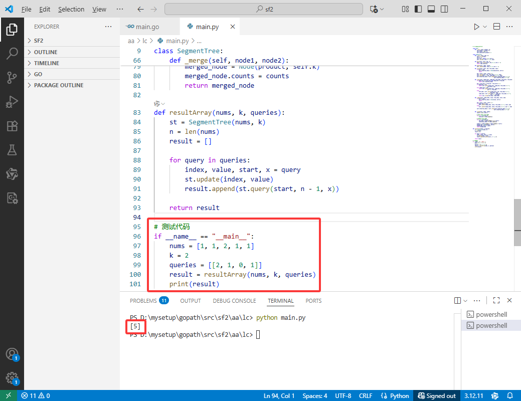

# 测试代码
if __name__ == "__main__":
nums = [1, 1, 2, 1, 1]
k = 2
queries = [[2, 1, 0, 1]]
result = resultArray(nums, k, queries)
print(result)
