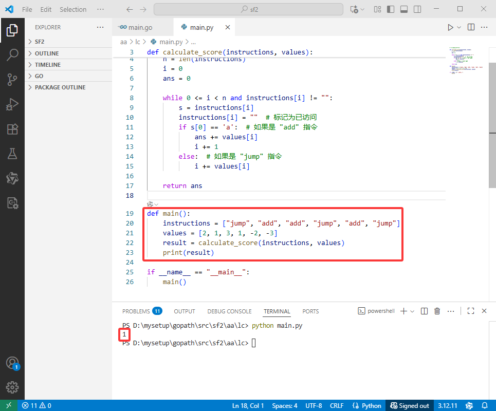

Python完整代码如下:
# -*-coding:utf-8-*-
def calculate_score(instructions, values):
    n = len(instructions)
    i = 0
    ans = 0
    while 0 <= i < n and instructions[i] != "":
        s = instructions[i]
        instructions[i] = ""  # 标记为已访问
        if s[0] == 'a':  # 如果是 "add" 指令
            ans += values[i]
            i += 1
        else:  # 如果是 "jump" 指令
            i += values[i]
    return ans
def main():
    instructions = ["jump", "add", "add", "jump", "add", "jump"]
    values = [2, 1, 3, 1, -2, -3]
    result = calculate_score(instructions, values)
    print(result)
if __name__ == "__main__":
    main()
