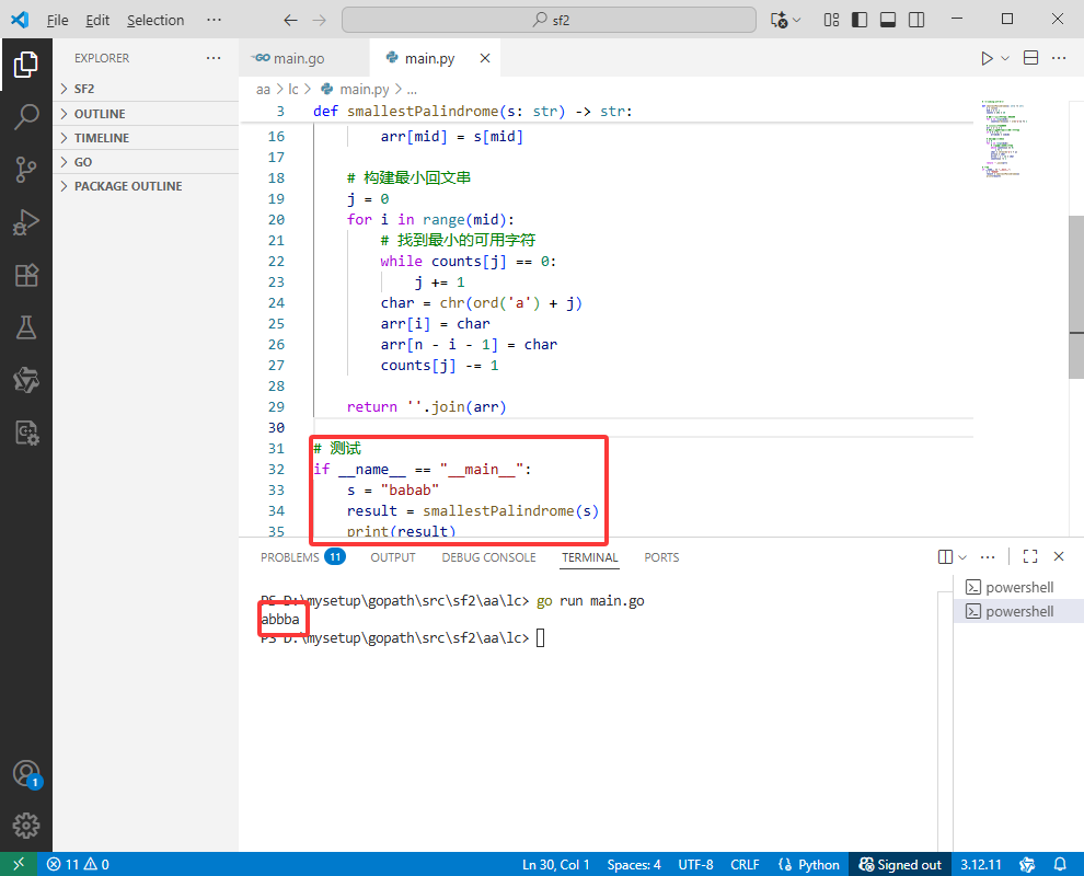

	s := "babab"
	result := smallestPalindrome(s)
	fmt.Println(result)

# 测试
if __name__ == "__main__":
    s = "babab"
    result = smallestPalindrome(s)
    print(result)
