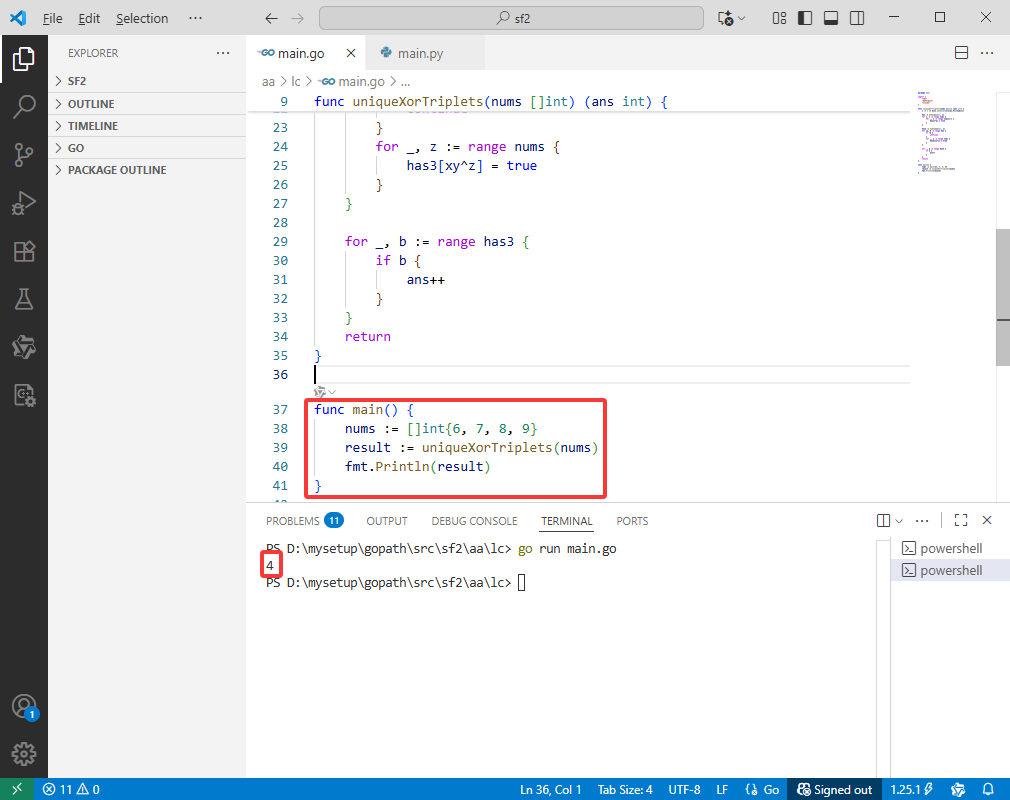

Go完整代码如下:
package main
import (
	"fmt"
	"math/bits"
	"slices"
func uniqueXorTriplets(nums []int) (ans int) {
	u := 1 << bits.Len(uint(slices.Max(nums)))
	has := make([]bool, u)
	for i, x := range nums {
		for _, y := range nums[i:] {
			has[x^y] = true
	has3 := make([]bool, u)
	for xy, b := range has {
		if !b {
			continue
		for _, z := range nums {
			has3[xy^z] = true
	for _, b := range has3 {
		if b {
			ans++
	return
func main() {
	nums := []int{6, 7, 8, 9}
	result := uniqueXorTriplets(nums)
	fmt.Println(result)

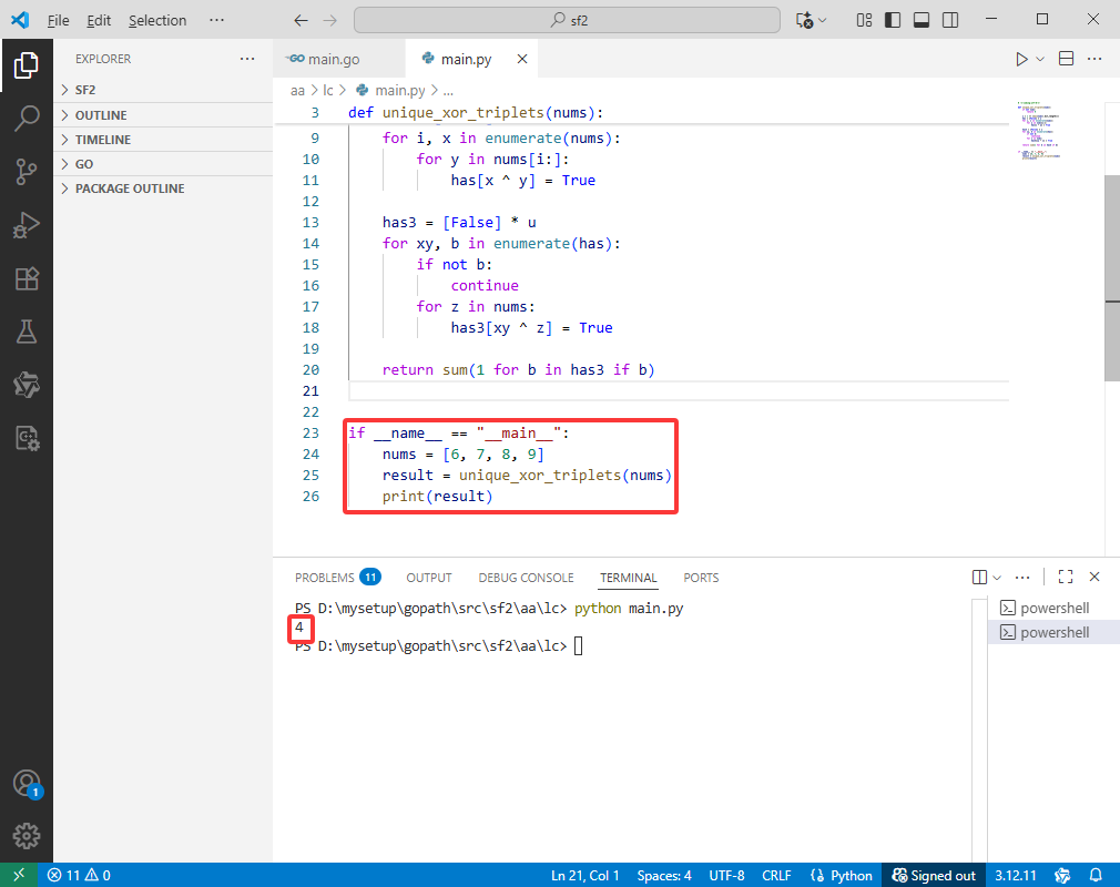

Python完整代码如下:
# -*-coding:utf-8-*-
def unique_xor_triplets(nums):
    if not nums:
        return 0
    u = 1 << (max(nums).bit_length())
    has = [False] * u
    for i, x in enumerate(nums):
        for y in nums[i:]:
            has[x ^ y] = True
    has3 = [False] * u
    for xy, b in enumerate(has):
        if not b:
            continue
        for z in nums:
            has3[xy ^ z] = True
    return sum(1 for b in has3 if b)
if __name__ == "__main__":
    nums = [6, 7, 8, 9]
    result = unique_xor_triplets(nums)
    print(result)
