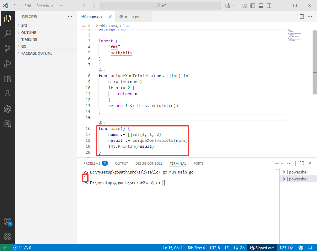

Go完整代码如下:
package main
import (
	"fmt"
	"math/bits"
func uniqueXorTriplets(nums []int) int {
	n := len(nums)
	if n <= 2 {
		return n
	return 1 << bits.Len(uint(n))
func main() {
	nums := []int{3, 1, 2}
	result := uniqueXorTriplets(nums)
	fmt.Println(result)

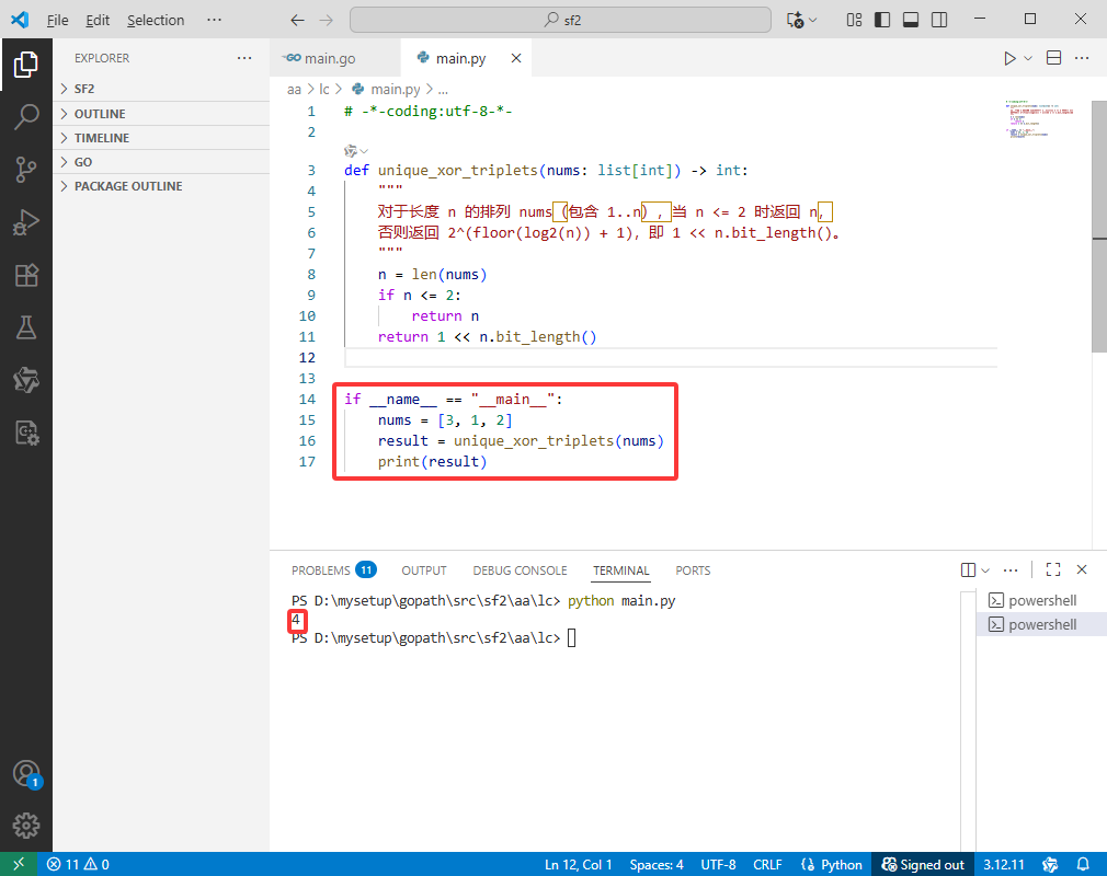

Python完整代码如下:
# -*-coding:utf-8-*-
def unique_xor_triplets(nums: list[int]) -> int:
    对于长度 n 的排列 nums(包含 1..n),当 n <= 2 时返回 n,
    否则返回 2^(floor(log2(n)) + 1),即 1 << n.bit_length()。
    n = len(nums)
    if n <= 2:
        return n
    return 1 << n.bit_length()
if __name__ == "__main__":
    nums = [3, 1, 2]
    result = unique_xor_triplets(nums)
    print(result)
