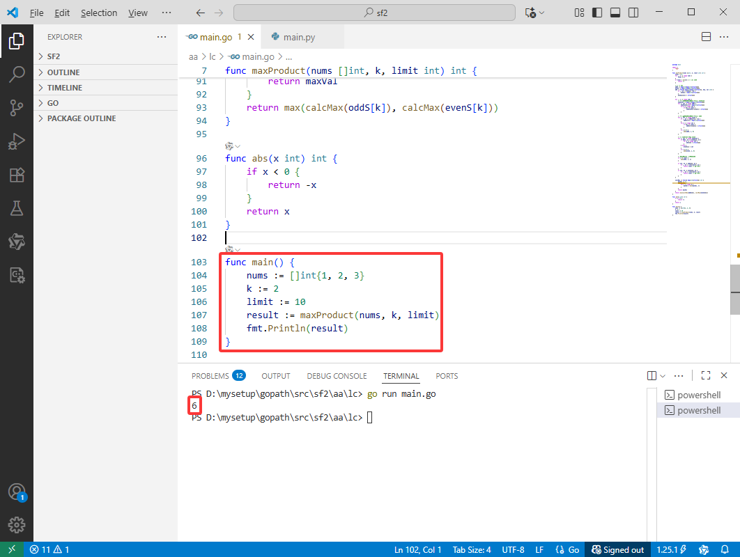

Go完整代码如下:
package main
import (
	"fmt"
func maxProduct(nums []int, k, limit int) int {
	total := 0
	for _, x := range nums {
		total += x
	if total < abs(k) { // |k| 太大
		return -1
	// s -> {m}
	oddS := map[int]map[int]struct{}{}
	evenS := map[int]map[int]struct{}{}
	add := func(m map[int]map[int]struct{}, key, val int) {
		if _, ok := m[key]; !ok {
			m[key] = map[int]struct{}{}
		m[key][val] = struct{}{}
		// 长为偶数的子序列的计算结果 newEvenS
		newEvenS := map[int]map[int]struct{}{}
		for s, set := range oddS {
			newEvenS[s-x] = map[int]struct{}{}
			for m := range set {
				if m*x <= limit {
					newEvenS[s-x][m*x] = struct{}{}
		// 长为奇数的子序列的计算结果 oddS
		for s, set := range evenS {
			if _, ok := oddS[s+x]; !ok {
				oddS[s+x] = map[int]struct{}{}
				if m*x <= limit {
					oddS[s+x][m*x] = struct{}{}
			if x == 0 {
				add(oddS, s, 0)
		// 用 newEvenS 更新 evenS
		for s, set := range newEvenS {
			if eSet, ok := evenS[s]; ok {
					eSet[m] = struct{}{}
			} else {
				evenS[s] = set
			if x == 0 {
				add(evenS, s, 0)
		// 子序列只有一个数的情况
		if x <= limit {
			add(oddS, x, x)
		if set, ok := oddS[k]; ok {
			if _, ok := set[limit]; ok {
				return limit // 提前返回
		if set, ok := evenS[k]; ok {
	calcMax := func(m map[int]struct{}) int {
		maxVal := -1
		if m != nil {
			for v := range m {
				maxVal = max(maxVal, v)
		return maxVal
	return max(calcMax(oddS[k]), calcMax(evenS[k]))
func abs(x int) int {
	if x < 0 {
		return -x
	return x
func main() {
	nums := []int{1, 2, 3}
	k := 2
	limit := 10
	result := maxProduct(nums, k, limit)
	fmt.Println(result)

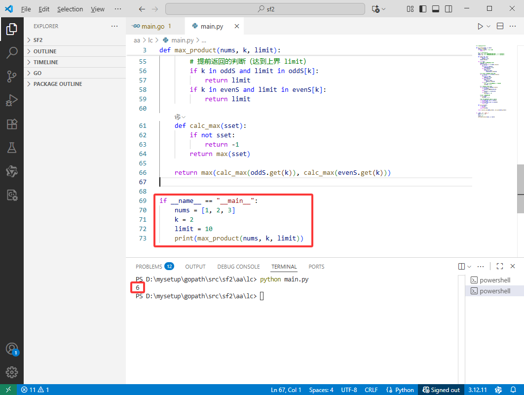

Python完整代码如下:
# -*-coding:utf-8-*-
def max_product(nums, k, limit):
    total = sum(nums)
    if total < abs(k):  # |k| 太大
        return -1
    # s -> set(products)
    oddS = {}   # 长为奇数的子序列:交替和 s -> {product}
    evenS = {}  # 长为偶数的子序列:交替和 s -> {product}
    def add(m, key, val):
        if key not in m:
            m[key] = set()
        m[key].add(val)
    for x in nums:
        # 由 oddS 扩展得到的新 evenS
        newEvenS = {}
        for s, prod_set in list(oddS.items()):
            ns = s - x
            if ns not in newEvenS:
                newEvenS[ns] = set()
            for m in prod_set:
                prod = m * x
                if prod <= limit:
                    newEvenS[ns].add(prod)
        # 由 evenS 扩展得到的 oddS 更新
        for s, prod_set in list(evenS.items()):
            ns = s + x
            if ns not in oddS:
                oddS[ns] = set()
            for m in prod_set:
                prod = m * x
                if prod <= limit:
                    oddS[ns].add(prod)
            if x == 0:
                # 当加入 0 时,产生乘积为 0 的情况
                add(oddS, s, 0)
        # 用 newEvenS 更新 evenS
        for s, prod_set in newEvenS.items():
            if s in evenS:
                evenS[s].update(prod_set)
            else:
                evenS[s] = set(prod_set)
            if x == 0:
                add(evenS, s, 0)
        # 只有一个数的子序列
        if x <= limit:
            add(oddS, x, x)
        # 提前返回的判断(达到上界 limit)
        if k in oddS and limit in oddS[k]:
            return limit
        if k in evenS and limit in evenS[k]:
            return limit
    def calc_max(sset):
        if not sset:
            return -1
        return max(sset)
    return max(calc_max(oddS.get(k)), calc_max(evenS.get(k)))
if __name__ == "__main__":
    nums = [1, 2, 3]
    k = 2
    limit = 10
    print(max_product(nums, k, limit))
