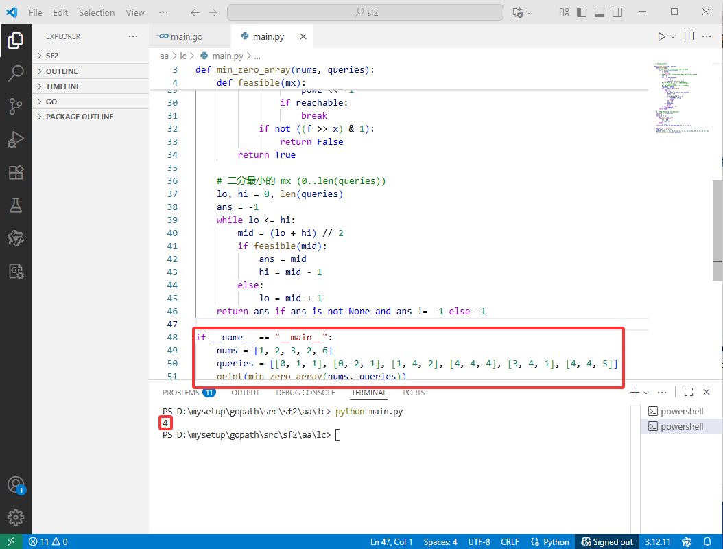

func main() {
nums := []int{1, 2, 3, 2, 6}
queries := [][]int{{0, 1, 1}, {0, 2, 1}, {1, 4, 2}, {4, 4, 4}, {3, 4, 1}, {4, 4, 5}}
result := minZeroArray(nums, queries)
fmt.Println(result)

if __name__ == "__main__":
nums = [1, 2, 3, 2, 6]
queries = [[0, 1, 1], [0, 2, 1], [1, 4, 2], [4, 4, 4], [3, 4, 1], [4, 4, 5]]
print(min_zero_array(nums, queries))
