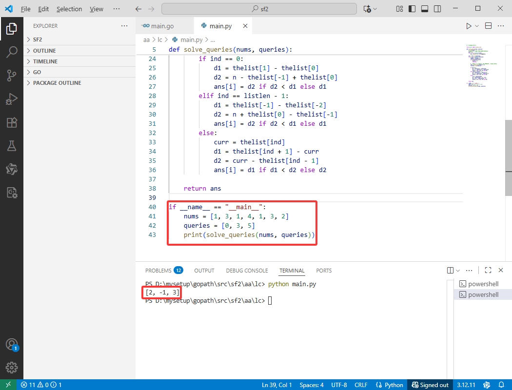

Python完整代码如下:
# -*-coding:utf-8-*-
from bisect import bisect_left
def solve_queries(nums, queries):
n = len(nums)
# 记录每个值出现的位置(按索引自然有序)
pos = {}
for i, v in enumerate(nums):
pos.setdefault(v, []).append(i)
ans = [0] * len(queries)
for i, q in enumerate(queries):
target = nums[q]
thelist = pos[target]
if len(thelist) == 1:
ans[i] = -1
continue
# 二分查找 q 在 thelist 中的位置(等价于 bisect_left)
ind = bisect_left(thelist, q)
listlen = len(thelist)
if ind == 0:
d1 = thelist[1] - thelist[0]
d2 = n - thelist[-1] + thelist[0]
ans[i] = d2 if d2 < d1 else d1
elif ind == listlen - 1:
d1 = thelist[-1] - thelist[-2]
d2 = n + thelist[0] - thelist[-1]
else:
curr = thelist[ind]
d1 = thelist[ind + 1] - curr
d2 = curr - thelist[ind - 1]
ans[i] = d1 if d1 < d2 else d2
return ans
if __name__ == "__main__":
nums = [1, 3, 1, 4, 1, 3, 2]
queries = [0, 3, 5]
print(solve_queries(nums, queries))
