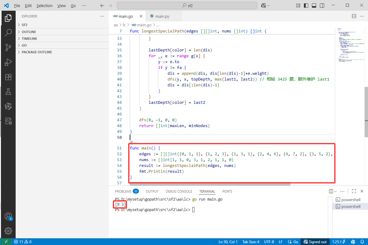

Go完整代码如下:
package main
import (
"fmt"
func longestSpecialPath(edges [][]int, nums []int) []int {
type edge struct{ to, weight int }
g := make([][]edge, len(nums))
for _, e := range edges {
x, y, w := e[0], e[1], e[2]
g[x] = append(g[x], edge{y, w})
g[y] = append(g[y], edge{x, w})
maxLen := -1
minNodes := 0
dis := []int{0}
// 颜色 -> 该颜色最近一次出现的深度 +1,注意这里已经 +1 了,下面不需要再 +1
lastDepth := map[int]int{}
var dfs func(int, int, int, int)
dfs = func(x, fa, topDepth, last1 int) {
color := nums[x]
last2 := lastDepth[color]
topDepth = max(topDepth, min(last1, last2)) // 相较 3425 题,维护窗口左端点的逻辑变了
length := dis[len(dis)-1] - dis[topDepth]
nodes := len(dis) - topDepth
if length > maxLen || length == maxLen && nodes < minNodes {
maxLen = length
minNodes = nodes
lastDepth[color] = len(dis)
for _, e := range g[x] {
y := e.to
if y != fa {
dis = append(dis, dis[len(dis)-1]+e.weight)
dfs(y, x, topDepth, max(last1, last2)) // 相较 3425 题,额外维护 last1
dis = dis[:len(dis)-1]
lastDepth[color] = last2
dfs(0, -1, 0, 0)
return []int{maxLen, minNodes}
func main() {
edges := [][]int{{0, 1, 1}, {1, 2, 3}, {1, 3, 1}, {2, 4, 6}, {4, 7, 2}, {3, 5, 2}, {3, 6, 5}, {6, 8, 3}}
nums := []int{1, 1, 0, 3, 1, 2, 1, 1, 0}
result := longestSpecialPath(edges, nums)
fmt.Println(result)

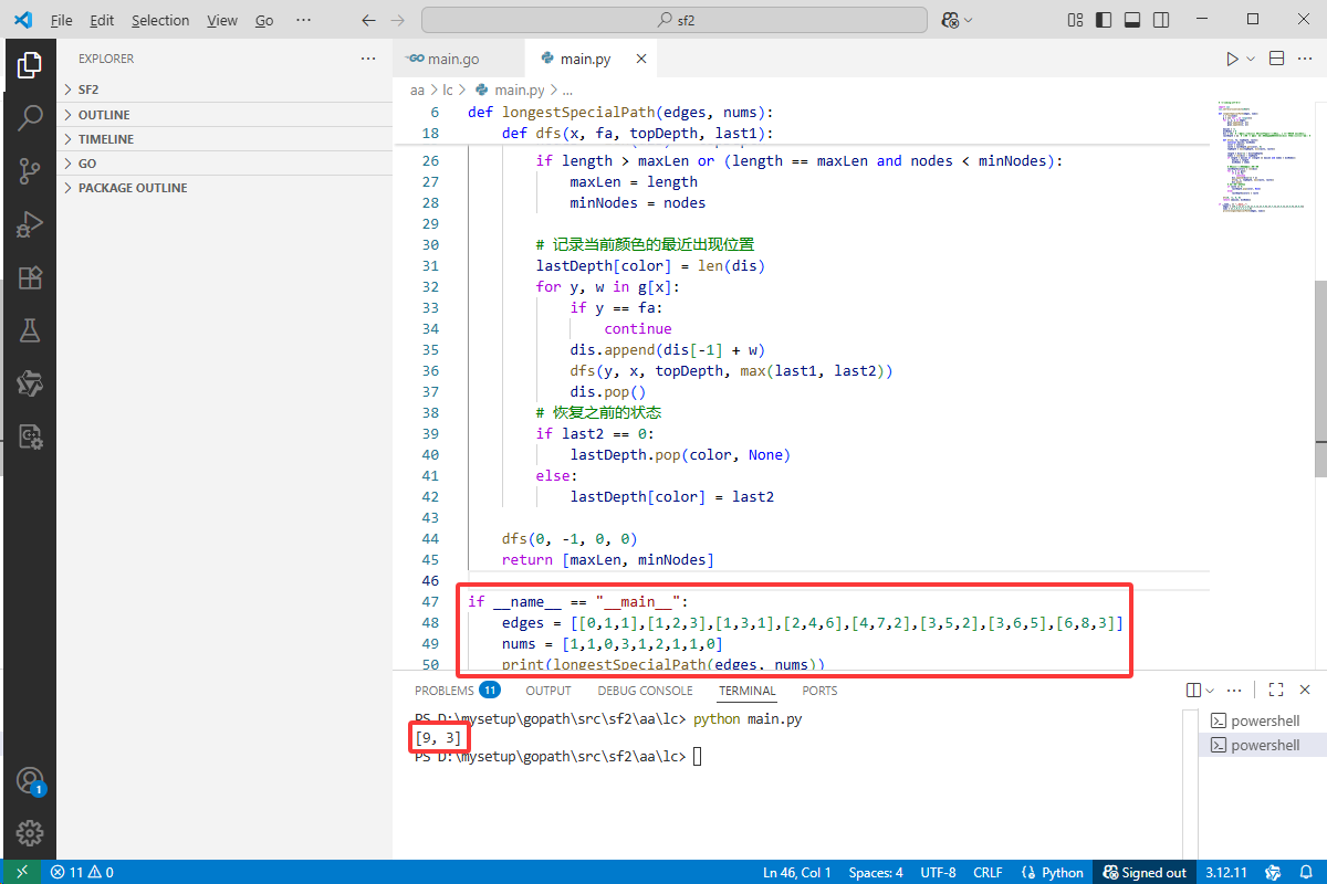

Python完整代码如下:
# -*-coding:utf-8-*-
import sys
sys.setrecursionlimit(10**7)
def longestSpecialPath(edges, nums):
n = len(nums)
g = [[] for _ in range(n)]
for x, y, w in edges:
g[x].append((y, w))
g[y].append((x, w))
maxLen = -1
minNodes = 0
dis = [0] # 前缀距离,dis[i] 表示从根到当前路径上第 i 个位置(0 起)的距离
lastDepth = {} # 颜色 -> 最近一次出现的深度索引(len(dis) 时的值),缺省视为 0
def dfs(x, fa, topDepth, last1):
nonlocal maxLen, minNodes
color = nums[x]
last2 = lastDepth.get(color, 0)
length = dis[-1] - dis[topDepth]
nodes = len(dis) - topDepth
if length > maxLen or (length == maxLen and nodes < minNodes):
maxLen = length
minNodes = nodes
# 记录当前颜色的最近出现位置
for y, w in g[x]:
if y == fa:
continue
dis.append(dis[-1] + w)
dis.pop()
# 恢复之前的状态
if last2 == 0:
lastDepth.pop(color, None)
else:
dfs(0, -1, 0, 0)
return [maxLen, minNodes]
if __name__ == "__main__":
edges = [[0,1,1],[1,2,3],[1,3,1],[2,4,6],[4,7,2],[3,5,2],[3,6,5],[6,8,3]]
nums = [1,1,0,3,1,2,1,1,0]
print(longestSpecialPath(edges, nums))
