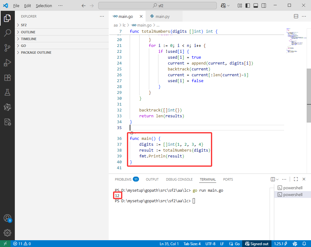

Go完整代码如下:
package main
import (
"fmt"
func totalNumbers(digits []int) int {
n := len(digits)
used := make([]bool, n)
results := make(map[int]bool)
var backtrack func(current []int)
backtrack = func(current []int) {
if len(current) == 3 {
if current[0] != 0 && current[2]%2 == 0 {
num := current[0]*100 + current[1]*10 + current[2]
results[num] = true
return
for i := 0; i < n; i++ {
if !used[i] {
used[i] = true
current = append(current, digits[i])
backtrack(current)
current = current[:len(current)-1]
used[i] = false
backtrack([]int{})
return len(results)
func main() {
digits := []int{1, 2, 3, 4}
result := totalNumbers(digits)
fmt.Println(result)

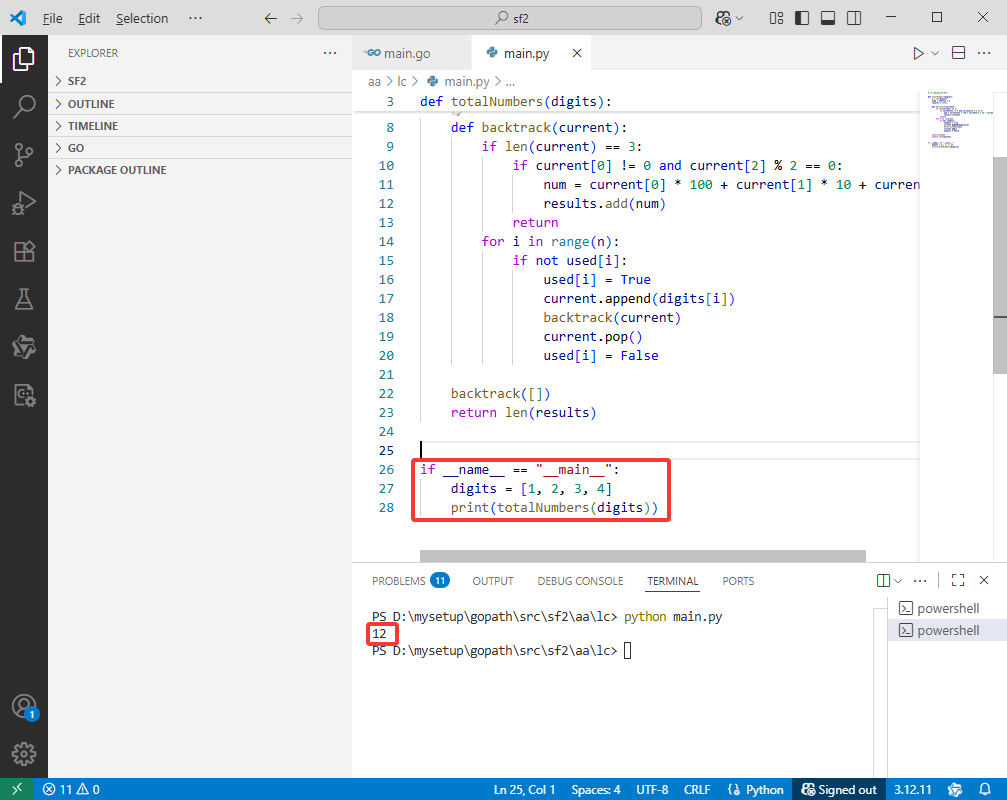

Python完整代码如下:
# -*-coding:utf-8-*-
def totalNumbers(digits):
n = len(digits)
used = [False] * n
results = set()
def backtrack(current):
if len(current) == 3:
if current[0] != 0 and current[2] % 2 == 0:
num = current[0] * 100 + current[1] * 10 + current[2]
results.add(num)
return
for i in range(n):
if not used[i]:
used[i] = True
current.append(digits[i])
backtrack(current)
current.pop()
used[i] = False
backtrack([])
return len(results)
if __name__ == "__main__":
digits = [1, 2, 3, 4]
print(totalNumbers(digits))
