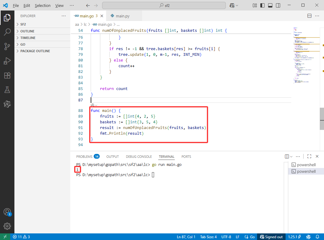

	fruits := []int{4, 2, 5}
	baskets := []int{3, 5, 4}
	result := numOfUnplacedFruits(fruits, baskets)
	fmt.Println(result)
