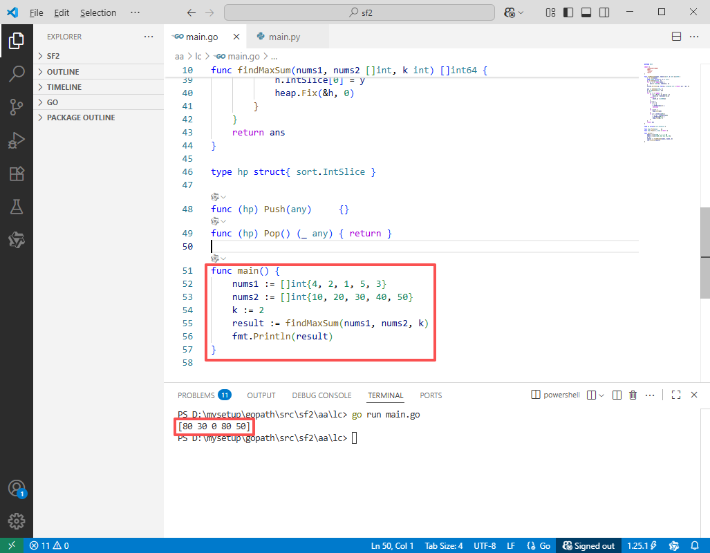

Go完整代码如下:
package main
import (
	"container/heap"
	"fmt"
	"slices"
	"sort"
func findMaxSum(nums1, nums2 []int, k int) []int64 {
	n := len(nums1)
	type tuple struct{ x, y, i int }
	a := make([]tuple, n)
	for i, x := range nums1 {
		a[i] = tuple{x, nums2[i], i}
	slices.SortFunc(a, func(p, q tuple) int { return p.x - q.x })
	ans := make([]int64, n)
	h := hp{make([]int, k)}
	s := 0
	for i, t := range a {
		if i > 0 && t.x == a[i-1].x {
			ans[t.i] = ans[a[i-1].i]
		} else {
			ans[t.i] = int64(s)
		y := t.y
		if i < k {
			s += y
			h.IntSlice[i] = y
			continue
		if i == k {
			heap.Init(&h)
		if y > h.IntSlice[0] {
			s += y - h.IntSlice[0]
			h.IntSlice[0] = y
			heap.Fix(&h, 0)
	return ans
type hp struct{ sort.IntSlice }
func (hp) Push(any)     {}
func (hp) Pop() (_ any) { return }
func main() {
	nums1 := []int{4, 2, 1, 5, 3}
	nums2 := []int{10, 20, 30, 40, 50}
	k := 2
	result := findMaxSum(nums1, nums2, k)
	fmt.Println(result)

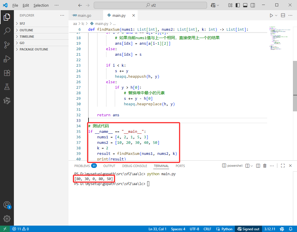

Python完整代码如下:
# -*-coding:utf-8-*-
import heapq
from typing import List
def findMaxSum(nums1: List[int], nums2: List[int], k: int) -> List[int]:
    n = len(nums1)
    # 创建元组列表 (nums1[i], nums2[i], i)
    a = [(x, nums2[i], i) for i, x in enumerate(nums1)]
    a.sort(key=lambda x: x[0])
    ans = [0] * n
    h = []  # 最小堆
    s = 0
    for i, (x, y, idx) in enumerate(a):
        if i > 0 and x == a[i-1][0]:
            # 如果当前nums1值与上一个相同,直接使用上一个的结果
            ans[idx] = ans[a[i-1][2]]
        else:
            ans[idx] = s
        if i < k:
            s += y
            heapq.heappush(h, y)
        else:
            if y > h[0]:
                # 替换堆中最小的元素
                s += y - h[0]
                heapq.heapreplace(h, y)
    return ans
# 测试代码
if __name__ == "__main__":
    nums1 = [4, 2, 1, 5, 3]
    nums2 = [10, 20, 30, 40, 50]
    k = 2
    result = findMaxSum(nums1, nums2, k)
    print(result)
