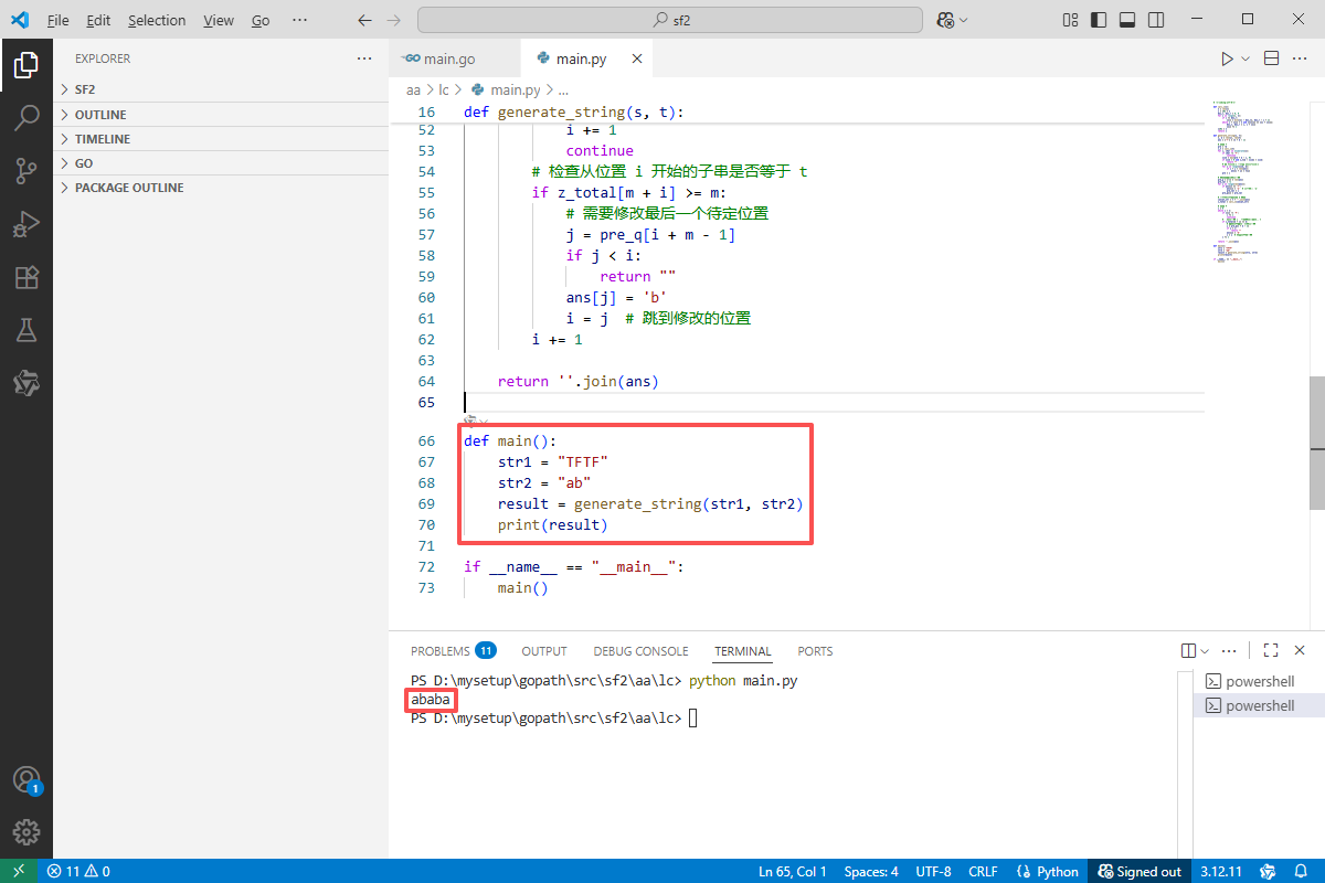

	str1 := "TFTF"
	str2 := "ab"
	result := generateString(str1, str2)
	fmt.Println(result)

def main():
    str1 = "TFTF"
    str2 = "ab"
    result = generate_string(str1, str2)
    print(result)
if __name__ == "__main__":
    main()
