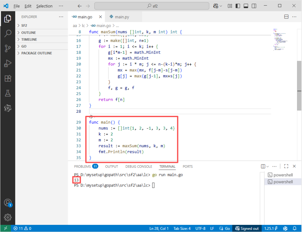

Go完整代码如下:
package main
import (
	"fmt"
	"math"
func maxSum(nums []int, k, m int) int {
	n := len(nums)
	s := make([]int, n+1)
	for i, x := range nums {
		s[i+1] = s[i] + x
	f := make([]int, n+1)
	g := make([]int, n+1)
	for i := 1; i <= k; i++ {
		g[i*m-1] = math.MinInt
		mx := math.MinInt
		for j := i * m; j <= n-(k-i)*m; j++ {
			mx = max(mx, f[j-m]-s[j-m])
			g[j] = max(g[j-1], mx+s[j])
		f, g = g, f
	return f[n]
func main() {
	nums := []int{1, 2, -1, 3, 3, 4}
	k := 2
	m := 2
	result := maxSum(nums, k, m)
	fmt.Println(result)

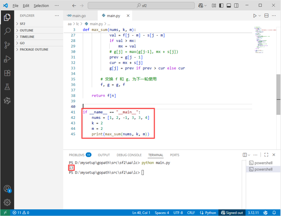

Python完整代码如下:
# -*-coding:utf-8-*-
def max_sum(nums, k, m):
    n = len(nums)
    if n < k * m:
        raise ValueError("数组长度不足以选出 k 个每个至少长度为 m 的子数组")
    # 前缀和
    s = [0] * (n + 1)
    for i, x in enumerate(nums):
        s[i + 1] = s[i] + x
    NEG = -10**30
    f = [0] * (n + 1)
    g = [0] * (n + 1)
    for i in range(1, k + 1):
        # 初始化本轮 g(只需保证 g[start-1] 为 -inf)
        for t in range(n + 1):
            g[t] = 0
        g[i * m - 1] = NEG
        mx = NEG
        start = i * m
        end = n - (k - i) * m  # inclusive
        for j in range(start, end + 1):
            # 更新候选最大值
            val = f[j - m] - s[j - m]
            if val > mx:
                mx = val
            # g[j] = max(g[j-1], mx + s[j])
            prev = g[j - 1]
            cur = mx + s[j]
            g[j] = prev if prev > cur else cur
        # 交换 f 和 g,为下一轮使用
        f, g = g, f
    return f[n]
if __name__ == "__main__":
    nums = [1, 2, -1, 3, 3, 4]
    k = 2
    m = 2
    print(max_sum(nums, k, m))
