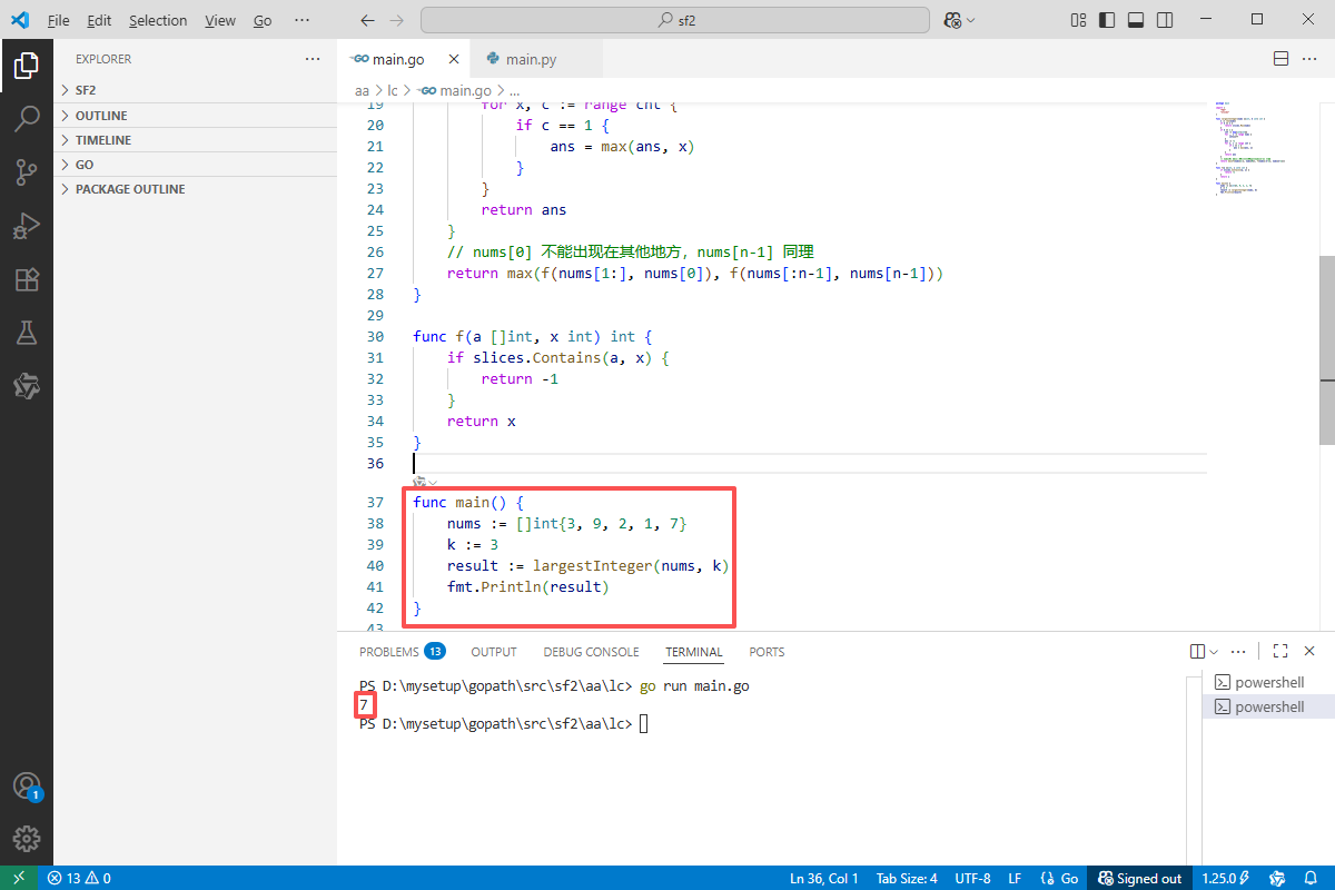

Go完整代码如下:
package main
import (
"fmt"
"slices"
func largestInteger(nums []int, k int) int {
n := len(nums)
if k == n {
return slices.Max(nums)
if k == 1 {
cnt := map[int]int{}
for _, x := range nums {
cnt[x]++
ans := -1
for x, c := range cnt {
if c == 1 {
ans = max(ans, x)
return ans
// nums[0] 不能出现在其他地方,nums[n-1] 同理
return max(f(nums[1:], nums[0]), f(nums[:n-1], nums[n-1]))
func f(a []int, x int) int {
if slices.Contains(a, x) {
return -1
return x
func main() {
nums := []int{3, 9, 2, 1, 7}
k := 3
result := largestInteger(nums, k)
fmt.Println(result)

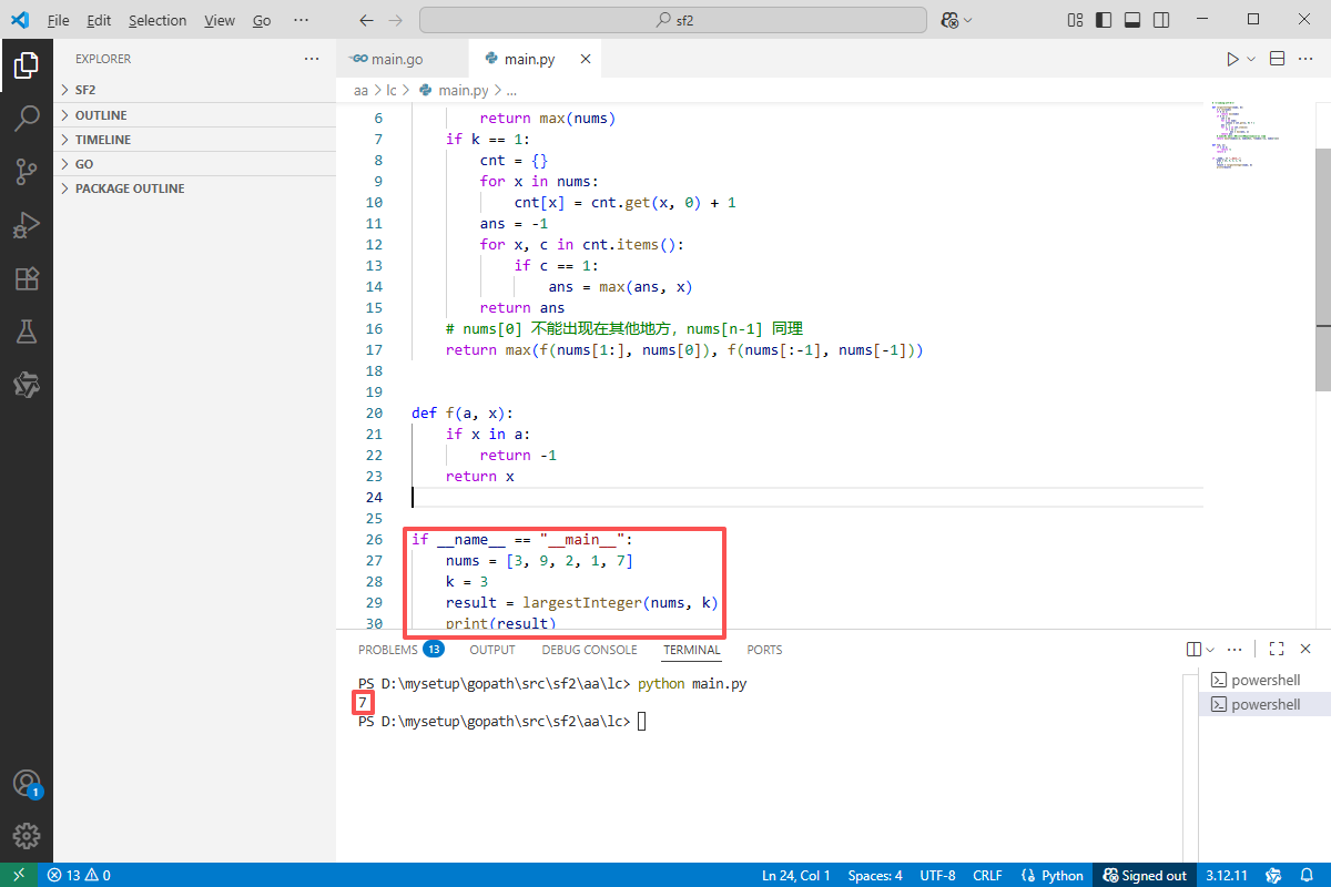

Python完整代码如下:
# -*-coding:utf-8-*-
def largestInteger(nums, k):
n = len(nums)
if k == n:
return max(nums)
if k == 1:
cnt = {}
for x in nums:
cnt[x] = cnt.get(x, 0) + 1
ans = -1
for x, c in cnt.items():
if c == 1:
ans = max(ans, x)
return ans
# nums[0] 不能出现在其他地方,nums[n-1] 同理
return max(f(nums[1:], nums[0]), f(nums[:-1], nums[-1]))
def f(a, x):
if x in a:
return -1
return x
if __name__ == "__main__":
nums = [3, 9, 2, 1, 7]
k = 3
result = largestInteger(nums, k)
print(result)
