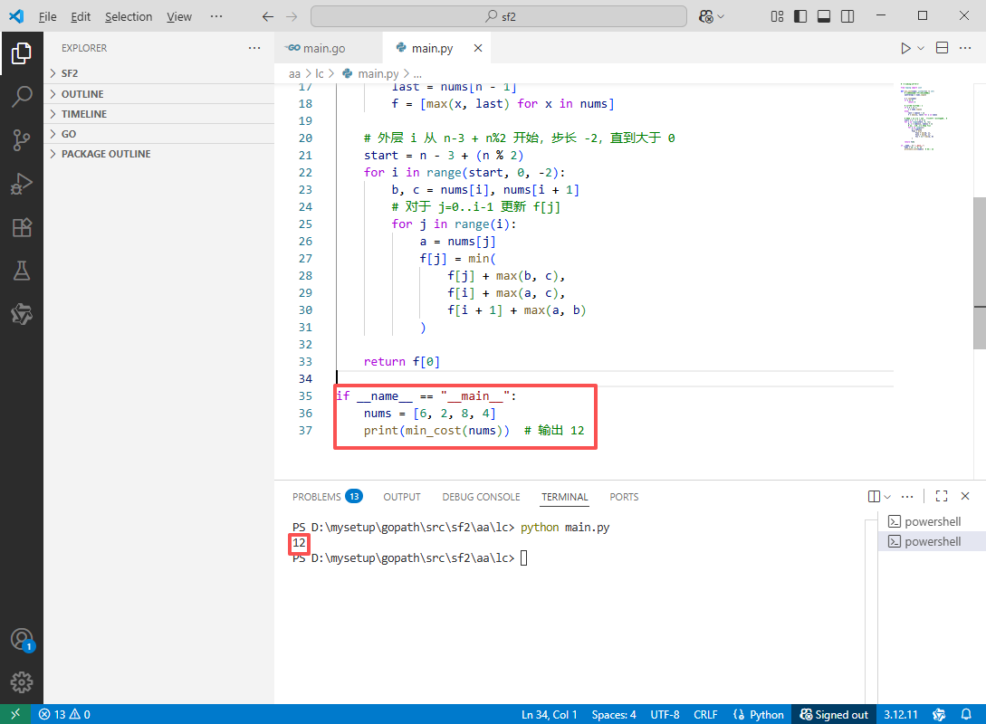

Python完整代码如下:
# -*-coding:utf-8-*-
from typing import List
def min_cost(nums: List[int]) -> int:
# 保存输入的中间值(按要求)
xantreloqu = nums.copy()
n = len(nums)
if n == 0:
return 0
# 初始化 f:长度为 n
if n % 2 == 1:
f = nums.copy()
else:
last = nums[n - 1]
f = [max(x, last) for x in nums]
# 外层 i 从 n-3 + n%2 开始,步长 -2,直到大于 0
start = n - 3 + (n % 2)
for i in range(start, 0, -2):
b, c = nums[i], nums[i + 1]
# 对于 j=0..i-1 更新 f[j]
for j in range(i):
a = nums[j]
f[j] = min(
f[j] + max(b, c),
f[i] + max(a, c),
f[i + 1] + max(a, b)
return f[0]
if __name__ == "__main__":
nums = [6, 2, 8, 4]
print(min_cost(nums)) # 输出 12
