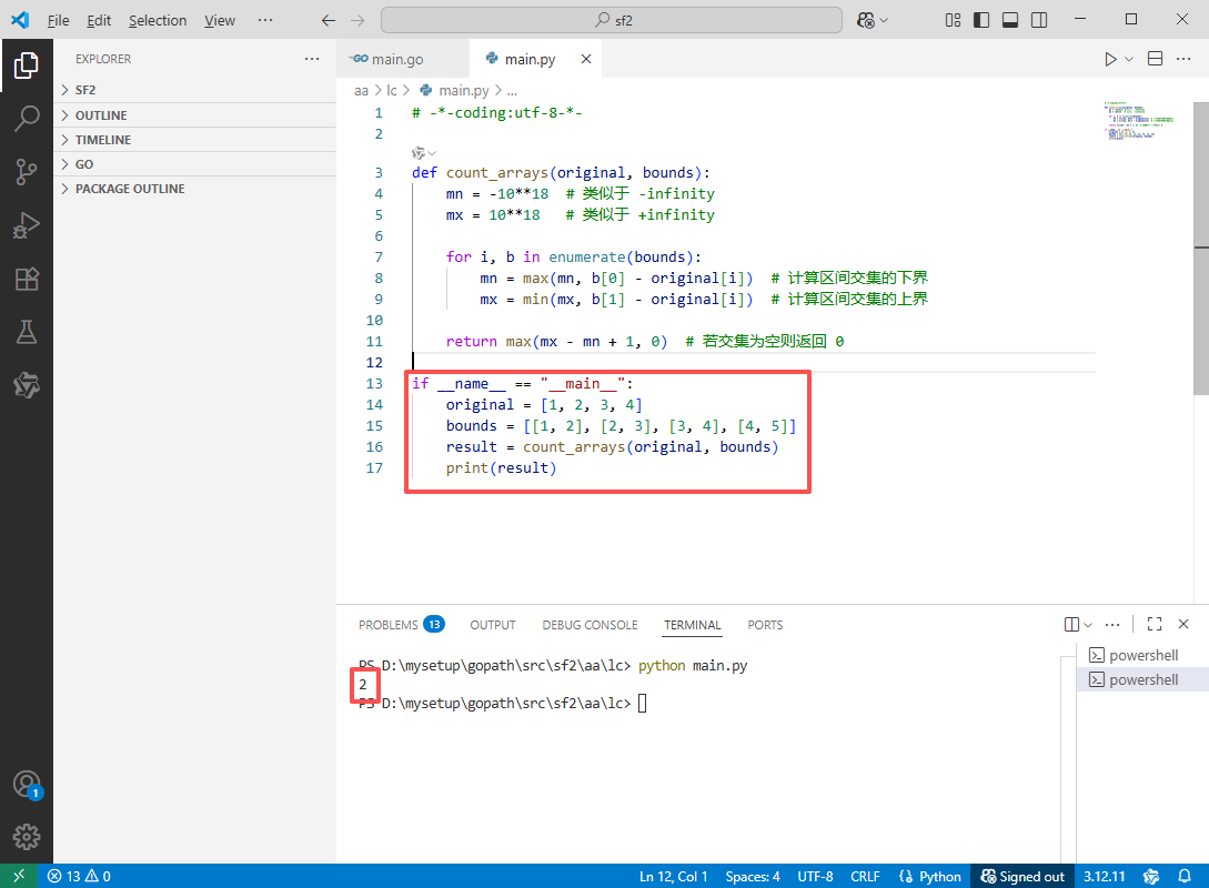

Python完整代码如下:
# -*-coding:utf-8-*-
def count_arrays(original, bounds):
mn = -10**18 # 类似于 -infinity
mx = 10**18 # 类似于 +infinity
for i, b in enumerate(bounds):
mn = max(mn, b[0] - original[i]) # 计算区间交集的下界
mx = min(mx, b[1] - original[i]) # 计算区间交集的上界
return max(mx - mn + 1, 0) # 若交集为空则返回 0
if __name__ == "__main__":
original = [1, 2, 3, 4]
bounds = [[1, 2], [2, 3], [3, 4], [4, 5]]
result = count_arrays(original, bounds)
print(result)
