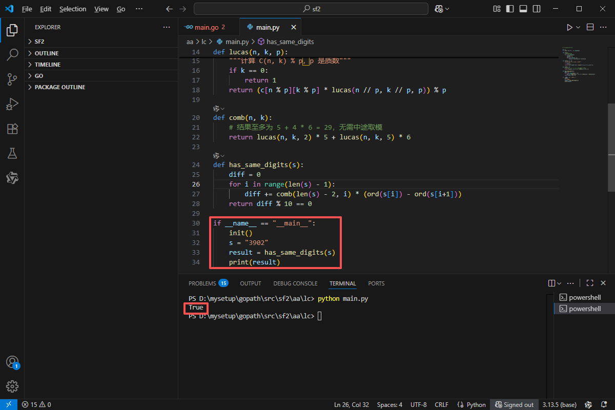

Python完整代码如下:
# -*-coding:utf-8-*-
mx = 5
c = [[0] * mx for _ in range(mx)]
def init():
    # 预处理组合数
    for i in range(mx):
        c[i][0] = 1
        c[i][i] = 1
        for j in range(1, i):
            c[i][j] = c[i-1][j-1] + c[i-1][j]
def lucas(n, k, p):
    """计算 C(n, k) % p,p 是质数"""
    if k == 0:
        return 1
    return (c[n % p][k % p] * lucas(n // p, k // p, p)) % p
def comb(n, k):
    # 结果至多为 5 + 4 * 6 = 29,无需中途取模
    return lucas(n, k, 2) * 5 + lucas(n, k, 5) * 6
def has_same_digits(s):
    diff = 0
    for i in range(len(s) - 1):
        diff += comb(len(s) - 2, i) * (ord(s[i]) - ord(s[i+1]))
    return diff % 10 == 0
if __name__ == "__main__":
    init()
    s = "3902"
    result = has_same_digits(s)
    print(result)
