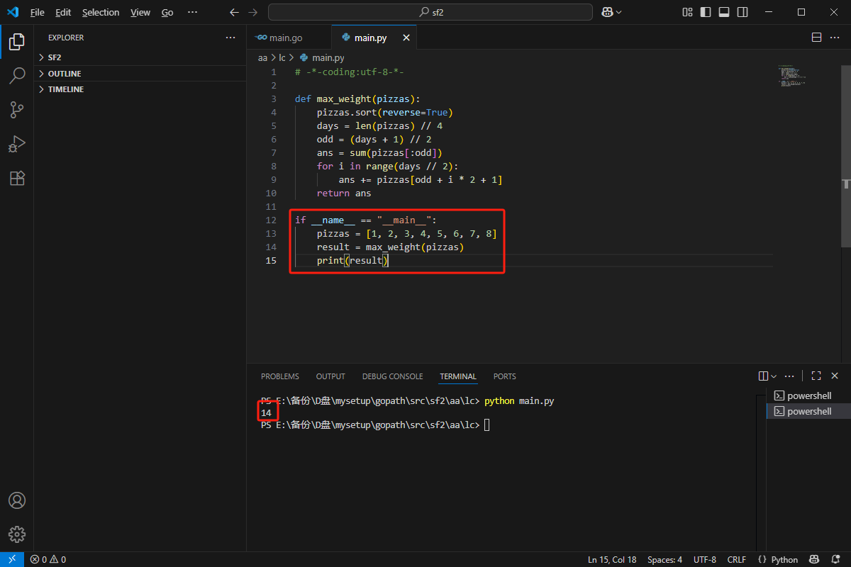

Python完整代码如下:
# -*-coding:utf-8-*-
def max_weight(pizzas):
    pizzas.sort(reverse=True)
    days = len(pizzas) // 4
    odd = (days + 1) // 2
    ans = sum(pizzas[:odd])
    for i in range(days // 2):
        ans += pizzas[odd + i * 2 + 1]
    return ans
if __name__ == "__main__":
    pizzas = [1, 2, 3, 4, 5, 6, 7, 8]
    result = max_weight(pizzas)
    print(result)
