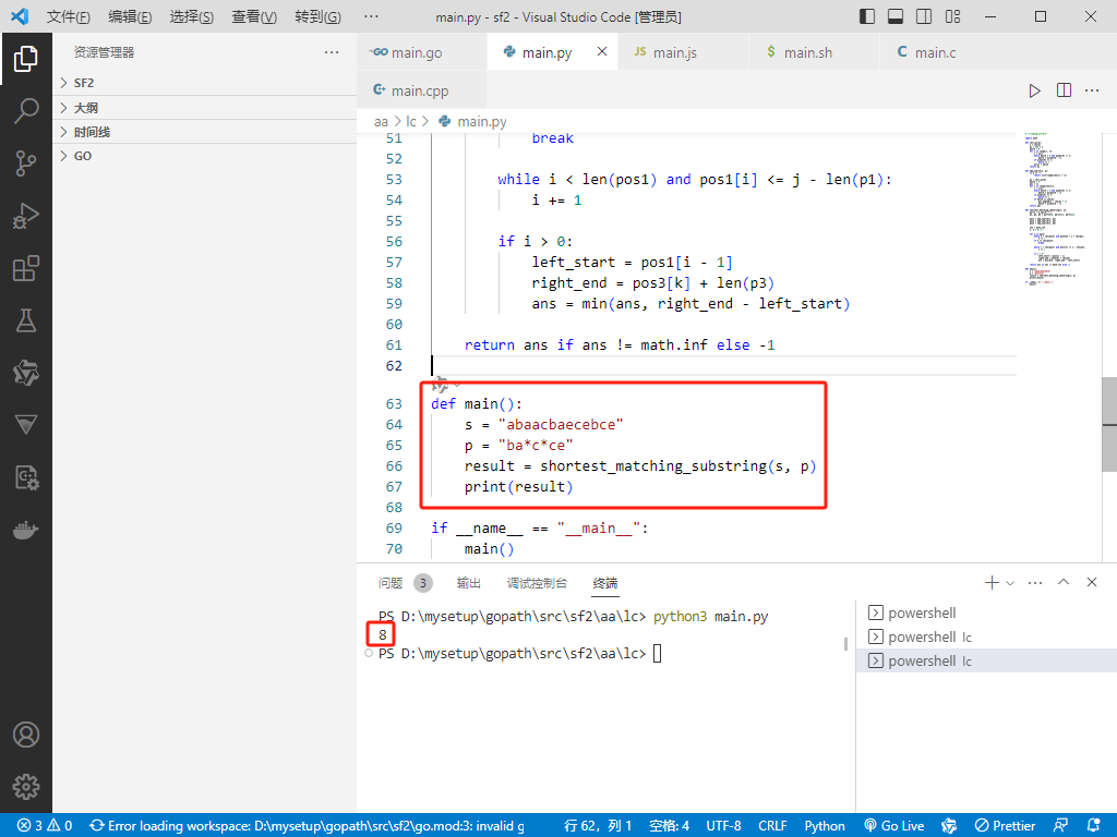

func main() {
s := "abaacbaecebce"
p := "ba*c*ce"
result := shortestMatchingSubstring(s, p)
fmt.Println(result)
Python完整代码如下:

def main():
s = "abaacbaecebce"
p = "ba*c*ce"
result = shortest_matching_substring(s, p)
print(result)
if __name__ == "__main__":
main()
