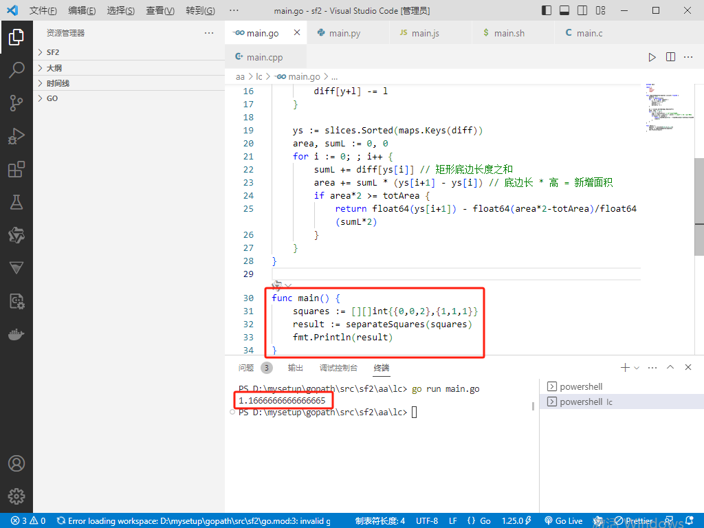

Go完整代码如下:
package main
import (
	"fmt"
	"slices"
	"maps"
func separateSquares(squares [][]int) float64 {
	totArea := 0
	diff := map[int]int{}
	for _, sq := range squares {
		y, l := sq[1], sq[2]
		totArea += l * l
		diff[y] += l
		diff[y+l] -= l
	ys := slices.Sorted(maps.Keys(diff))
	area, sumL := 0, 0
	for i := 0; ; i++ {
		sumL += diff[ys[i]] // 矩形底边长度之和
		area += sumL * (ys[i+1] - ys[i]) // 底边长 * 高 = 新增面积
		if area*2 >= totArea {
			return float64(ys[i+1]) - float64(area*2-totArea)/float64(sumL*2)
func main() {
	squares := [][]int{{0,0,2},{1,1,1}}
	result := separateSquares(squares)
	fmt.Println(result)

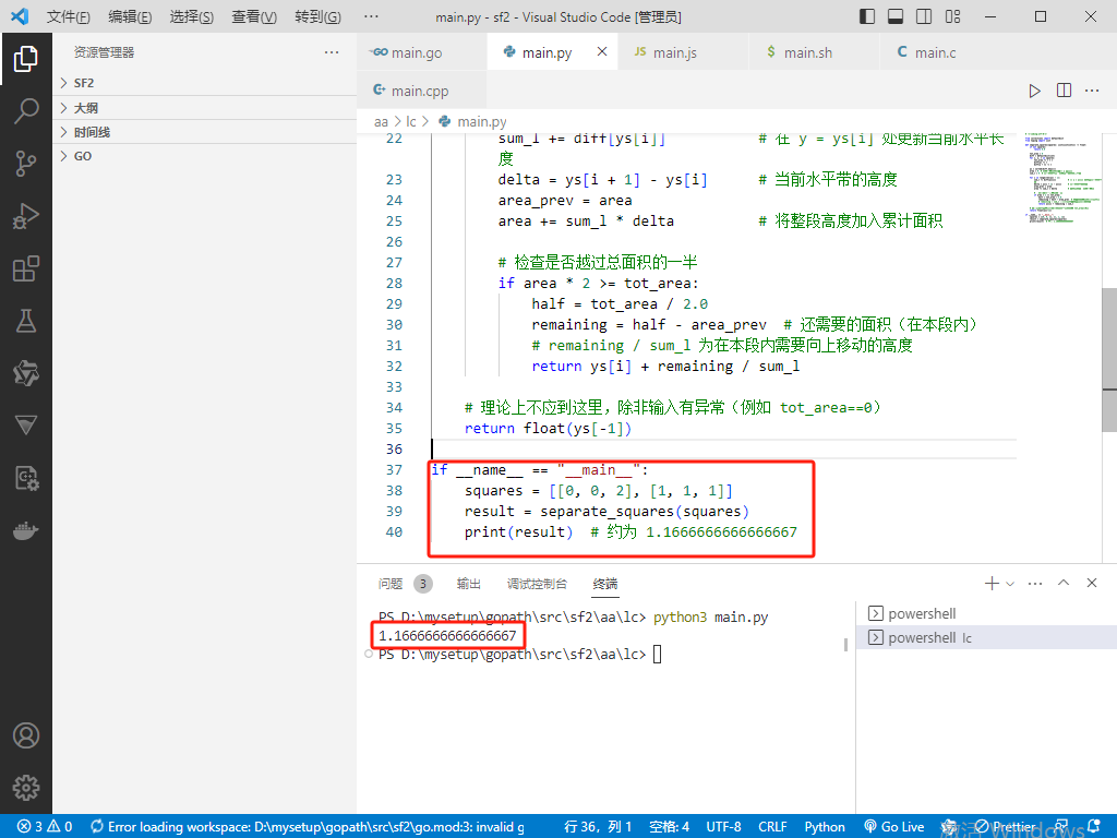

Python完整代码如下:
# -*-coding:utf-8-*-
from collections import defaultdict
from typing import List
def separate_squares(squares: List[List[int]]) -> float:
    if not squares:
        return 0.0
    tot_area = 0
    diff = defaultdict(int)
    for x, y, l in squares:
        tot_area += l * l
        diff[y] += l
        diff[y + l] -= l
    ys = sorted(diff.keys())
    area = 0  # 已累计面积(从最小 y 向上)
    sum_l = 0  # 当前水平带上所有正方形的水平总长度
    for i in range(len(ys) - 1):
        sum_l += diff[ys[i]]           # 在 y = ys[i] 处更新当前水平长度
        delta = ys[i + 1] - ys[i]      # 当前水平带的高度
        area_prev = area
        area += sum_l * delta          # 将整段高度加入累计面积
        # 检查是否越过总面积的一半
        if area * 2 >= tot_area:
            half = tot_area / 2.0
            remaining = half - area_prev  # 还需要的面积(在本段内)
            # remaining / sum_l 为在本段内需要向上移动的高度
            return ys[i] + remaining / sum_l
    # 理论上不应到这里,除非输入有异常(例如 tot_area==0)
    return float(ys[-1])
if __name__ == "__main__":
    squares = [[0, 0, 2], [1, 1, 1]]
    result = separate_squares(squares)
    print(result)  # 约为 1.1666666666666667
