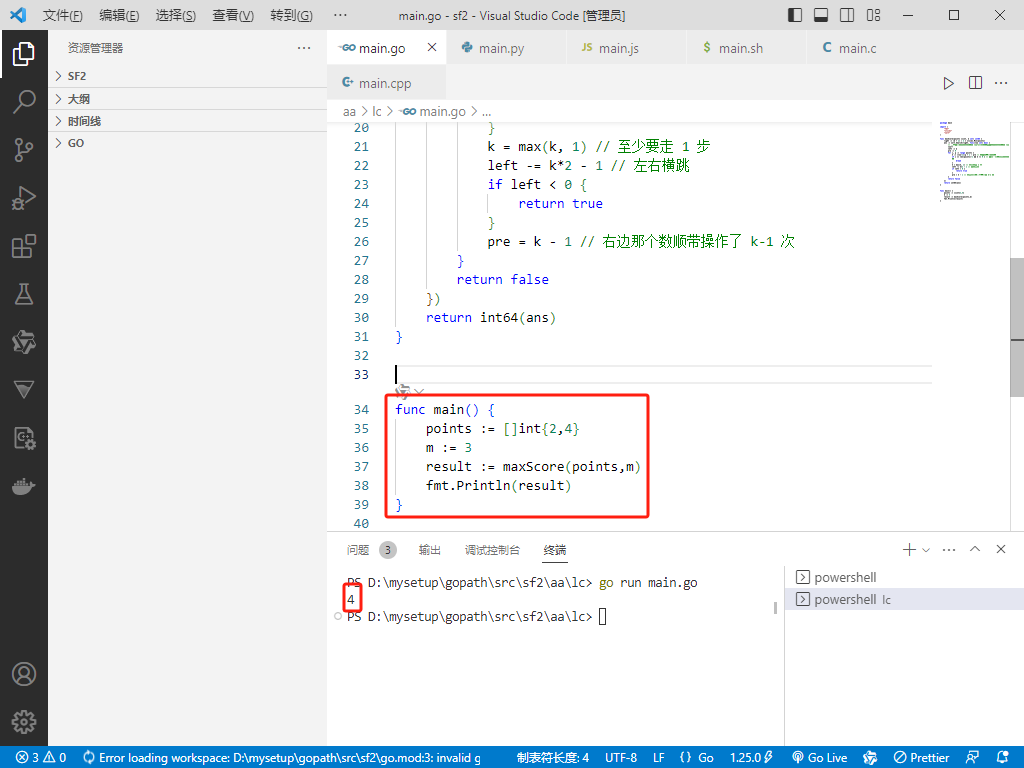

Go完整代码如下:
package main
import (
	"fmt"
	"slices"
	"sort"
func maxScore(points []int, m int) int64 {
	right := (m + 1) / 2 * slices.Min(points)
	ans := sort.Search(right, func(low int) bool {
		// 二分最小的不满足要求的 low+1,即可得到最大的满足要求的 low
		low++
		left := m
		pre := 0
		for i, p := range points {
			k := (low-1)/p + 1 - pre // 还需要操作的次数
			if i == len(points)-1 && k <= 0 { // 最后一个数已经满足要求
				break
			k = max(k, 1) // 至少要走 1 步
			left -= k*2 - 1 // 左右横跳
			if left < 0 {
				return true
			pre = k - 1 // 右边那个数顺带操作了 k-1 次
		return false
	return int64(ans)
func main() {
	points := []int{2,4}
	m := 3
	result := maxScore(points,m)
	fmt.Println(result)

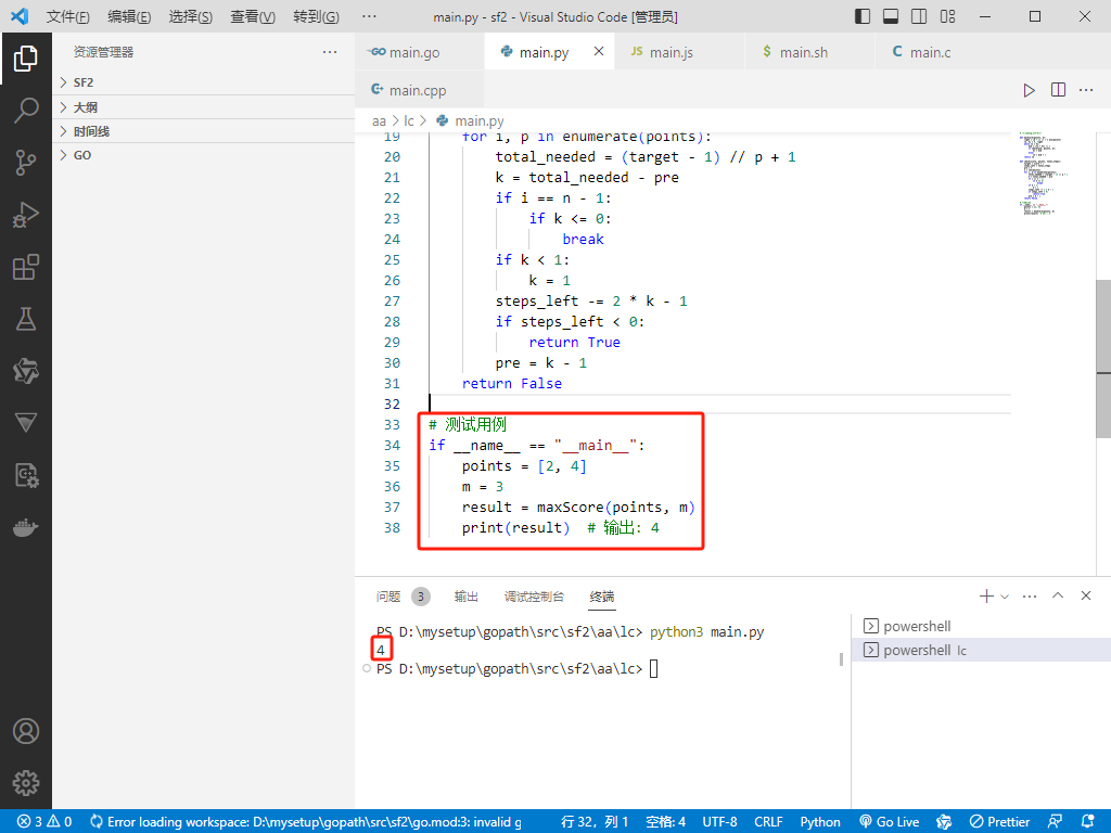

Python完整代码如下:
# -*-coding:utf-8-*-
def maxScore(points, m):
    right = (m + 1) // 2 * min(points)
    lo, hi = 0, right
    while lo < hi:
        mid = (lo + hi) // 2
        if check(mid, points, m):
            hi = mid
        else:
            lo = mid + 1
    return lo
def check(score, points, total_steps):
    target = score + 1
    steps_left = total_steps
    pre = 0
    n = len(points)
    for i, p in enumerate(points):
        total_needed = (target - 1) // p + 1
        k = total_needed - pre
        if i == n - 1:
            if k <= 0:
                break
        if k < 1:
            k = 1
        steps_left -= 2 * k - 1
        if steps_left < 0:
            return True
        pre = k - 1
    return False
# 测试用例
if __name__ == "__main__":
    points = [2, 4]
    m = 3
    result = maxScore(points, m)
    print(result)  # 输出: 4
