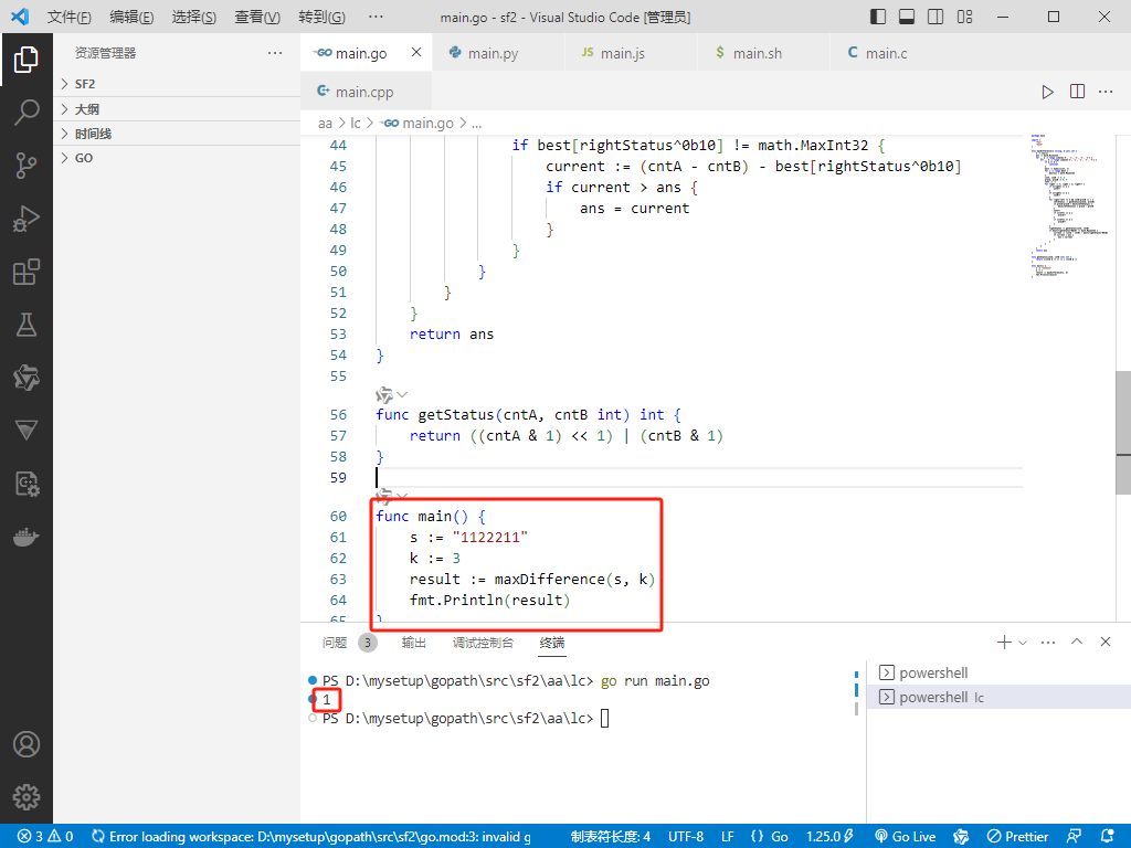

Go完整代码如下:
package main
import (
	"fmt"
	"math"
func maxDifference(s string, k int) int {
	n := len(s)
	ans := math.MinInt32
	for _, a := range []byte{'0', '1', '2', '3', '4'} {
		for _, b := range []byte{'0', '1', '2', '3', '4'} {
			if a == b {
				continue
			best := make([]int, 4)
			for i := range best {
				best[i] = math.MaxInt32
			cntA, cntB := 0, 0
			prevA, prevB := 0, 0
			left := -1
			for right := 0; right < n; right++ {
				if s[right] == a {
					cntA++
				if s[right] == b {
					cntB++
				for right-left >= k && cntB-prevB >= 2 {
					leftStatus := getStatus(prevA, prevB)
					if prevA-prevB < best[leftStatus] {
						best[leftStatus] = prevA - prevB
					left++
					if s[left] == a {
						prevA++
					if s[left] == b {
						prevB++
				rightStatus := getStatus(cntA, cntB)
				if best[rightStatus^0b10] != math.MaxInt32 {
					current := (cntA - cntB) - best[rightStatus^0b10]
					if current > ans {
						ans = current
	return ans
func getStatus(cntA, cntB int) int {
	return ((cntA & 1) << 1) | (cntB & 1)
func main() {
	s := "1122211"
	k := 3
	result := maxDifference(s, k)
	fmt.Println(result)

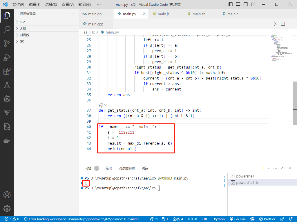

Python完整代码如下:
# -*-coding:utf-8-*-
import math
def max_difference(s: str, k: int) -> int:
    n = len(s)
    ans = -math.inf
    for a in ['0', '1', '2', '3', '4']:
        for b in ['0', '1', '2', '3', '4']:
            if a == b:
                continue
            best = [math.inf] * 4
            cnt_a, cnt_b = 0, 0
            prev_a, prev_b = 0, 0
            left = -1
            for right in range(n):
                if s[right] == a:
                    cnt_a += 1
                if s[right] == b:
                    cnt_b += 1
                while right - left >= k and cnt_b - prev_b >= 2:
                    left_status = get_status(prev_a, prev_b)
                    if prev_a - prev_b < best[left_status]:
                        best[left_status] = prev_a - prev_b
                    left += 1
                    if s[left] == a:
                        prev_a += 1
                    if s[left] == b:
                        prev_b += 1
                right_status = get_status(cnt_a, cnt_b)
                if best[right_status ^ 0b10] != math.inf:
                    current = (cnt_a - cnt_b) - best[right_status ^ 0b10]
                    if current > ans:
                        ans = current
    return ans
def get_status(cnt_a: int, cnt_b: int) -> int:
    return ((cnt_a & 1) << 1) | (cnt_b & 1)
if __name__ == "__main__":
    s = "1122211"
    k = 3
    result = max_difference(s, k)
    print(result)
