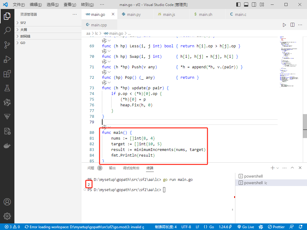

Go完整代码如下:
package main
import (
	"container/heap"
	"fmt"
	"math"
	"slices"
func minimumIncrements(nums []int, target []int) int {
	m := len(target)
	lcms := make([]int, 1<<m)
	lcms[0] = 1
	for i, t := range target {
		bit := 1 << i
		for mask, l := range lcms[:bit] {
			lcms[bit|mask] = lcm(t, l)
	maxLcm := max(slices.Max(nums)*m, slices.Max(target))
	candidateIndices := map[int]struct{}{}
	for _, l := range lcms[1:] {
		if l > maxLcm {
			continue
		h := hp{}
		for i, x := range nums {
			p := pair{(l - x%l) % l, i}
			if len(h) < m {
				heap.Push(&h, p)
			} else {
				h.update(p)
		for _, p := range h {
			candidateIndices[p.i] = struct{}{}
	f := make([]int, 1<<m)
	for j := 1; j < 1<<m; j++ {
		f[j] = math.MaxInt / 2
	for i := range candidateIndices {
		x := nums[i]
		for j := 1<<m - 1; j > 0; j-- {
			for sub := j; sub > 0; sub = (sub - 1) & j {
				l := lcms[sub]
				f[j] = min(f[j], f[j^sub]+(l-x%l)%l)
	return f[1<<m-1]
func gcd(a, b int) int {
	for a != 0 {
		a, b = b%a, a
	return b
func lcm(a, b int) int { return a / gcd(a, b) * b }
type pair struct{ op, i int }
type hp []pair
func (h hp) Len() int           { return len(h) }
func (h hp) Less(i, j int) bool { return h[i].op > h[j].op }
func (h hp) Swap(i, j int)      { h[i], h[j] = h[j], h[i] }
func (h *hp) Push(v any)        { *h = append(*h, v.(pair)) }
func (hp) Pop() (_ any)         { return }
func (h *hp) update(p pair) {
	if p.op < (*h)[0].op {
		(*h)[0] = p
		heap.Fix(h, 0)
func main() {
	nums := []int{8, 4}
	target := []int{10, 5}
	result := minimumIncrements(nums, target)
	fmt.Println(result)

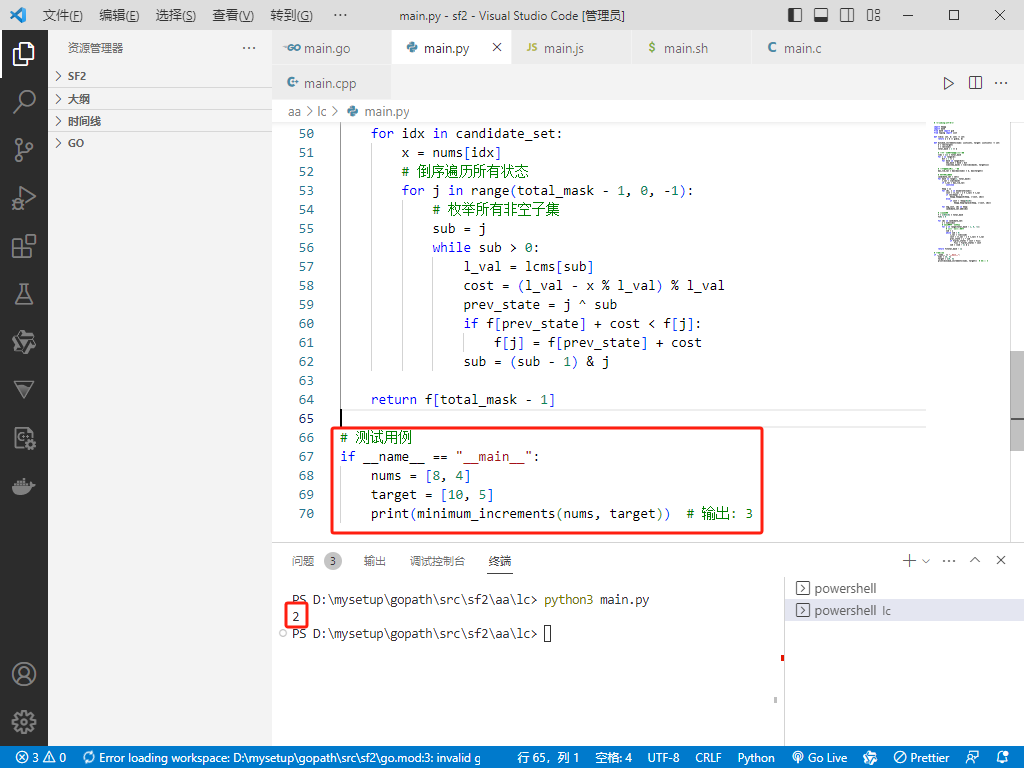

Python完整代码如下:
# -*-coding:utf-8-*-
import heapq
import math
from math import gcd
from typing import List
def lcm(a: int, b: int) -> int:
    return a * b // gcd(a, b)
def minimum_increments(nums: List[int], target: List[int]) -> int:
    m = len(target)
    n = len(nums)
    total_mask = 1 << m
    # 计算所有子集的最小公倍数
    lcms = [1] * total_mask
    for i in range(m):
        bit = 1 << i
        for mask in range(bit):
            new_mask = mask | bit
            lcms[new_mask] = lcm(lcms[mask], target[i])
    # 计算最大LCM用于过滤
    max_lcm_val = max(max(nums) * m, max(target))
    # 收集候选索引
    candidate_set = set()
    for mask in range(1, total_mask):
        l_val = lcms[mask]
        if l_val > max_lcm_val:
            continue
        heap = []
        for idx, x in enumerate(nums):
            cost = (l_val - x % l_val) % l_val
            if len(heap) < m:
                heapq.heappush(heap, (-cost, idx))
            else:
                if cost < -heap[0][0]:
                    heapq.heapreplace(heap, (-cost, idx))
        for neg_cost, idx in heap:
            candidate_set.add(idx)
    # 动态规划
    f = [10**18] * total_mask
    f[0] = 0
    for idx in candidate_set:
        x = nums[idx]
        # 倒序遍历所有状态
        for j in range(total_mask - 1, 0, -1):
            # 枚举所有非空子集
            sub = j
            while sub > 0:
                l_val = lcms[sub]
                prev_state = j ^ sub
                if f[prev_state] + cost < f[j]:
                    f[j] = f[prev_state] + cost
                sub = (sub - 1) & j
    return f[total_mask - 1]
# 测试用例
if __name__ == "__main__":
    nums = [8, 4]
    target = [10, 5]
    print(minimum_increments(nums, target))  # 输出: 3
