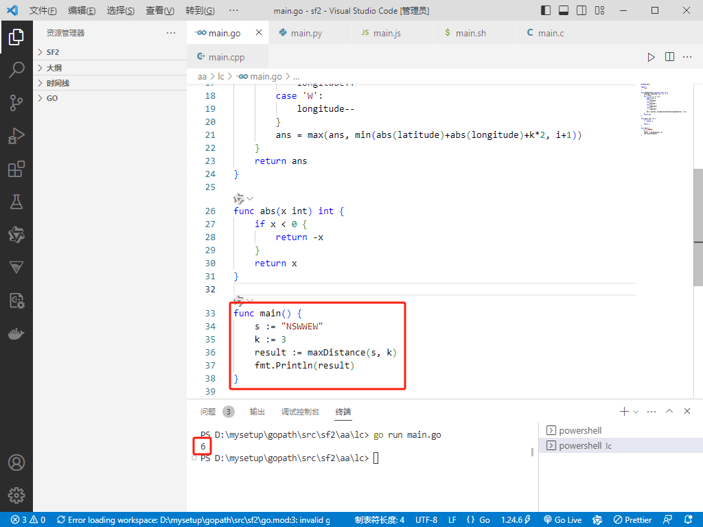

Go完整代码如下:
package main
import (
	"fmt"
func maxDistance(s string, k int) int {
	latitude, longitude, ans := 0, 0, 0
	n := len(s)
	for i := 0; i < n; i++ {
		switch s[i] {
		case 'N':
			latitude++
		case 'S':
			latitude--
		case 'E':
			longitude++
		case 'W':
			longitude--
		ans = max(ans, min(abs(latitude)+abs(longitude)+k*2, i+1))
	return ans
func abs(x int) int {
	if x < 0 {
		return -x
	return x
func main() {
	s := "NSWWEW"
	k := 3
	result := maxDistance(s, k)
	fmt.Println(result)

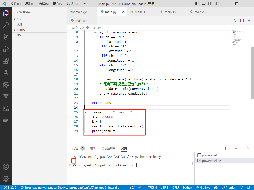

Python完整代码如下:
# -*-coding:utf-8-*-
def max_distance(s: str, k: int) -> int:
    latitude = 0
    longitude = 0
    ans = 0
    for i, ch in enumerate(s):
        if ch == 'N':
            latitude += 1
        elif ch == 'S':
            latitude -= 1
        elif ch == 'E':
            longitude += 1
        elif ch == 'W':
            longitude -= 1
        current = abs(latitude) + abs(longitude) + k * 2
        # 距离不可能超过已走的步数 i+1
        candidate = min(current, i + 1)
        ans = max(ans, candidate)
    return ans
if __name__ == "__main__":
    s = "NSWWEW"
    k = 3
    result = max_distance(s, k)
    print(result)
