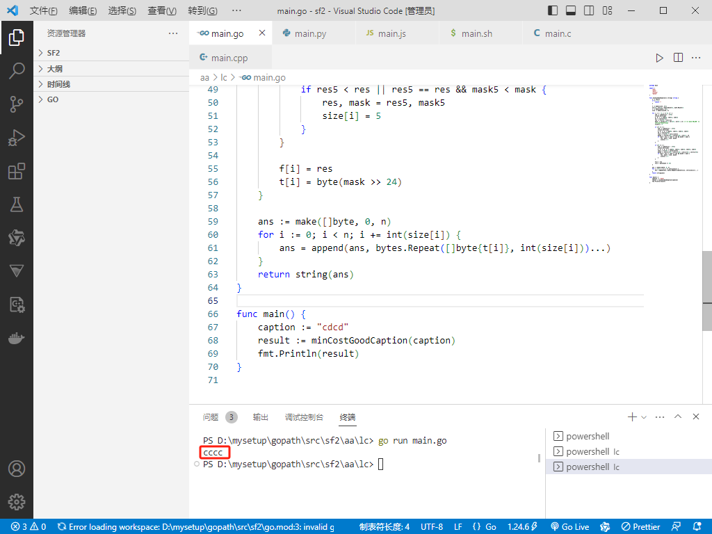

Go完整代码如下:
package main
import (
	"fmt"
	"math"
	"slices"
	"bytes"
func minCostGoodCaption(s string) string {
	n := len(s)
	if n < 3 {
		return ""
	f := make([]int, n+1)
	f[n-1], f[n-2] = math.MaxInt/2, math.MaxInt/2
	t := make([]byte, n+1)
	size := make([]uint8, n)
	for i := n - 3; i >= 0; i-- {
		sub := []byte(s[i : i+3])
		slices.Sort(sub)
		a, b, c := sub[0], sub[1], sub[2]
		s3 := int(t[i+3])
		res := f[i+3] + int(c-a)
		mask := int(b)<<24 | s3<<16 | s3<<8 | s3 // 4 个 byte 压缩成一个 int,方便比较字典序
		size[i] = 3
		if i+4 <= n {
			sub := []byte(s[i : i+4])
			slices.Sort(sub)
			a, b, c, d := sub[0], sub[1], sub[2], sub[3]
			s4 := int(t[i+4])
			res4 := f[i+4] + int(c-a+d-b)
			mask4 := int(b)<<24 | int(b)<<16 | s4<<8 | s4
			if res4 < res || res4 == res && mask4 < mask {
				res, mask = res4, mask4
				size[i] = 4
		if i+5 <= n {
			sub := []byte(s[i : i+5])
			slices.Sort(sub)
			a, b, c, d, e := sub[0], sub[1], sub[2], sub[3], sub[4]
			res5 := f[i+5] + int(d-a+e-b)
			mask5 := int(c)<<24 | int(c)<<16 | int(c)<<8 | int(t[i+5])
			if res5 < res || res5 == res && mask5 < mask {
				res, mask = res5, mask5
				size[i] = 5
		f[i] = res
		t[i] = byte(mask >> 24)
	ans := make([]byte, 0, n)
	for i := 0; i < n; i += int(size[i]) {
		ans = append(ans, bytes.Repeat([]byte{t[i]}, int(size[i]))...)
	return string(ans)
func main() {
	caption := "cdcd"
	result := minCostGoodCaption(caption)
	fmt.Println(result)

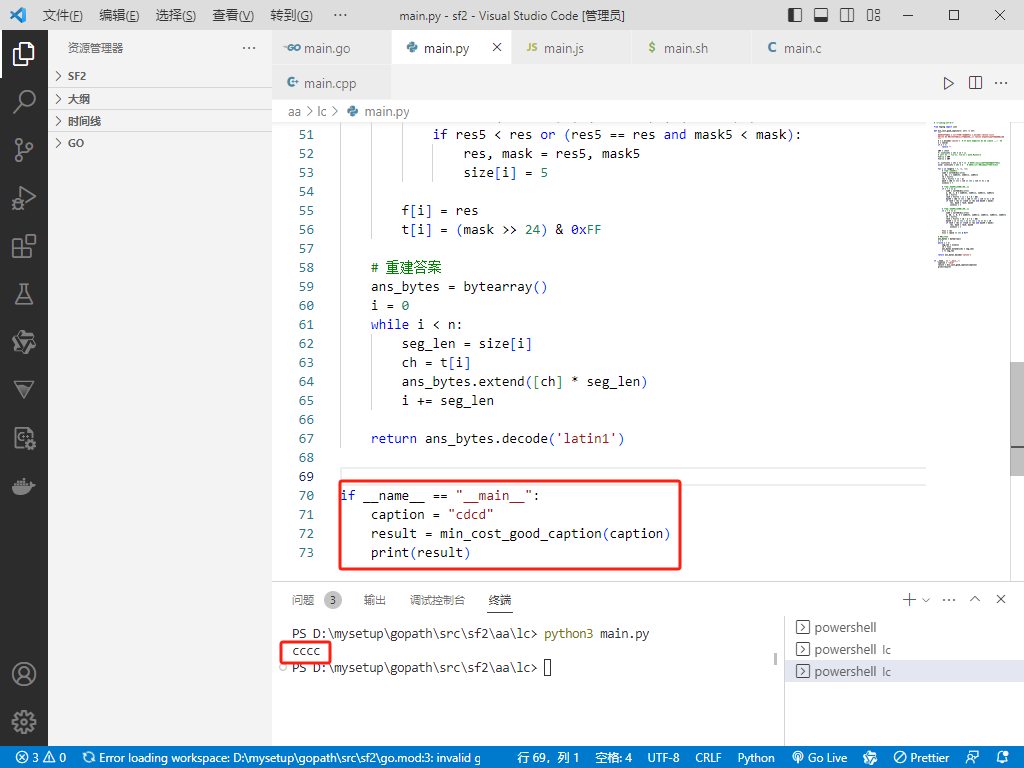

Python完整代码如下:
# -*-coding:utf-8-*-
from typing import List
def min_cost_good_caption(s: str) -> str:
    将输入字符串 s 当作字节流处理(按 s.encode('latin1')),
    返回与 Go 版本等价的结果字符串(使用 latin1 解码以保持字节不变)。
    b = s.encode('latin1')  # 以 byte 处理,与 Go 的 []byte 行为一致
    n = len(b)
    if n < 3:
        return ""
    INF = 10**9
    f: List[int] = [0] * (n + 1)
    # 模拟 Go 中 f[n-1], f[n-2] = math.MaxInt/2
    f[n-1] = INF
    f[n-2] = INF
    t: List[int] = [0] * (n + 1)  # 存储每段选定的字符(最高字节)
    size: List[int] = [0] * n    # 存储每个位置选的段长(3/4/5)
    for i in range(n - 3, -1, -1):
        # 长度为3的候选
        sub3 = sorted(b[i:i+3])
        a, bb, c = sub3[0], sub3[1], sub3[2]
        s3 = t[i+3]
        res = f[i+3] + (c - a)
        mask = (bb << 24) | (s3 << 16) | (s3 << 8) | s3
        size[i] = 3
        # 长度为4的候选(如果可行)
        if i + 4 <= n:
            sub4 = sorted(b[i:i+4])
            a, bb, c, d = sub4[0], sub4[1], sub4[2], sub4[3]
            s4 = t[i+4]
            res4 = f[i+4] + (c - a + d - bb)
            mask4 = (bb << 24) | (bb << 16) | (s4 << 8) | s4
            if res4 < res or (res4 == res and mask4 < mask):
                size[i] = 4
        # 长度为5的候选(如果可行)
        if i + 5 <= n:
            sub5 = sorted(b[i:i+5])
            a, bb, c, d, e = sub5[0], sub5[1], sub5[2], sub5[3], sub5[4]
            s5 = t[i+5]
            res5 = f[i+5] + (d - a + e - bb)
            mask5 = (c << 24) | (c << 16) | (c << 8) | s5
            if res5 < res or (res5 == res and mask5 < mask):
                size[i] = 5
        f[i] = res
        t[i] = (mask >> 24) & 0xFF
    # 重建答案
    ans_bytes = bytearray()
    i = 0
    while i < n:
        seg_len = size[i]
        ch = t[i]
        ans_bytes.extend([ch] * seg_len)
        i += seg_len
    return ans_bytes.decode('latin1')
if __name__ == "__main__":
    caption = "cdcd"
    result = min_cost_good_caption(caption)
    print(result)
