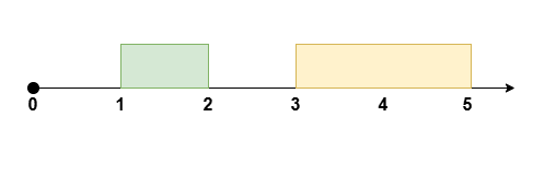

输入:eventTime = 5, startTime = [1,3], endTime = [2,5]。
输出:2。
解释:
将 [1, 2] 的会议安排到 [2, 3] ,得到空余时间 [0, 2] 。
题目来自力扣3440。

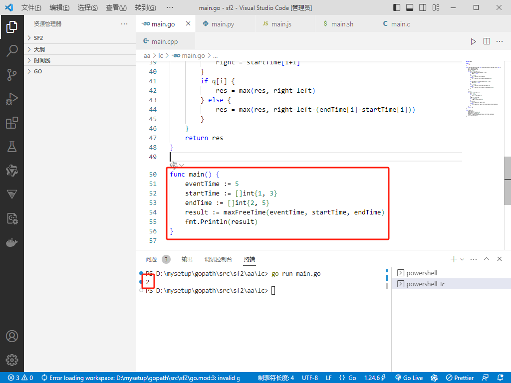

Go完整代码如下:
package main
import (
	"fmt"
func maxFreeTime(eventTime int, startTime []int, endTime []int) int {
	n := len(startTime)
	q := make([]bool, n)
	t1, t2 := 0, 0
	for i := 0; i < n; i++ {
		if endTime[i]-startTime[i] <= t1 {
			q[i] = true
		if i == 0 {
			t1 = max(t1, startTime[i])
		} else {
			t1 = max(t1, startTime[i]-endTime[i-1])
		if endTime[n-i-1]-startTime[n-i-1] <= t2 {
			q[n-i-1] = true
		if i == 0 {
			t2 = max(t2, eventTime-endTime[n-1])
		} else {
			t2 = max(t2, startTime[n-i]-endTime[n-i-1])
	res := 0
		left := 0
		if i != 0 {
			left = endTime[i-1]
		right := eventTime
		if i != n-1 {
			right = startTime[i+1]
		if q[i] {
			res = max(res, right-left)
		} else {
			res = max(res, right-left-(endTime[i]-startTime[i]))
	return res
func main() {
	eventTime := 5
	startTime := []int{1, 3}
	endTime := []int{2, 5}
	result := maxFreeTime(eventTime, startTime, endTime)
	fmt.Println(result)

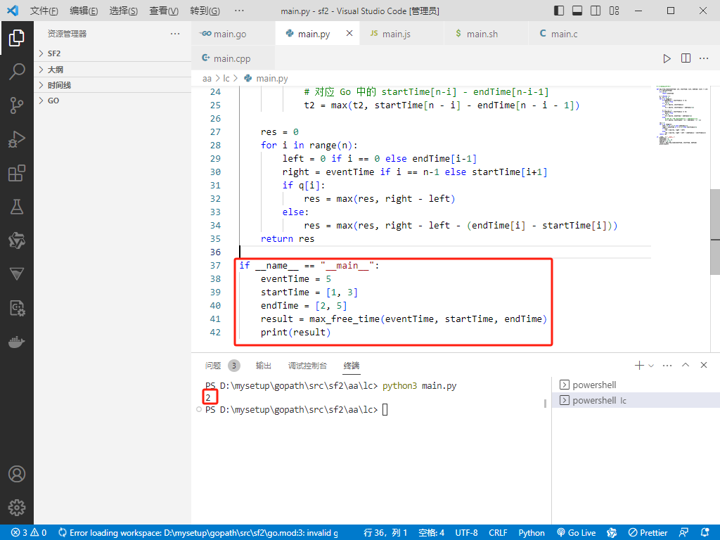

Python完整代码如下:
# -*-coding:utf-8-*-
def max_free_time(eventTime: int, startTime: list, endTime: list) -> int:
    n = len(startTime)
    if n == 0:
        return eventTime
    q = [False] * n
    t1, t2 = 0, 0
    for i in range(n):
        if endTime[i] - startTime[i] <= t1:
            q[i] = True
        if i == 0:
        else:
            t1 = max(t1, startTime[i] - endTime[i-1])
        j = n - i - 1
        if endTime[j] - startTime[j] <= t2:
            q[j] = True
        if i == 0:
            t2 = max(t2, eventTime - endTime[n-1])
        else:
            # 对应 Go 中的 startTime[n-i] - endTime[n-i-1]
            t2 = max(t2, startTime[n - i] - endTime[n - i - 1])
    res = 0
    for i in range(n):
        left = 0 if i == 0 else endTime[i-1]
        right = eventTime if i == n-1 else startTime[i+1]
        if q[i]:
            res = max(res, right - left)
        else:
            res = max(res, right - left - (endTime[i] - startTime[i]))
    return res
if __name__ == "__main__":
    eventTime = 5
    startTime = [1, 3]
    endTime = [2, 5]
    result = max_free_time(eventTime, startTime, endTime)
    print(result)
