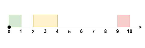

初始的会议时间区间是:
  1. 会议 0: [0, 1]
  2. 会议 1: [2, 4]
  3. 会议 2: [9, 10]
初始的空闲时间是:
  • 会议 0 和会议 1 之间:1 (即 1 到 2)
  • 会议 1 和会议 2 之间:5 (即 4 到 9)
  • 会议 2 之后:0 (因为活动已经结束)
最大空闲时间是 5。

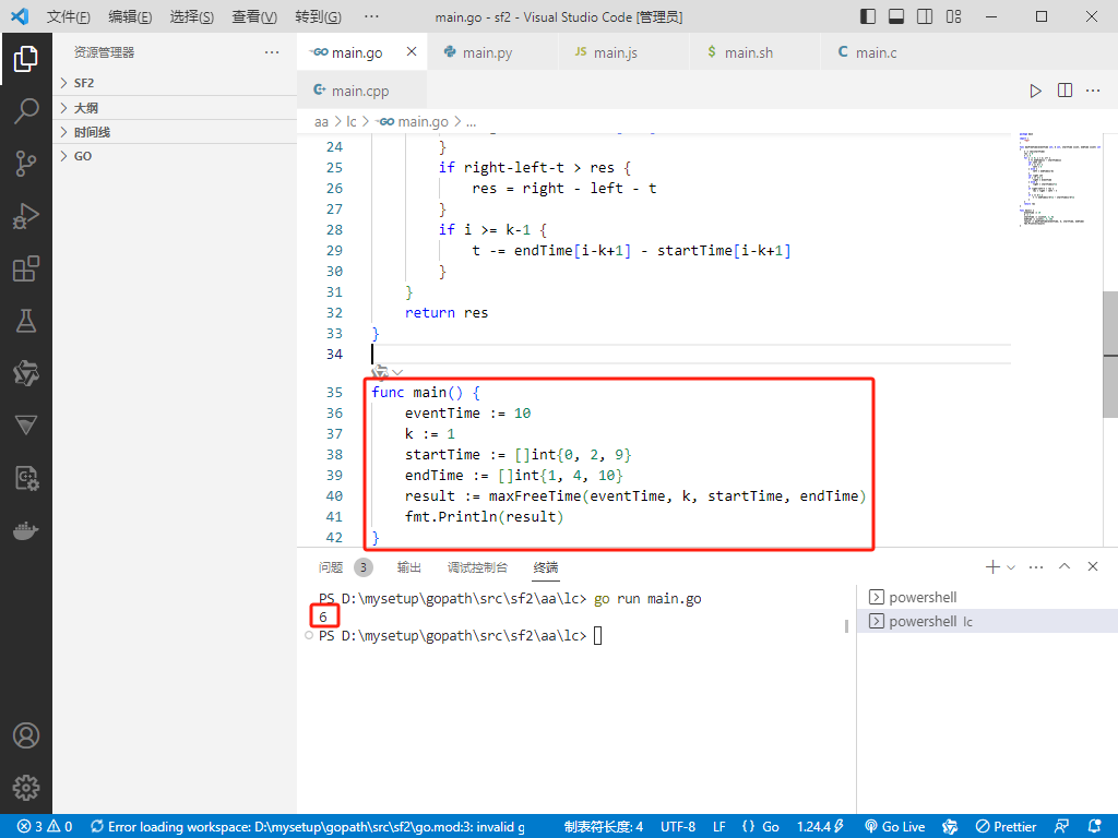

Go完整代码如下:
package main
import (
	"fmt"
func maxFreeTime(eventTime int, k int, startTime []int, endTime []int) int {
	n := len(startTime)
	res := 0
	t := 0
	for i := 0; i < n; i++ {
		t += endTime[i] - startTime[i]
		var left int
		if i <= k-1 {
			left = 0
		} else {
			left = endTime[i-k]
		var right int
		if i == n-1 {
			right = eventTime
		} else {
			right = startTime[i+1]
		if right-left-t > res {
			res = right - left - t
		if i >= k-1 {
			t -= endTime[i-k+1] - startTime[i-k+1]
	return res
func main() {
	eventTime := 10
	k := 1
	startTime := []int{0, 2, 9}
	endTime := []int{1, 4, 10}
	result := maxFreeTime(eventTime, k, startTime, endTime)
	fmt.Println(result)

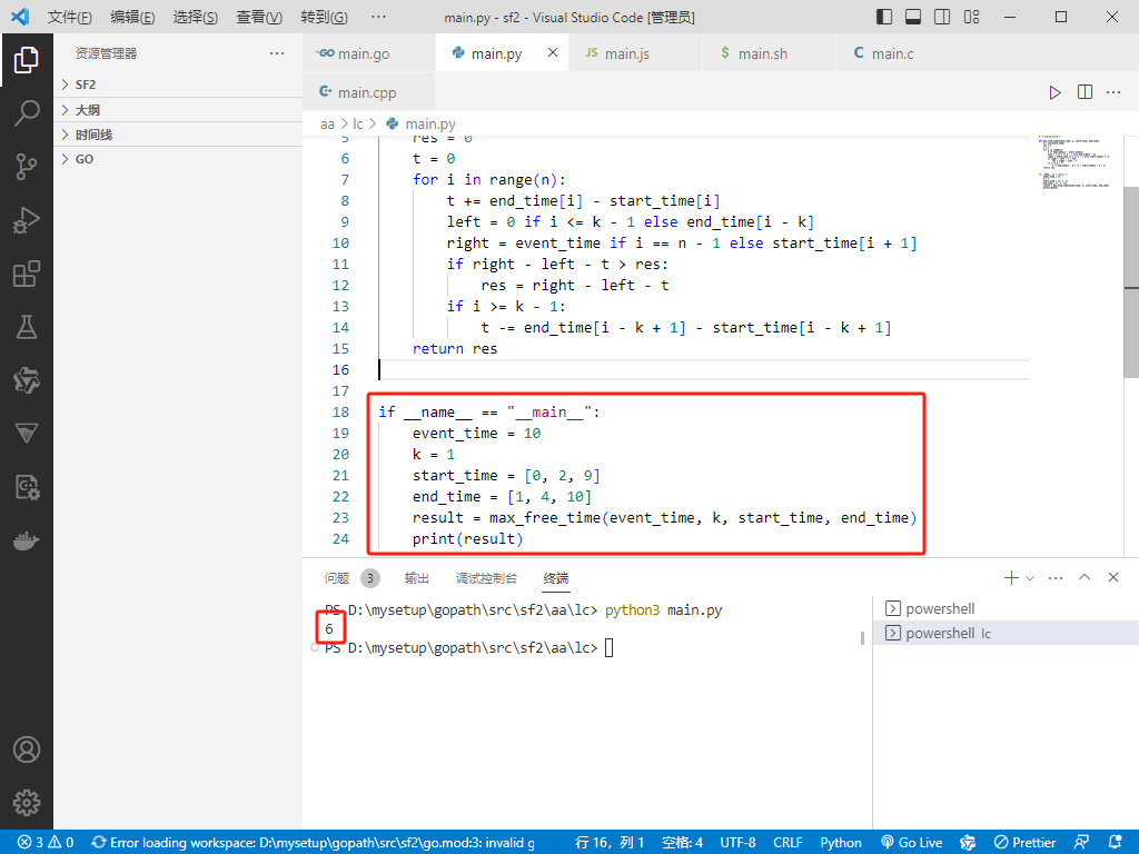

Python完整代码如下:
# -*-coding:utf-8-*-
def max_free_time(event_time, k, start_time, end_time):
    n = len(start_time)
    res = 0
    t = 0
    for i in range(n):
        t += end_time[i] - start_time[i]
        left = 0 if i <= k - 1 else end_time[i - k]
        right = event_time if i == n - 1 else start_time[i + 1]
        if right - left - t > res:
        if i >= k - 1:
            t -= end_time[i - k + 1] - start_time[i - k + 1]
    return res
if __name__ == "__main__":
    event_time = 10
    k = 1
    start_time = [0, 2, 9]
    end_time = [1, 4, 10]
    result = max_free_time(event_time, k, start_time, end_time)
    print(result)
