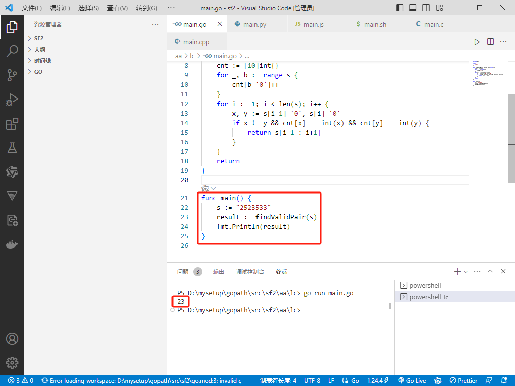

Go完整代码如下:
package main
import (
	"fmt"
func findValidPair(s string) (ans string) {
	cnt := [10]int{}
	for _, b := range s {
		cnt[b-'0']++
	for i := 1; i < len(s); i++ {
		x, y := s[i-1]-'0', s[i]-'0'
		if x != y && cnt[x] == int(x) && cnt[y] == int(y) {
			return s[i-1 : i+1]
	return
func main() {
	s := "2523533"
	result := findValidPair(s)
	fmt.Println(result)

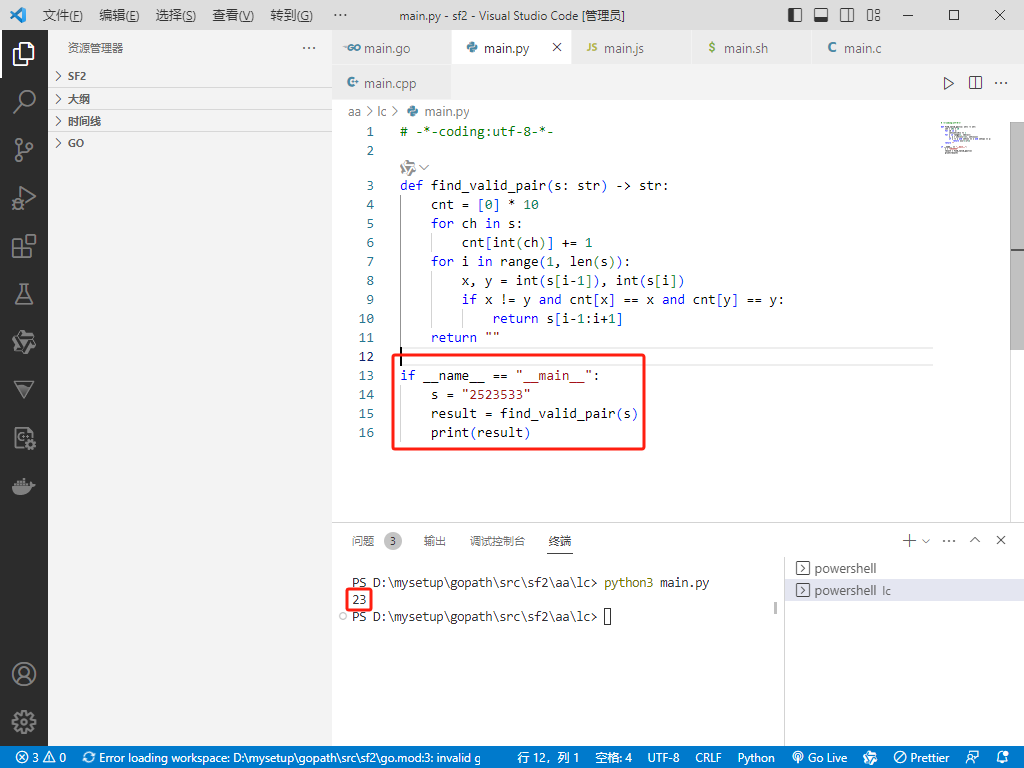

Python完整代码如下:
# -*-coding:utf-8-*-
def find_valid_pair(s: str) -> str:
    cnt = [0] * 10
    for ch in s:
        cnt[int(ch)] += 1
    for i in range(1, len(s)):
        x, y = int(s[i-1]), int(s[i])
        if x != y and cnt[x] == x and cnt[y] == y:
            return s[i-1:i+1]
    return ""
if __name__ == "__main__":
    s = "2523533"
    result = find_valid_pair(s)
    print(result)
