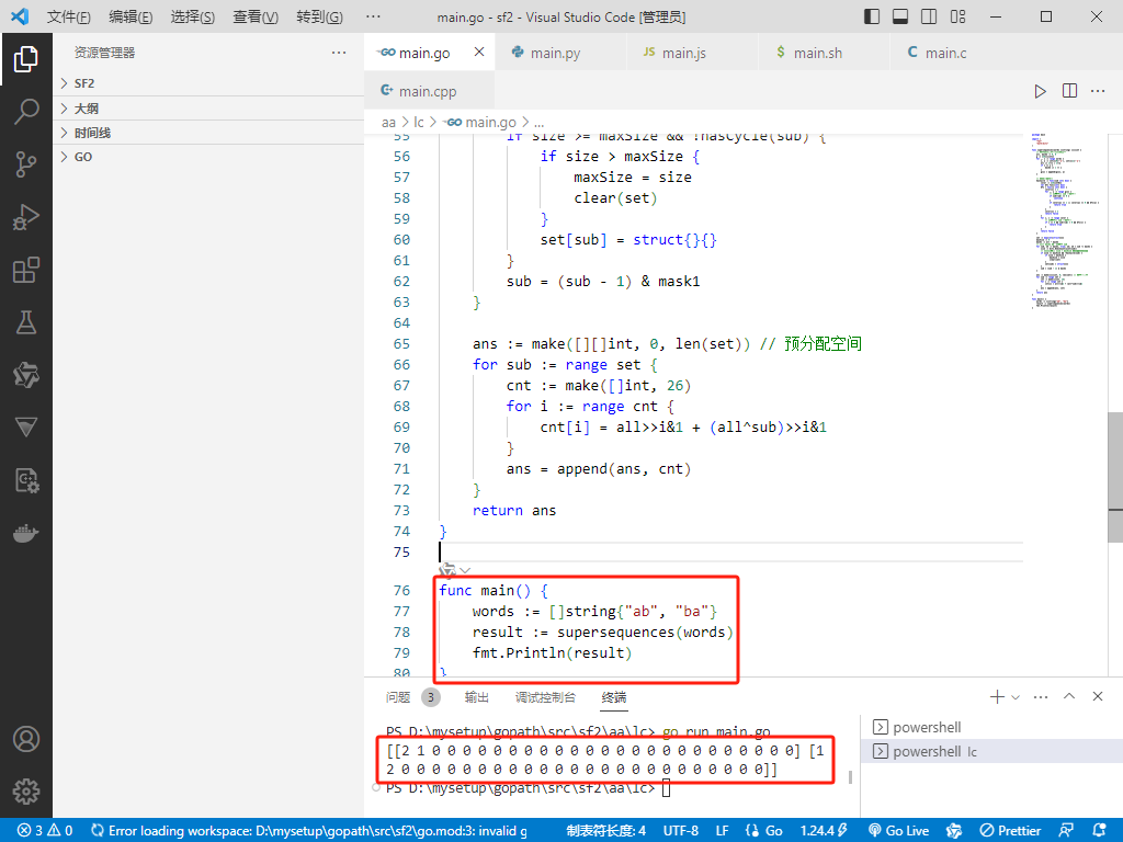

Go完整代码如下:
package main
import (
	"fmt"
	"math/bits"
func supersequences(words []string) [][]int {
	// 收集有哪些字母,同时建图
	all, mask2 := 0, 0
	g := [26][]int{}
	for _, s := range words {
		x, y := int(s[0]-'a'), int(s[1]-'a')
		all |= 1<<x | 1<<y
		if x == y {
			mask2 |= 1 << x
		g[x] = append(g[x], y)
	// 判断是否有环
	hasCycle := func(sub int) bool {
		color := [26]int8{}
		var dfs func(int) bool
		dfs = func(x int) bool {
			color[x] = 1
			for _, y := range g[x] {
				// 只遍历在 sub 中的字母
				if sub>>y&1 == 0 {
					continue
				if color[y] == 1 || color[y] == 0 && dfs(y) {
					return true
			color[x] = 2
			return false
		for i, c := range color {
			// 只遍历在 sub 中的字母
			if c == 0 && sub>>i&1 > 0 && dfs(i) {
				return true
		return false
	set := map[int]struct{}{}
	maxSize := 0
	mask1 := all ^ mask2
	// 枚举 mask1 的所有子集 sub
	for sub, ok := mask1, true; ok; ok = sub != mask1 {
		size := bits.OnesCount(uint(sub))
		// 剪枝:如果 size < maxSize 就不需要判断了
		if size >= maxSize && !hasCycle(sub) {
			if size > maxSize {
				maxSize = size
				clear(set)
			set[sub] = struct{}{}
		sub = (sub - 1) & mask1
	ans := make([][]int, 0, len(set)) // 预分配空间
	for sub := range set {
		cnt := make([]int, 26)
		for i := range cnt {
			cnt[i] = all>>i&1 + (all^sub)>>i&1
		ans = append(ans, cnt)
	return ans
func main() {
	words := []string{"ab", "ba"}
	result := supersequences(words)
	fmt.Println(result)

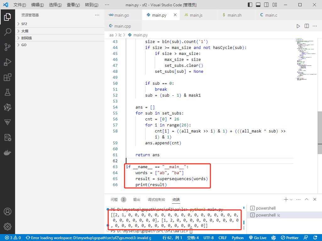

Python完整代码如下:
# -*-coding:utf-8-*-
from typing import List
def supersequences(words: List[str]) -> List[List[int]]:
    # 收集所有出现过的字母,以及构建有向图
    all_mask = 0
    mask2 = 0
    g = [[] for _ in range(26)]
    for s in words:
        x, y = ord(s[0]) - ord('a'), ord(s[1]) - ord('a')
        all_mask |= (1 << x) | (1 << y)
        if x == y:
            mask2 |= (1 << x)
        g[x].append(y)
    def hasCycle(sub: int) -> bool:
        color = [0] * 26  # 0=未访问, 1=访问中, 2=已访问
        def dfs(u: int) -> bool:
            color[u] = 1
            for v in g[u]:
                if (sub >> v) & 1 == 0:
                    continue
                if color[v] == 1 or (color[v] == 0 and dfs(v)):
                    return True
            color[u] = 2
            return False
        for i in range(26):
            if ((sub >> i) & 1) and color[i] == 0:
                if dfs(i):
                    return True
        return False
    set_subs = {}
    max_size = 0
    mask1 = all_mask ^ mask2
    # 枚举 mask1 的所有子集
    sub = mask1
    while True:
        size = bin(sub).count('1')
        if size >= max_size and not hasCycle(sub):
            if size > max_size:
                max_size = size
                set_subs.clear()
            set_subs[sub] = None
        if sub == 0:
            break
    ans = []
    for sub in set_subs:
        cnt = [0] * 26
        for i in range(26):
            cnt[i] = ((all_mask >> i) & 1) + (((all_mask ^ sub) >> i) & 1)
        ans.append(cnt)
    return ans
if __name__ == "__main__":
    words = ["ab", "ba"]
    result = supersequences(words)
    print(result)
