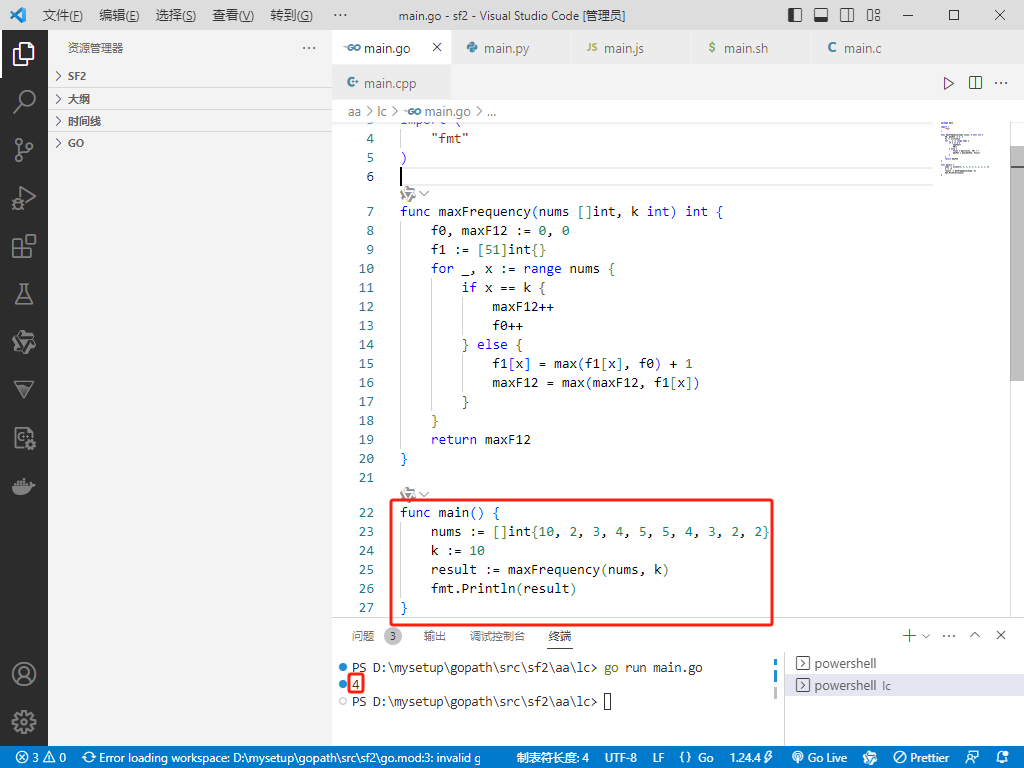

Go完整代码如下:
package main
import (
	"fmt"
func maxFrequency(nums []int, k int) int {
	f0, maxF12 := 0, 0
	f1 := [51]int{}
	for _, x := range nums {
		if x == k {
			maxF12++
			f0++
		} else {
			f1[x] = max(f1[x], f0) + 1
			maxF12 = max(maxF12, f1[x])
	return maxF12
func main() {
	nums := []int{10, 2, 3, 4, 5, 5, 4, 3, 2, 2}
	k := 10
	result := maxFrequency(nums, k)
	fmt.Println(result)

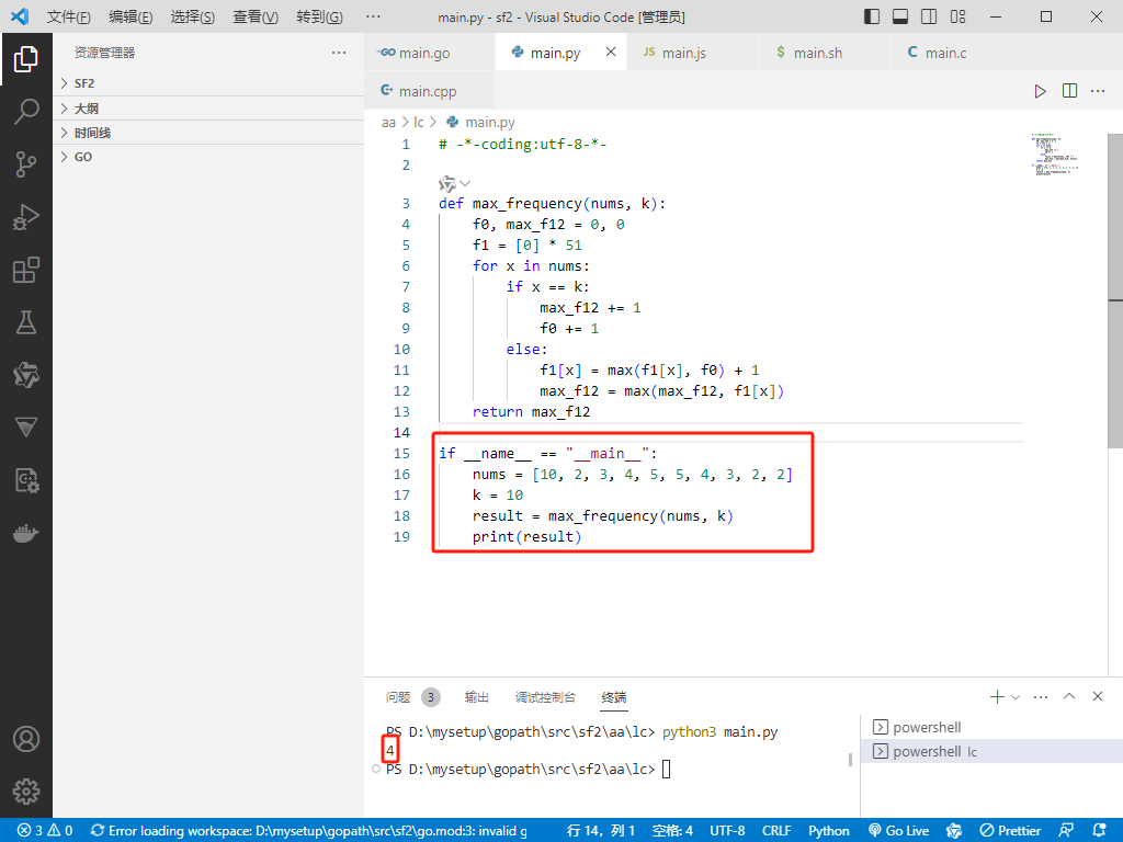

Python完整代码如下:
# -*-coding:utf-8-*-
def max_frequency(nums, k):
    f0, max_f12 = 0, 0
    f1 = [0] * 51
    for x in nums:
        if x == k:
            max_f12 += 1
            f0 += 1
        else:
            max_f12 = max(max_f12, f1[x])
    return max_f12
if __name__ == "__main__":
    nums = [10, 2, 3, 4, 5, 5, 4, 3, 2, 2]
    k = 10
    result = max_frequency(nums, k)
    print(result)
