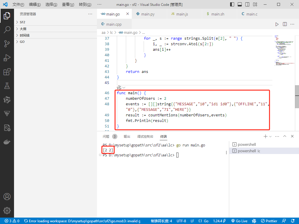

Go完整代码如下:
package main
import (
	"fmt"
	"strconv"
	"strings"
	"cmp"
	"slices"
func countMentions(numberOfUsers int, events [][]string) []int {
	// 按照时间戳从小到大排序,时间戳相同的,离线事件排在前面
	slices.SortFunc(events, func(a, b []string) int {
		ta, _ := strconv.Atoi(a[1])
		tb, _ := strconv.Atoi(b[1])
		return cmp.Or(ta-tb, int(b[0][0])-int(a[0][0]))
	ans := make([]int, numberOfUsers)
	onlineT := make([]int, numberOfUsers)
	for _, e := range events {
		curT, _ := strconv.Atoi(e[1])
		if e[0][0] == 'O' {
			i, _ := strconv.Atoi(e[2])
			onlineT[i] = curT + 60
		} else if e[2][0] == 'A' {
			for i := range ans {
				ans[i]++
		} else if e[2][0] == 'H' {
			for i, t := range onlineT {
				if t <= curT { // 在线
					ans[i]++
		} else {
			for _, s := range strings.Split(e[2], " ") {
				i, _ := strconv.Atoi(s[2:])
				ans[i]++
	return ans
func main() {
	numberOfUsers := 2
	events := [][]string{{"MESSAGE","10","id1 id0"},{"OFFLINE","11","0"},{"MESSAGE","71","HERE"}}
	result := countMentions(numberOfUsers,events)
	fmt.Println(result)

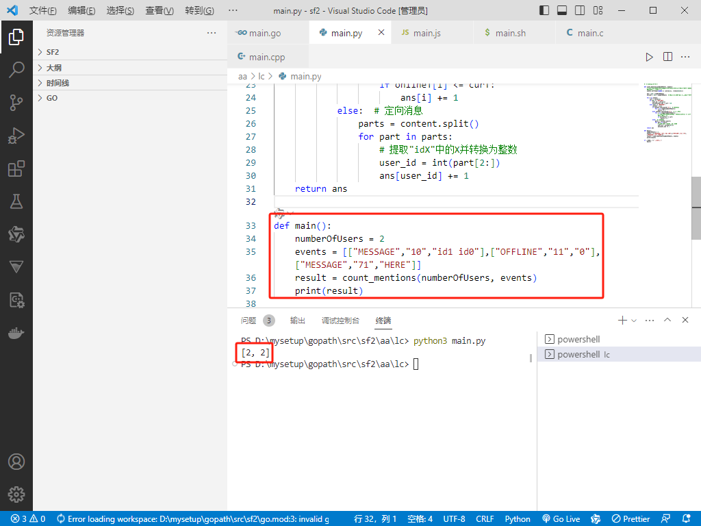

Python完整代码如下:
# -*-coding:utf-8-*-
def count_mentions(numberOfUsers, events):
    # 排序事件:首先按时间戳升序,时间戳相同时,按事件类型首字母的ASCII值降序(即离线事件在前)
    events.sort(key=lambda e: (int(e[1]), -ord(e[0][0])))
    ans = [0] * numberOfUsers
    onlineT = [0] * numberOfUsers  # 记录每个用户被视为在线的截止时间戳
    for e in events:
        curT = int(e[1])
        if e[0] == "OFFLINE":
            user_id = int(e[2])
            onlineT[user_id] = curT + 60
        elif e[0] == "MESSAGE":
            content = e[2]
            if content.startswith('A'):  # 全体消息
                for i in range(numberOfUsers):
                    ans[i] += 1
            elif content.startswith('H'):  # 在线消息
                    # 注意:这里条件与Go代码一致(onlineT[i] <= curT 表示用户在线)
                    if onlineT[i] <= curT:
                        ans[i] += 1
            else:  # 定向消息
                parts = content.split()
                for part in parts:
                    # 提取"idX"中的X并转换为整数
                    user_id = int(part[2:])
                    ans[user_id] += 1
    return ans
def main():
    numberOfUsers = 2
    events = [["MESSAGE","10","id1 id0"],["OFFLINE","11","0"],["MESSAGE","71","HERE"]]
    result = count_mentions(numberOfUsers, events)
    print(result)
if __name__ == "__main__":
    main()
