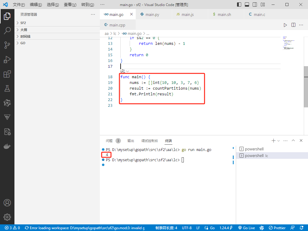

Go完整代码如下:
package main
import (
"fmt"
func countPartitions(nums []int) int {
s := 0
for _, x := range nums {
s += x
if s%2 == 0 {
return len(nums) - 1
return 0
func main() {
nums := []int{10, 10, 3, 7, 6}
result := countPartitions(nums)
fmt.Println(result)

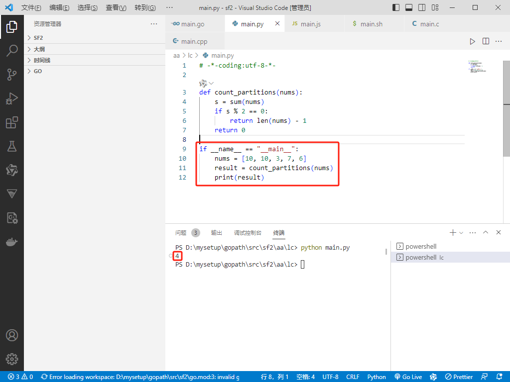

Python完整代码如下:
# -*-coding:utf-8-*-
def count_partitions(nums):
s = sum(nums)
if s % 2 == 0:
return 0
if __name__ == "__main__":
nums = [10, 10, 3, 7, 6]
result = count_partitions(nums)
print(result)
