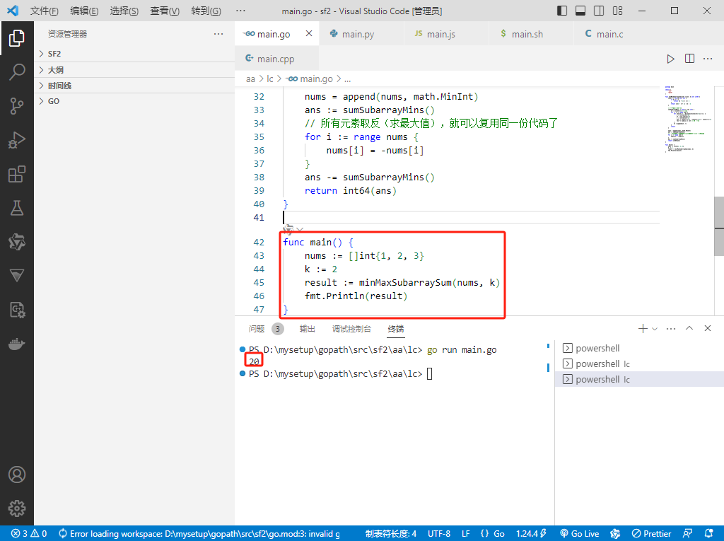

Go完整代码如下:
package main
import (
	"fmt"
	"math"
func minMaxSubarraySum(nums []int, k int) int64 {
	count := func(m int) int {
		if m <= k {
			return (m + 1) * m / 2
		return (m*2 - k + 1) * k / 2
	// 计算最小值的贡献
	sumSubarrayMins := func() (res int) {
		st := []int{-1} // 哨兵
		for r, x := range nums {
			for len(st) > 1 && nums[st[len(st)-1]] >= x {
				i := st[len(st)-1]
				st = st[:len(st)-1]
				l := st[len(st)-1]
				cnt := count(r-l-1) - count(i-l-1) - count(r-i-1)
				res += nums[i] * cnt // 累加贡献
			st = append(st, r)
		return
	nums = append(nums, math.MinInt)
	ans := sumSubarrayMins()
	// 所有元素取反(求最大值),就可以复用同一份代码了
	for i := range nums {
		nums[i] = -nums[i]
	ans -= sumSubarrayMins()
	return int64(ans)
func main() {
	nums := []int{1, 2, 3}
	k := 2
	result := minMaxSubarraySum(nums, k)
	fmt.Println(result)

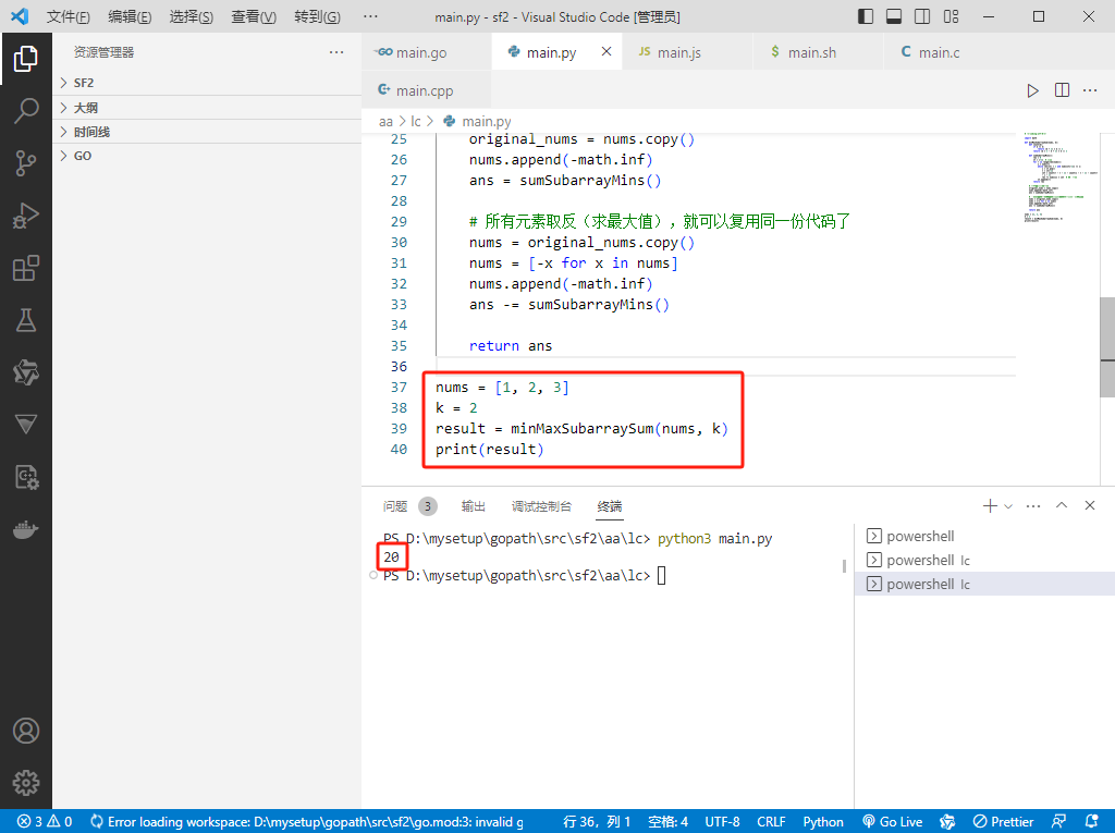

Python完整代码如下:
# -*-coding:utf-8-*-
import math
def minMaxSubarraySum(nums, k):
    def count(m):
        if m <= k:
            return (m + 1) * m // 2
        return (m * 2 - k + 1) * k // 2
    def sumSubarrayMins():
        res = 0
        st = [-1]  # 哨兵
        for r in range(len(nums)):
            x = nums[r]
            while len(st) > 1 and nums[st[-1]] >= x:
                i = st.pop()
                l = st[-1]
                cnt = count(r - l - 1) - count(i - l - 1) - count(r - i - 1)
                res += nums[i] * cnt  # 累加贡献
            st.append(r)
        return res
    # 计算最小值的贡献
    original_nums = nums.copy()
    nums.append(-math.inf)
    ans = sumSubarrayMins()
    # 所有元素取反(求最大值),就可以复用同一份代码了
    nums = original_nums.copy()
    nums = [-x for x in nums]
    return ans
nums = [1, 2, 3]
k = 2
result = minMaxSubarraySum(nums, k)
print(result)
