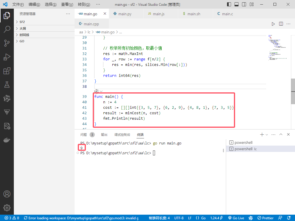

Go完整代码如下:
package main
import (
"fmt"
"math"
"slices"
func minCost(n int, cost [][]int) int64 {
f := make([][3][3]int, n/2+1)
for i, row := range cost[:n/2] {
row2 := cost[n-1-i]
for preJ := range 3 {
for preK := range 3 {
res := math.MaxInt
for j, c1 := range row {
if j == preJ {
continue
for k, c2 := range row2 {
if k != preK && k != j {
res = min(res, f[i][j][k]+c1+c2)
f[i+1][preJ][preK] = res
// 枚举所有初始颜色,取最小值
res := math.MaxInt
for _, row := range f[n/2] {
res = min(res, slices.Min(row[:]))
return int64(res)
func main() {
n := 4
cost := [][]int{{3, 5, 7}, {6, 2, 9}, {4, 8, 1}, {7, 3, 5}}
result := minCost(n, cost)
fmt.Println(result)

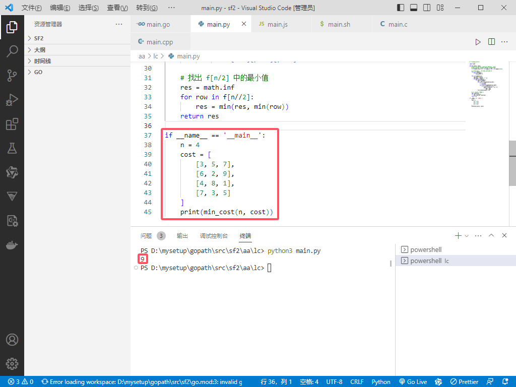

Python完整代码如下:
# -*-coding:utf-8-*-
import math
def min_cost(n, cost):
# f[i][j][k] 表示涂第i组(对称位置的两间房)时,
# 左边房屋颜色为 j,右边房屋颜色为 k 的最小花费
f = [[[math.inf]*3 for _ in range(3)] for _ in range(n//2+1)]
# 初始化 f[0],第一组前没有房屋,花费为0
for j in range(3):
for k in range(3):
f[0][j][k] = 0
for i in range(n//2):
row_left = cost[i]
row_right = cost[n - 1 - i]
for preJ in range(3):
for preK in range(3):
res = math.inf
for j, c1 in enumerate(row_left):
if j == preJ:
continue
for k, c2 in enumerate(row_right):
if k != preK and k != j:
cand = f[i][j][k] + c1 + c2
if cand < res:
res = cand
# 找出 f[n/2] 中的最小值
res = math.inf
for row in f[n//2]:
res = min(res, min(row))
return res
if __name__ == '__main__':
n = 4
cost = [
[3, 5, 7],
[6, 2, 9],
[4, 8, 1],
[7, 3, 5]
print(min_cost(n, cost))
