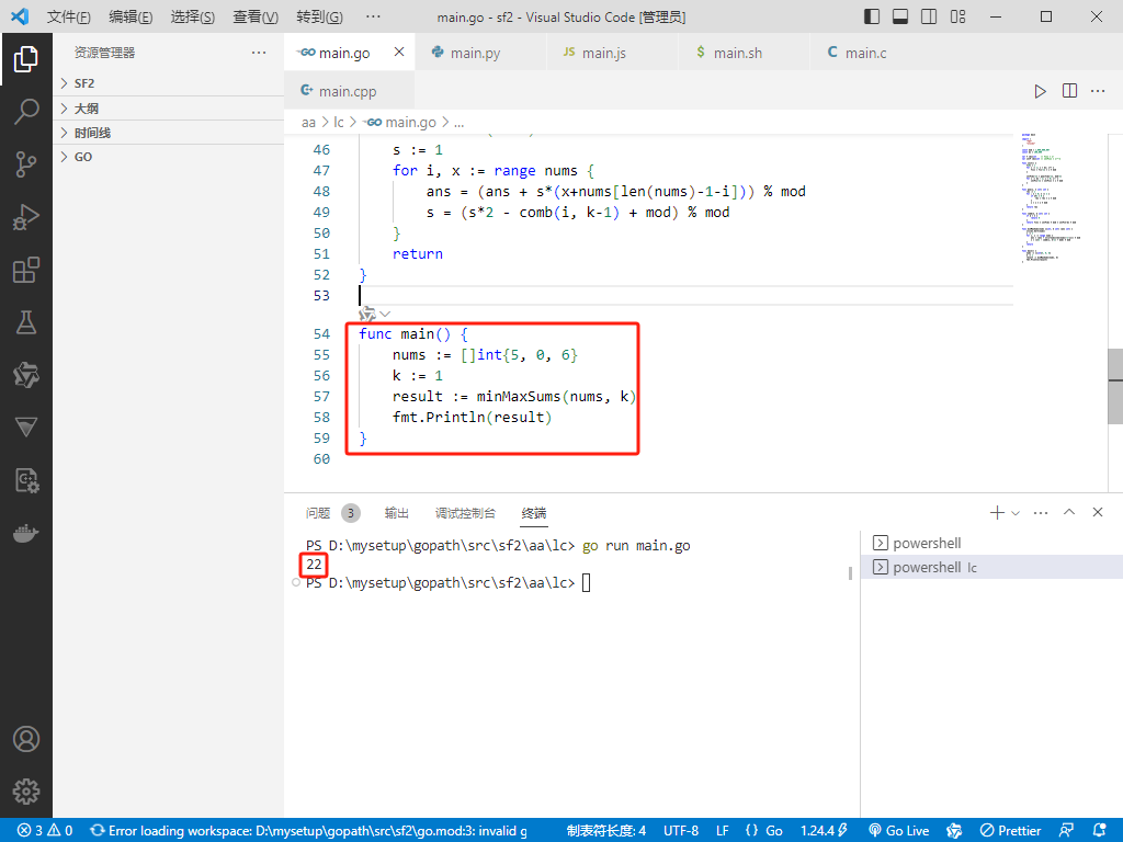

Go完整代码如下:
package main
import (
	"fmt"
	"slices"
const mod = 1_000_000_007
const mx = 100_000
var f [mx]int    // f[i] = i!
var invF [mx]int // invF[i] = i!^-1
func init() {
	f[0] = 1
	for i := 1; i < mx; i++ {
		f[i] = f[i-1] * i % mod
	invF[mx-1] = pow(f[mx-1], mod-2)
	for i := mx - 1; i > 0; i-- {
		invF[i-1] = invF[i] * i % mod
func pow(x, n int) int {
	res := 1
	for ; n > 0; n /= 2 {
		if n%2 > 0 {
			res = res * x % mod
		x = x * x % mod
	return res
func comb(n, m int) int {
	if m > n {
		return 0
	return f[n] * invF[m] % mod * invF[n-m] % mod
func minMaxSums(nums []int, k int) (ans int) {
	slices.Sort(nums)
	s := 1
	for i, x := range nums {
		ans = (ans + s*(x+nums[len(nums)-1-i])) % mod
		s = (s*2 - comb(i, k-1) + mod) % mod
	return
func main() {
	nums := []int{5, 0, 6}
	k := 1
	result := minMaxSums(nums, k)
	fmt.Println(result)

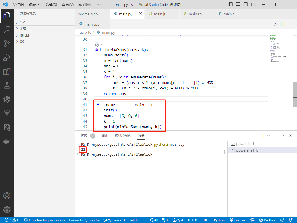

Python完整代码如下:
# -*-coding:utf-8-*-
MOD = 10**9 + 7
MX = 100_000
# 预处理阶乘和逆元
f = [1] * MX
invF = [1] * MX
def pow_mod(x, n):
    res = 1
    while n > 0:
        if n & 1:
            res = res * x % MOD
        x = x * x % MOD
        n >>= 1
    return res
def init():
    for i in range(1, MX):
        f[i] = f[i-1] * i % MOD
    invF[MX-1] = pow_mod(f[MX-1], MOD-2)
    for i in range(MX-1, 0, -1):
        invF[i-1] = invF[i] * i % MOD
def comb(n, m):
    if m > n or m < 0:
        return 0
    return f[n] * invF[m] % MOD * invF[n-m] % MOD
def minMaxSums(nums, k):
    nums.sort()
    n = len(nums)
    ans = 0
    s = 1
    for i, x in enumerate(nums):
        ans = (ans + s * (x + nums[n - 1 - i])) % MOD
        s = (s * 2 - comb(i, k-1) + MOD) % MOD
    return ans
if __name__ == "__main__":
    init()
    nums = [5, 0, 6]
    k = 1
    print(minMaxSums(nums, k))
