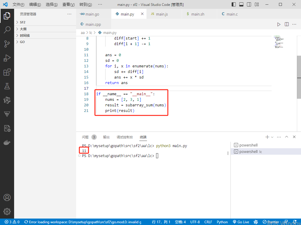

Python完整代码如下:
# -*-coding:utf-8-*-
def subarray_sum(nums):
n = len(nums)
diff = [0] * (n + 1)
for i, num in enumerate(nums):
start = max(i - num, 0)
diff[start] += 1
diff[i + 1] -= 1
ans = 0
sd = 0
for i, x in enumerate(nums):
sd += diff[i]
ans += x * sd
return ans
if __name__ == "__main__":
nums = [2, 3, 1]
result = subarray_sum(nums)
print(result)
